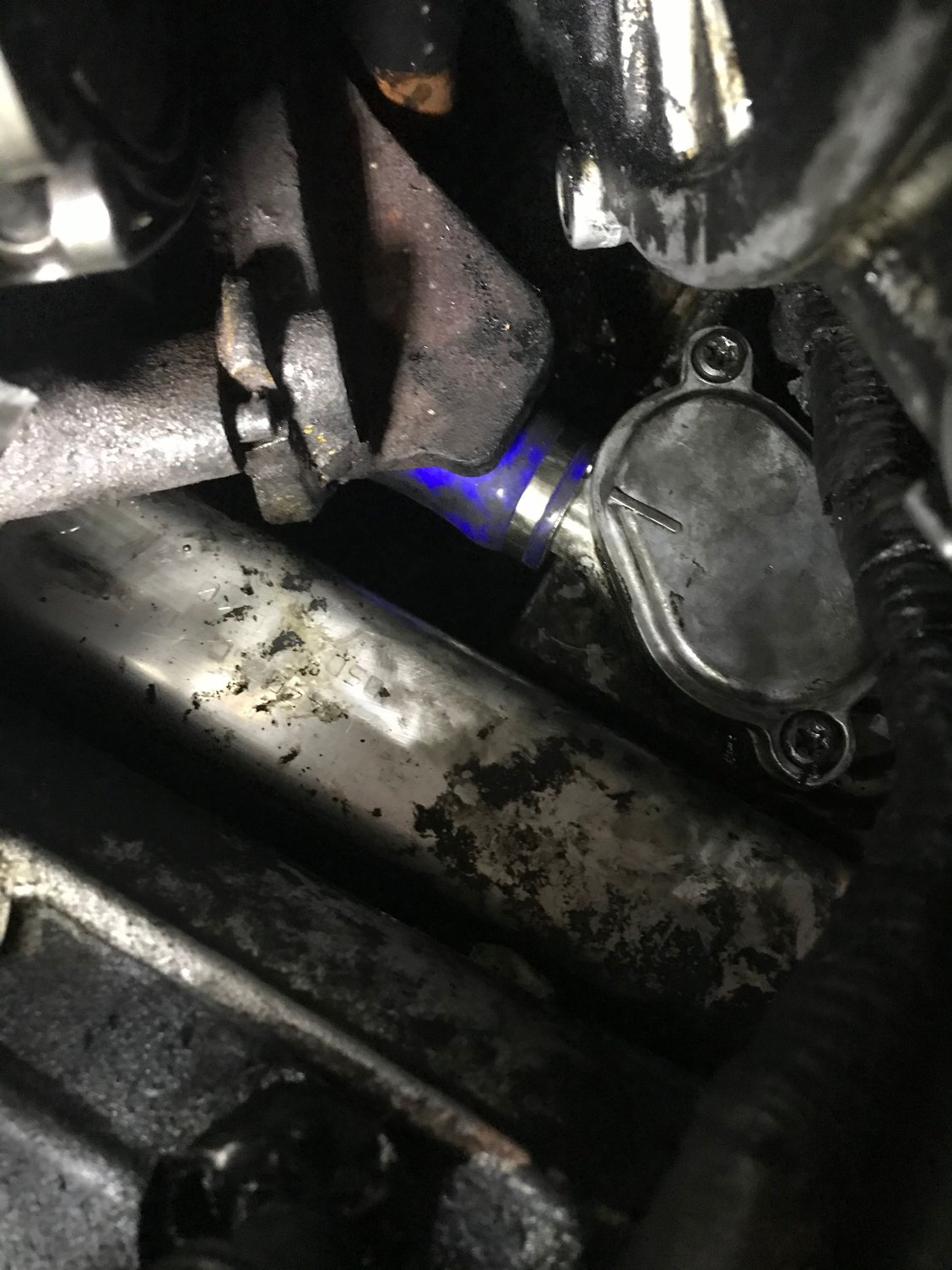

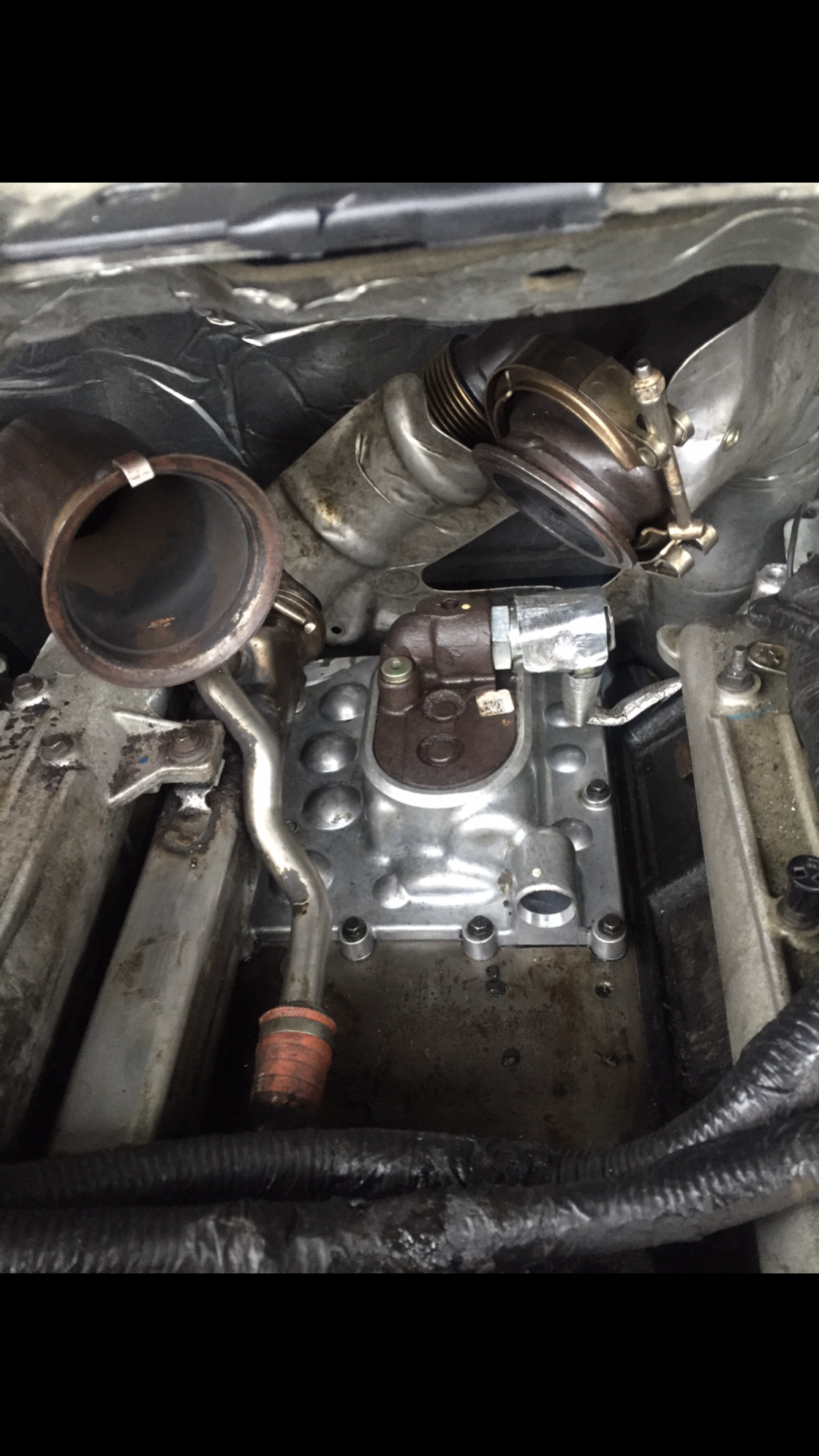

FrankNBeans's Avatar

This is the tube from the oil cooler to the EGR cooler. The blue tube is the upgraded one
This is the original orange tube. You might have the original orange tube since you have a 2003 Ex. I put UV dye in my coolant and noticed some dye at this hose. I changed it last Sunday so I have t seen a loss of coolant, yet

I was losing coolant but only when the engine was at operating temperature or hot. Cold on my driveway it wouldn’t leak coolant. But, any coolant that leaked out of the EGR tube would evaporate while the engine was still hot. I could only see evidence of a leak up there with the dye in the coolant. Even though you have the blue EGR hose they are still able to fail. Some just put a 3/4” ID heater hose and some hose clamps. The blue EGR hose only has O rings on each end to make the seal and they simply slide on the EGR “J” pipe and oil cooler fitting. Not a permanent tight seal in my opinion. Check out Fix Ur 6 web site. They make a CNC aluminum oil cooler fitting that allows you to back flush the oil cooler that permanently stays on the oil cooler. The fitting I used needs to be installed and removed after each oil cooler rack flush. It’s a pain to get the fitting on and off. I’m probably going to get the one you install and leave it there. You mentioned you have a remote oil cooler so it’s probably not necessary for your application
