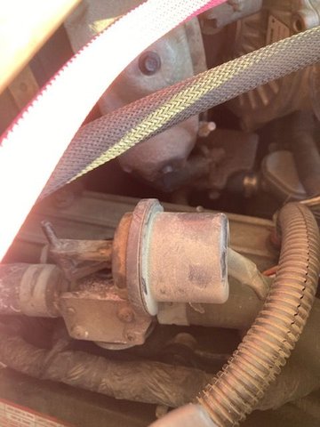

Part ID?
Hi all - I have coolant leaking from this thing, and I’d like to replace it but I don’t know what it’s called. Help!

That's the heater valve. It shuts of water to the heater core under certain operating conditions, usually MAX A/C.

You have to buy the whole heater hose from Ford to get that part.

Thank you - ordering now
