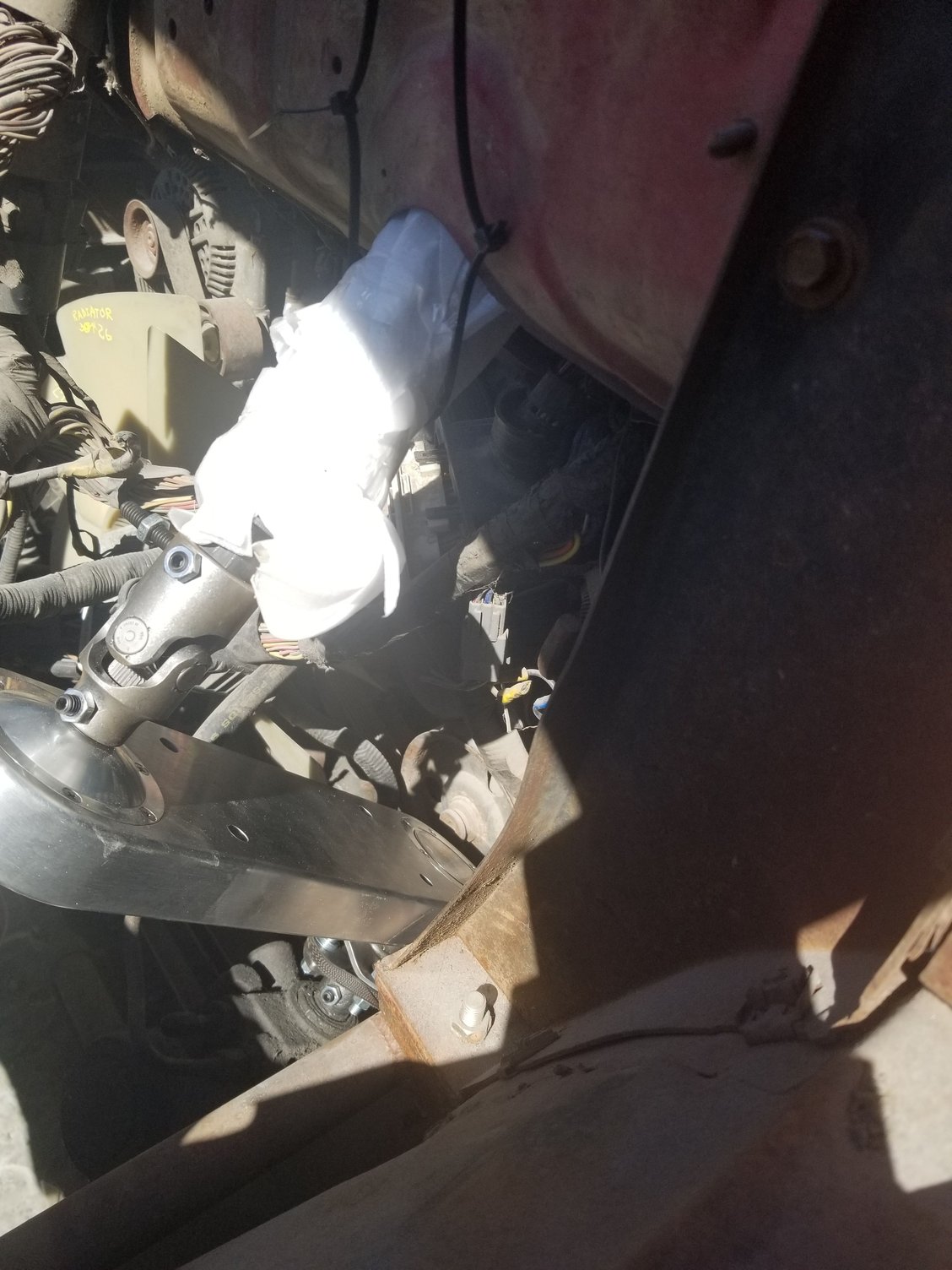

On a positive note...my previous challenge with setting up the steering has been solved. The issue previously was that positioning of the steering box on this E550 is positioned such that the only good angle to have a steering column in and connect up was a very unappealing 90 degrees to the floor.
A very nice solution proves to be an offset steering adapter called a *SteerClear* made by Wizard Fabrication. I was feeling quite triumphant having installed the rag joint, and u joint to the SteerClear and this new steering column and having it all fit so magically so the column is in the same position as the original was for any 1955 truck
Now I just need to deal with the afore mentioned steering wheel and figuring out how to connect up the transmission (E4OD) shifter linkage to this on the new shinny steering column's on the column shifter lever.

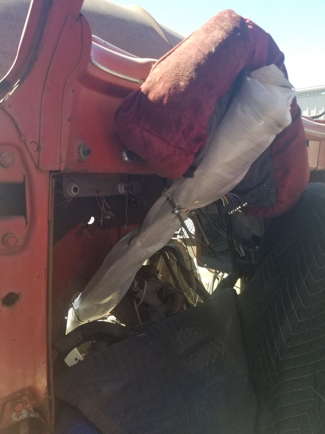

new still wrapped in its shipping protective packaging steering column fits where the original did.

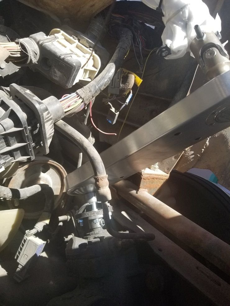

SteerClear offset steering box fixture lines up the stock E550 steering box so the stock 1955 steering column position can work nicely
A support bracket placed under the SteerClear to the frame still needs to be done. But this set up nicely solved the troublesome angle of the dangle.
