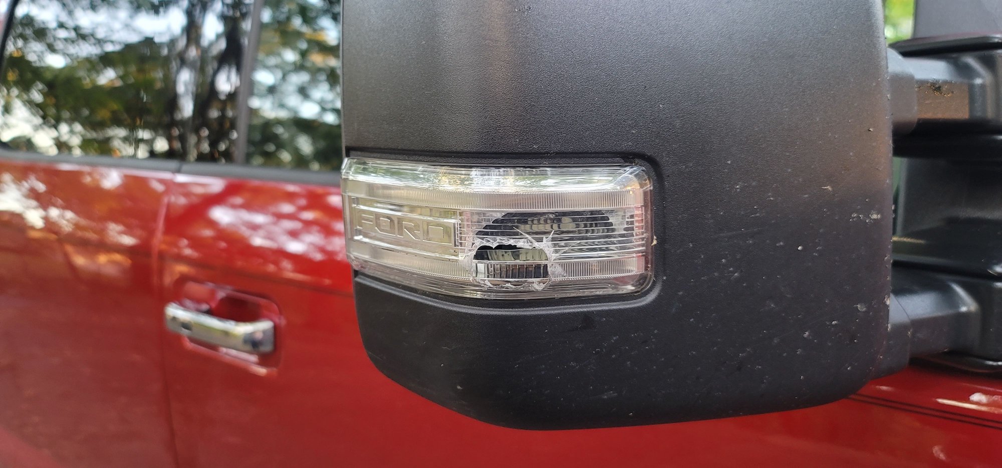

LED indicator lense on mirror
Must have been a rock.
Anyone know if this can be replaced without having to do the whole assembly?

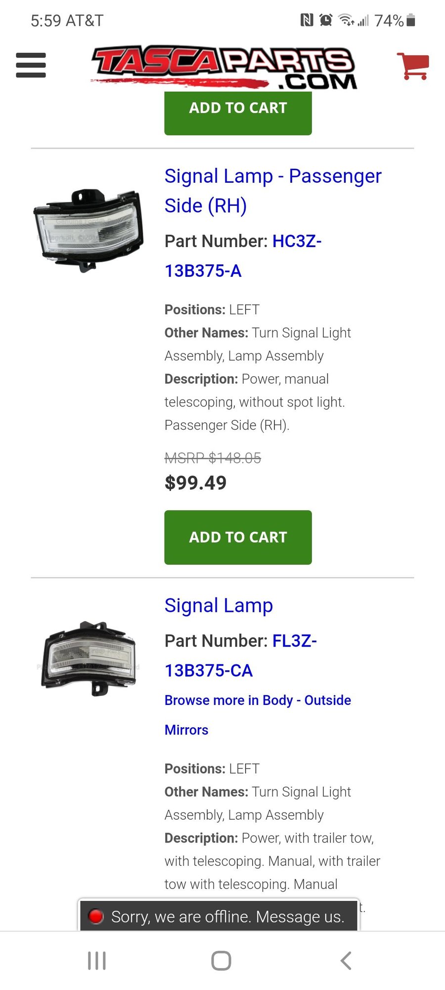

Tascaparts lists them as a separate piece.
