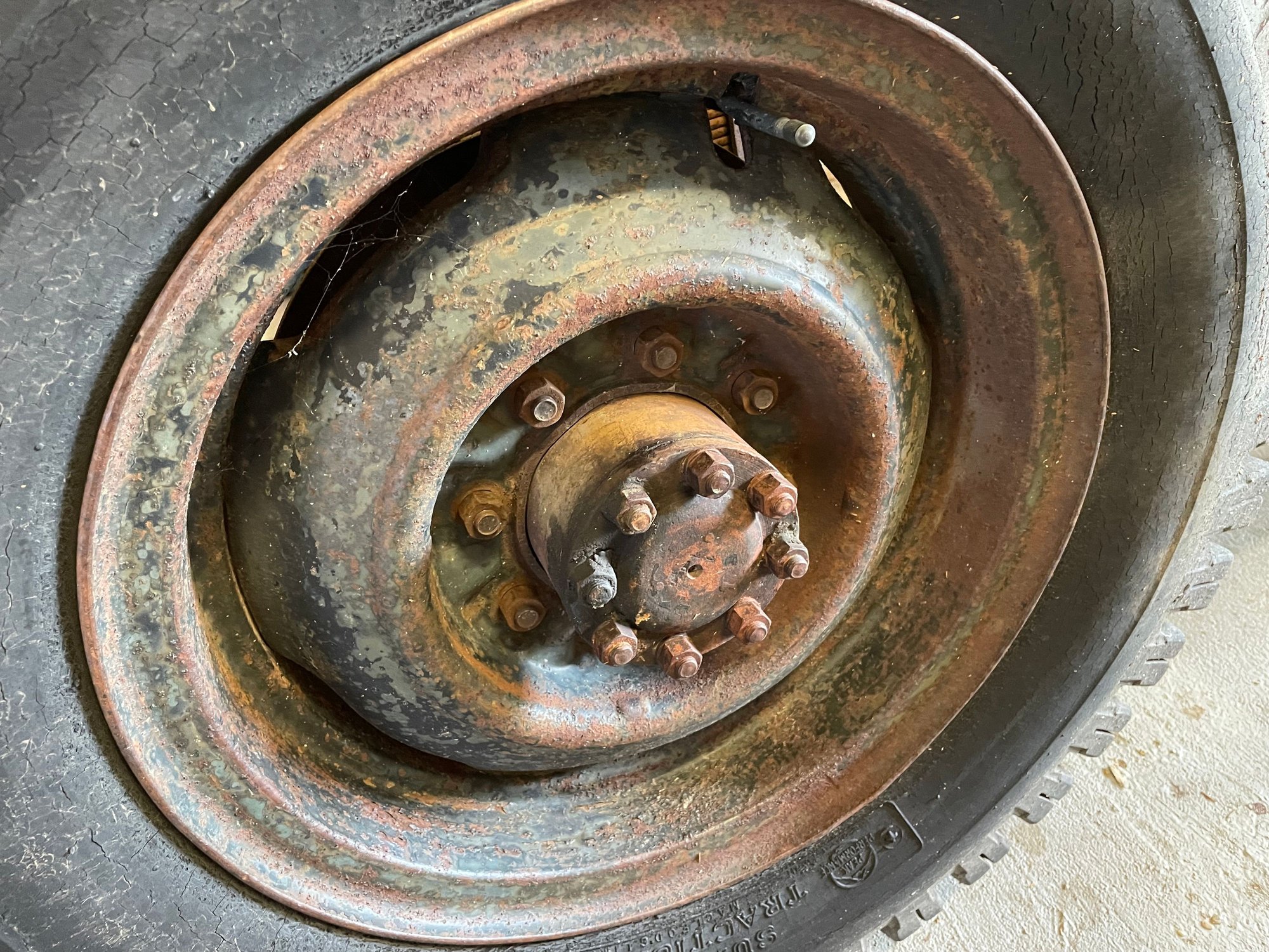

Thx for info I guess it comes down whether to keep the 8 bolt wheels or convert to 5 bolt. Can anyone advise on the rims 2nd pic, I read that the stock f2 rims are window makers but they don’t look like them to me, I thought WMs were the ones with split ring 1st pic

F-2 rims are 16” with one piece drop center rims. Can’t tell from the second pic if that is a 17” widow maker or one piece 16” F-2 wheel. The first pic is a locking ring two piece that is not the bad widow maker style. Has a Goodyear split ring design and is very serviceable. Stu

The wheel in the first picture looks like a more modern wheel than what came on the truck and won't accept the stock hubcaps.
What do you want to do with the truck? If you want to keep it stock stay with the eight bolt pattern wheels. If you want to modify it without changing the stock appearance you can get a kit to adapt disc brakes in the front and swap out the rear axle with a pre-73 F-250 axle with higher gears.

The 3 rims which is the 2nd pic are 17s the odd one in pic 2 is a 16”

Originally Posted by Sulker69
The 3 rims which is the 2nd pic are 17s……
Widow maker Firestone RH-5° type. Stu

Thx guys, I took the wheels off last night and they are the dreaded WW. Wrapped some chain around them and pulled the valves, I’m guessing someone must have swapped these for the original f2 16s at some point or maybe up here in Canada they came with the 17 WWs. So, based on Stu’s comment pre 2014 econoline 250/350 rims will fit. Will they fit over the rear drums and will the dogdish caps fit on them?

Yeah, that changes everything. 17" wheels were spec'd for the F3/68. The 3 you have are likely original and the one was replaced with the lock ring style. I'm not sure if the later model drop center 16" wheels will fit over your big brakes. Hopefully Stu will come back with answers. For sure if you do use the later wheels, the stock center caps won't fit. The stock caps require the "innie" nubs like on your original wheels and Ford stopped using those in the mid 60's.

Ouch. It’s an F-68, and like Wayne said that changes everything. You have 14” Lockheed rear brakes that a 16” wheel won’t clear. Before I rattle off the swap options, which will be an involved discussion, if you are thinking of an axle swap this might be your easier option. Stu
