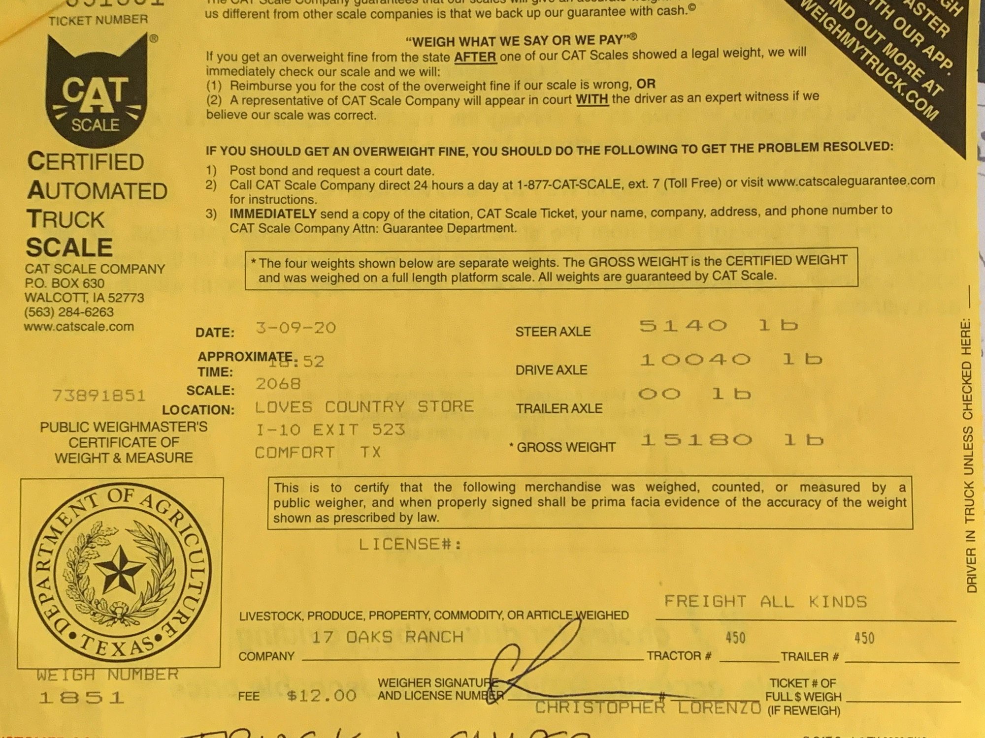

Lets talk Truck camper weights: There are 4 weights that are involved.
1 Base weight. This reflects the raw net weight of the TC without options
2 As built. This is the weight when you took delivery, it includes everything you optioned on it
3 Wet weight. This is the weight with all the tanks full usually at 80%
4 Rough n ready, full fu manchu locked n loaded travel weight. I also call it CAT scale weight, meaning you weight it when your travel. CAT scale is going to tell you the Gross weight + weight on the front axle + weight on the rear axle. This will tell you how muck psi to run in your tires. My weights are 3955 Base weight, 4372 as sold to me optioned. I forgot my Wet weight, but easy, tanks capacity x 80% x 8 lb per gal. My full fu manchu travel weight with tanks is 5990 lbs. Yes, this varies its a weekend trip it's 4 cans of beans if its a 2 trip is 14 cans of beans... starting to smell the coffee? In asking around the TC community, you find full travel load chases about 800--1200 lbs +/-.
I don't think you will sag or drag, but if you do then get a set of stableloads, they will solve the issue and do it properly. I know a LOT and I mean a LOT of people run out and buy, what might be the number 1 selling suspension mod in the RV world...Air Bags. I know many folks buy them before they take delivery of their truck even. I am NO FAN and rarely recommend them and here is why. Most people think air bags solve the problem of sagging. Well, they do but it comes at a STEEP price. First, you have added a modification that affects the suspension as it was designed. Air bags are not organic to the suspension, they are an external device that in fact interferes with the geometry and the performance of the well-designed suspension.
HOW? Look at an Air Bag installed. The bottom of the bag is directly over the rear axle, the top contacts the FRAME. Add psi and what happens? The Frame is lifted and bringing the lower spring pac with it, load weight is being transfers to the front axle group and the angle mass on the rear axle has gone from verticle to rearward angle. None of this is in compliance with the organic suspension geometry.
If you need to fix your sag get Stableloads. They are an organic component to the suspension and they work!
Yes, I have run air bags and I employed them to laterally level my TC, that when tanks were full it leaned to the right and lateral leveling is where they shine. It also only takes a few lbs of psi to level out.
Why do many 18 wheelers run them, do they suffer the same issues. THey run them to absorb the road inputs and give a smoother ride to the box. BIg trucks have very little vertical suspension movement due to the weight they carry you do not have the truckload moving too much, so they use ver short many leaves spring. pacs
Take away is CAT scale while on a trip to ensure you get a good idea of how much you carry and how much is on that rear axle. Pull into any big truck stop, drive onto the CAT scale ramp and put your front wheels ahead of the last line and the rears witll auto be in the right zone, get out, push button and give them the number of your truck (ANY number will do), they ask if its a re-weigh and you say no, drive off go in pay about $12.50 get your paperwork.
Get the PSI/Weight chart for your tire and adjust it to the chart.
Your TC should have a sticker like this when you get it
This is a PSI/Weight chart my tires are circled
Truck, front axle, rear axle with TC loaded not in travel mode, TC when I bought it and no water or load

Fortunately, the scales in Oregon are free. We weigh regularly, and have a similar tire chart to choose the pressures we want.
I’m not an airbag fan either, for lots of reasons, not the least of which is that we use our rig in the winter a lot. The water can damage them unless you make the system even more complex to dry them.
The camper manufacturer recommends Stableloads. In addition to squat, we want off-road performance. We’ll just have to see how it performs and adjust from there.
Thanks!
Lots of good advice listed in the above posts. Personally, I'm on the side of getting your pickup, putting the camper on it and going for a couple of voyages before deciding what mods to throw at it. I can't visualize your setup being heavy enough to require much, if any, mods.
Bags are for some and not for others. I have found them advantageous.
For what it is worth, I've had bags on a truck used for livestock and hay, and my pickups. Put the first set on in the 70's for use on a farm and ranch truck. Currently have them on a stock truck (livestock) the 96 F250 and the 2011 F350DRW. My sister has them on her 2015 F350SRW.
We have never, ever had a water or freezing problem with any of them. Actually, this is the first I've heard of that. I've been in Oregon all my life and have traveled from one corner of the state to the other. Been across / forded rivers and creeks that definitely gave them more of a bath than driving on a wet road. Just got back from a hunting trip on the rim of Joseph Canyon between Enterprise and Lewiston with snow and ice and an elk hunting trip in the Coast Range, which I live at the base of. We've been to the Mexican border in Texas and the Canadian border in Montana and N. Dakota. We'll be heading to the Coast in a couple of weeks and Naval Air Station Whidbey Island for Christmas.
All of this to say that we have never experienced any problems with water or ice damage to the air bags or the air bag system. It's one thing I just don't worry about or even take into consideration.
