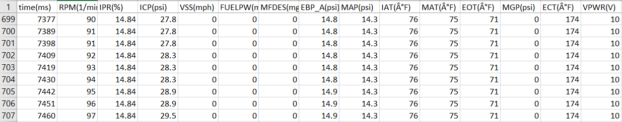

Well I'm going to jump on the cold start band wagon here. I've determined from other threads and replies to my own posts in other threads that my 7.3 is in overall good health. Great to hear that I don't have much to worry about, but I do have a cold start annoyance I'd like to figure out.
Let me start out by saying that I don't know what is normal for these trucks. So if I drive the truck today and go out to start it tomorrow or the next day, I won't have a problem. If it let it sit for 4 days or more it takes a bit more effort to get going, I've let it sit for 2 weeks and it was about the same as the 4+ day starting.
Rather than trying to describe what is happening I'll link to a video I took last time. In this video it sat for about 7 days since last started. I was moving a little slow cranking because I was attempting to data log the start on my laptop. I forgot to save the first crank and start, but a log of the second crank and start are attached.
I apologize for the radio, it didn't dawn on me to turn it off until after I got the log set-up.
The gauges and data log are all the gauges I have at the moment. I haven't gotten a fuel pressure gauge hooked up yet.

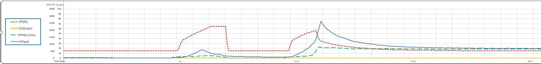

Here is a graph of your relevant data...my first take is weak batteries or a weak starter...would appear to me that after the 15.4 s mark your glow plugs cycled off and your batteries had enough juice to spin the starter fast enough to finally build the required ICP to start...

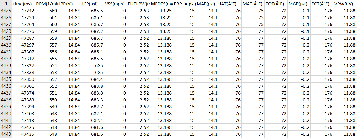

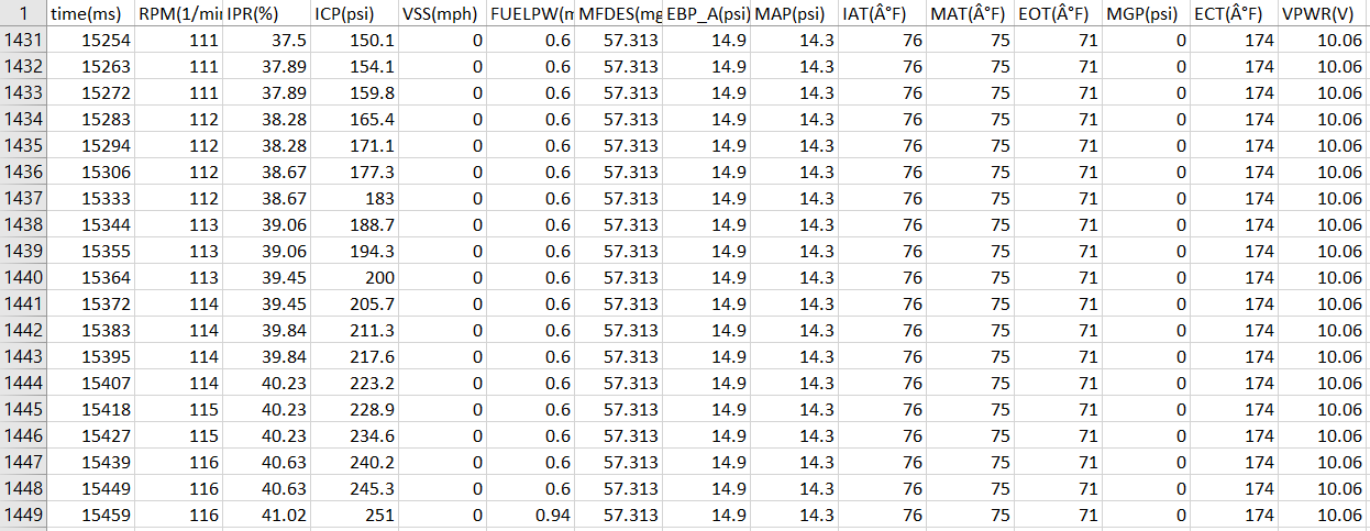

During your first start attempt, as the RPM starts to ramp up your DC voltage (VPWR) dips down to 10v. This is below the minimum voltage required and stated by Ford in the service manual.
This is the highest RPM point during the first start attempt at 182 RPM. As you can see, the VPWR is still quite low.
After the first stall event and you sat for a moment, the VPWR reaches 11.44v at the peak. Immediately following that peak measurement, you started cranking the engine over again and this is what happened.
The VPWR dips back down to nearly 10v like it was before.
Even after the truck starts and is running smooth, your VPWR is still quite low as seen below. This is the very end of your data log.
I believe Ford states 10.2v is the minimum starting voltage, but we always go by 10.5v just to give a bit of a cushion and no two trucks are the same after all of these years. So, it appears your GPR and GP's are working properly, but you may want to test them if some of the other courses of action do not resolve the issue. The LPOP would be my last suggestion, but battery terminals, main ground points, cable ohm/resistance testing, load testing, starter connections, etc would be first on my list. A new high torque gear reduction starter may be needed, I don't know at this point.

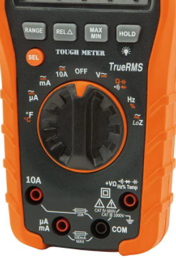

Fluke is very nice stuff, but Klein is nice stuff too. We had an entire assortment of Klein tools when I worked telecom outside plant. I still have some of those tools 25 years later and they still work great.
As for using the multimeter (MM) to check the integrity of the cables, that is really quite simple. Not as simple as checking the voltage, but that should be the first step, checking the voltage. It looks like your voltage setting is autodetect between AC and DC based on the image below.
With the batteries connected and in a resting state with or without the charger, you should see the same voltage reading from each battery down to the hundredths if possible. At least to the tenths position though. Once the truck is running in a cold and hot condition, you should see the same voltage reading down to the hundredths again. If so, this means that the two batteries truly are working as one battery as designed and intended.
If you want to go further and check for resistance in the wiring, you use the "ohms" setting which is the one just to the right of the voltage (V) setting. You should not have to swap the positive lead port as ohm and V utilize the same port which is the one to the top right of the common (black) port.
There are many videos out there on how to use the Klein MM700 if you feel like you want to watch them.
Going forward with an resistance test of the wiring, you want to establish a baseline and short the leads together which should result in a 0.1 result. If it says OL or something else, check your leads for connectivity.
As you go to testing the cables, you really want to have the battery side off the ground and test through the ground point like on the engine block, then again through the cable lugs only. Be sure to take notes along the way if you are anything like me as I get the numbers and results all screwed up. There are standards or guidelines of what a cable should read during a resistance test based on length and gauge (diameter).
There are "wire resistance calculators" and "ohm test charts" out there for you to use as a reference. The length of the cable does not need to be exact, just close. Frankly, if you are seeing very low resistance in the display from a cable, it is safe to assume that cable is good. The cables are not very long and are quite large gauge wire. You may want to test all of the positive and negative cables from and to the batteries, then the positive cable to the starter. It would be best to isolate the batteries from the circuits so that you don't cause a short to power and blow a fuse or fuseable link.

Can you ohm check a battery cable like this with a multimeter? I think these multimeters only use a very small current to test. Cable might be able to handle that small current no problem, but starting current might be a whole different story. I think I've got some reading and studying ahead of me.
Yes, you can use your home use MM to test the cable for resistance or lack there of. That is why I eluded to if you see anything other than the very lowest of readings, you may have an internal cable problem. May be the key word.
I believe your quick connect idea was talking about something like an Andersen quick connect. I have some for the front of our 5th wheel in order to quickly deploy a mobile 100w solar panel and PMW charge controller. No alligator clips or messing around with wires, literally plug and play. They have their use that is for sure, but not all uses are good for them.
Check the cable integrity and clean ALL of the major connection points for the main cables before buying anything. The back of the alternator, the engine grounds on both sides of the engine, the starter connections, etc... Go from there... That is free to do except for the time, then start spending some money if you don't see the results you like to see.
I agree that your batteries are probably due for replacement, but put some elbow grease in first. Either way, the refreshing of the connections will help you in the future if/when you need new batteries or starter.
