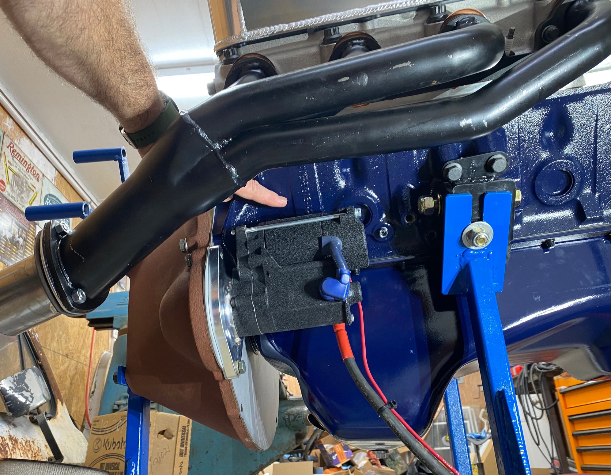

crawled under to look at brake line routing, have owned it less than 26 hours at this point--still getting to know the truck....
Found this tag on rear lower block (near #8). Doesn't seem linked to the VIN (which ends in 89918)--should it be?
Not sure what I'm looking at...

That could possibly be a rebuilder's tag.
It's not a factory tag.

X2 on I bet some shop that worked on it put that there. X3 does not look like a OEM tag. Also NOT a "buck" neither.
Since you say "Found this tag on rear lower block (near #8)." I bet some machine shop put it on there for some work they performed?

I agree. Rebuilder's tag. And you know it hasn't run hot since the rebuild, or the tag would have fallen off.
This is the most encouraging news now that I've opened up the proverbial box......
I have also heard of lead type "melt-away" tags for warranty claims, etc.
I appreciate the replies, even if I'm a little non-plussed right now about the engine likely having been rebuilt.
