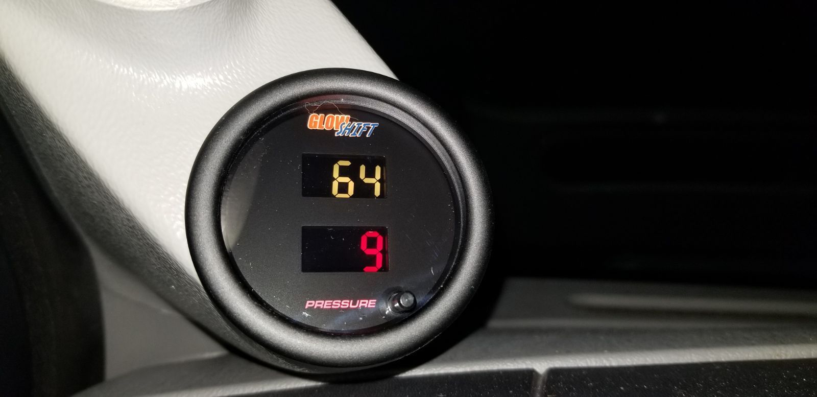

You can also mount it in an A-pillar mount. There are other makes out there but quality lowers with price in most cases. Personally I went cheap but never had a problem with the Glowshift. Mine was a dual readout, coolant (red) & fuel pressure (amber).

Reread my post. But fuel pressure at hot idle can be anywhere from 55-75. The real TEST is while driving at Wide Open Throttle WOT, it should never go below 45 psi.

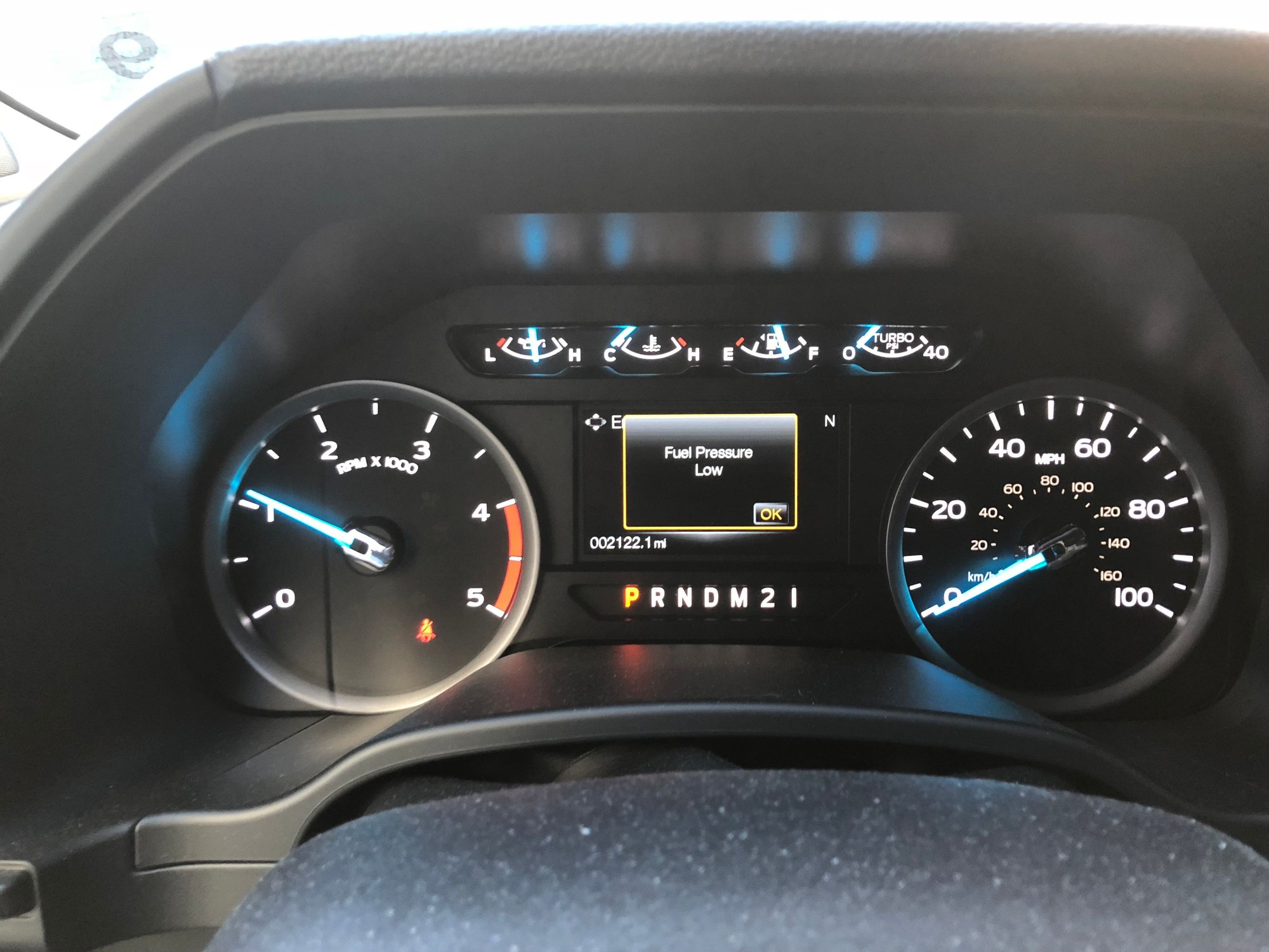

The modern common rail engines do it for you...low fuel pressure results in automatic reduced power mode. My 2017 F-250 had the fuel filter gel up at -21F; the sensors on the rails detected it, and the engine would only idle.

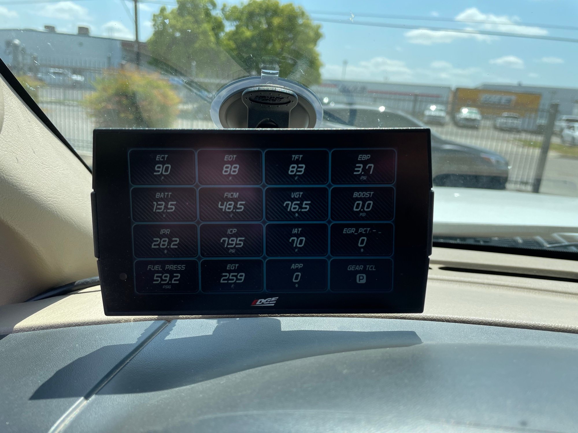

One option as well is get a fancy scanner like the Edge CTS and add a fuel pressure sensor. Then you can just watch it with everything else. I also set up alarms so I don't have to watch the gauge as much. I also added an EGT probe and am working on adding a coolant pressure sensor.
