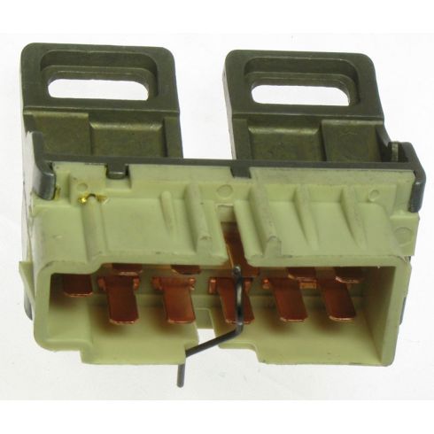

it sounds to me like the ignition switch is failing. what happens is with age they separate between the plastic and metal parts causing the issues you are seeing.
ignition switch is on top of the column, about above the brake pedal.
looks like this:

there is no need to remove the steering wheel to test or replace the switch. it is on top of the column, roughly above the brake pedal.
remove the two lower dash panels, remove the shift indicator from steering column if automatic, loosen the 4 nuts holding the steering column up, and drop the steering column down on the driver seat. then with a flashlight look between the column and dash and you will see the switch.
reach under the dash and feel it. you will know rite away if it is bad or not.
my bet is it will be separated between the metal and plastic parts.

Spot on man. I finally got a moment to look into this and 100% right. No steering wheel removal, drop the column (unhook the shifter), there it is, plastic splitting from the mount. You saved me a lot of time and effort, and probably money. Solid, and thank you.
