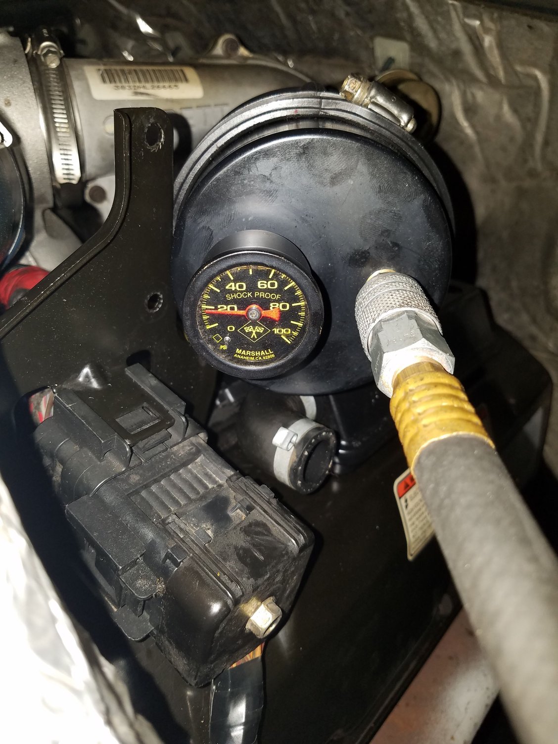

Check for boost leaks a couple of ways. On the exhaust side, carefully look for soot around both ends of the up pipes.
For the charge air side, you can build a boost leak checker like the one below, and slowly add at least 20psi of air pressure, soaping up CAC connections, plenums, and looking/listening for leaks. There will be some blowby from the CCV, but it will be a whisper.
