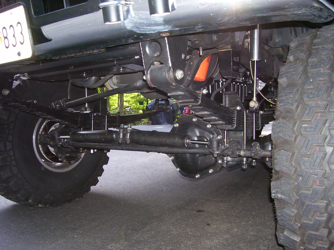

I found this on my phone
My has more bend in it then what you would probably need
It usually has weights hanging so it needs extra clearance

Ahh nice. If you could get some more pics of the actual bracket on the frame side and by the shock that would be much appreciated! Definitely gonna look into this!

The short panhard bar and it and the drag link being at an angle are your problems. Both bars need to be as long as possible to ease the arch that they travel in. I don't have a panhard and steer off of the pass side knuckle - king pin 60 - no BS at all,and a lot more lift.

Yes track bar & drag link would ideally be equal length, parallel, and pivot at the same points. Super stiff suspension could mask the issue but the way to solve it is have steering and axle move on the same arc together.

Any chance you have any pictures of the bracket you made for the frame side? getting ready to make a custom panhard and looking for ideas, thanks.

Shoot man sorry. Ive been busy with life stuffs. Heres some sketches of what I built
Weld to the frame.
Other end welds to the leaf spring plate
Use a bushing of your choice and make your brackets to fit.
