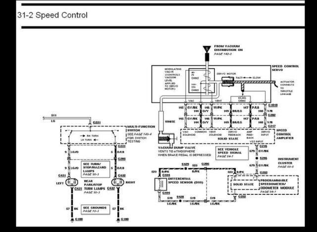

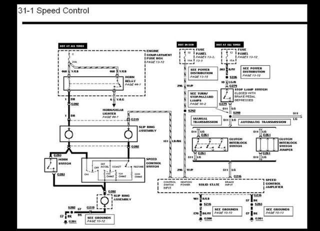

From the thread “92 f150 cruise control works intermittently” courtesy of rla:

This looks like something I can try. Can you tell me where you found the information? I would like to print it out and take it outside to my trunk.
I have tried to print ot but it's comminh out to small for my old eyes.
Thanks,
Jefferson150

What’s who found the information? If referring to my post, where I found it is in the post.
