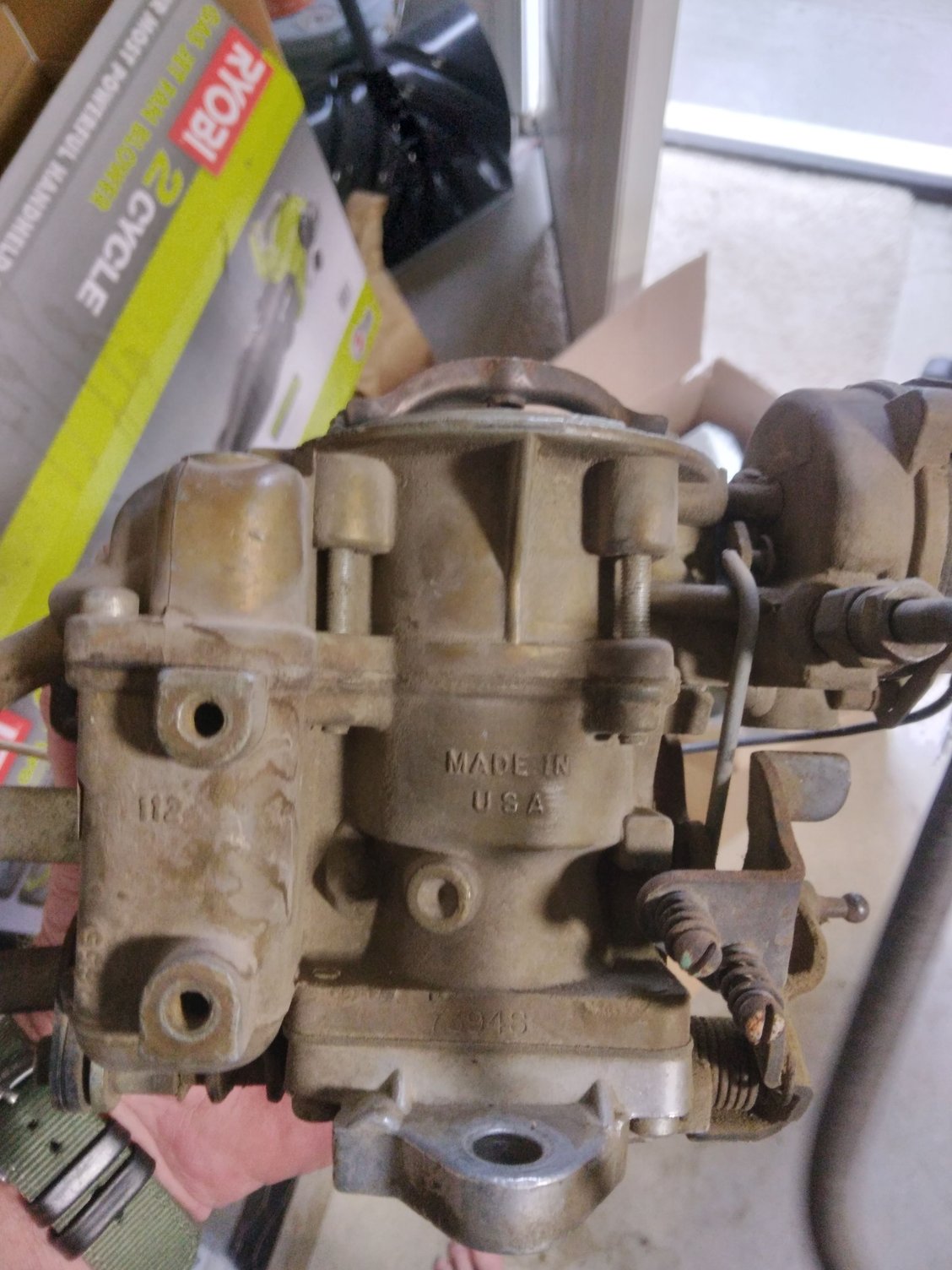

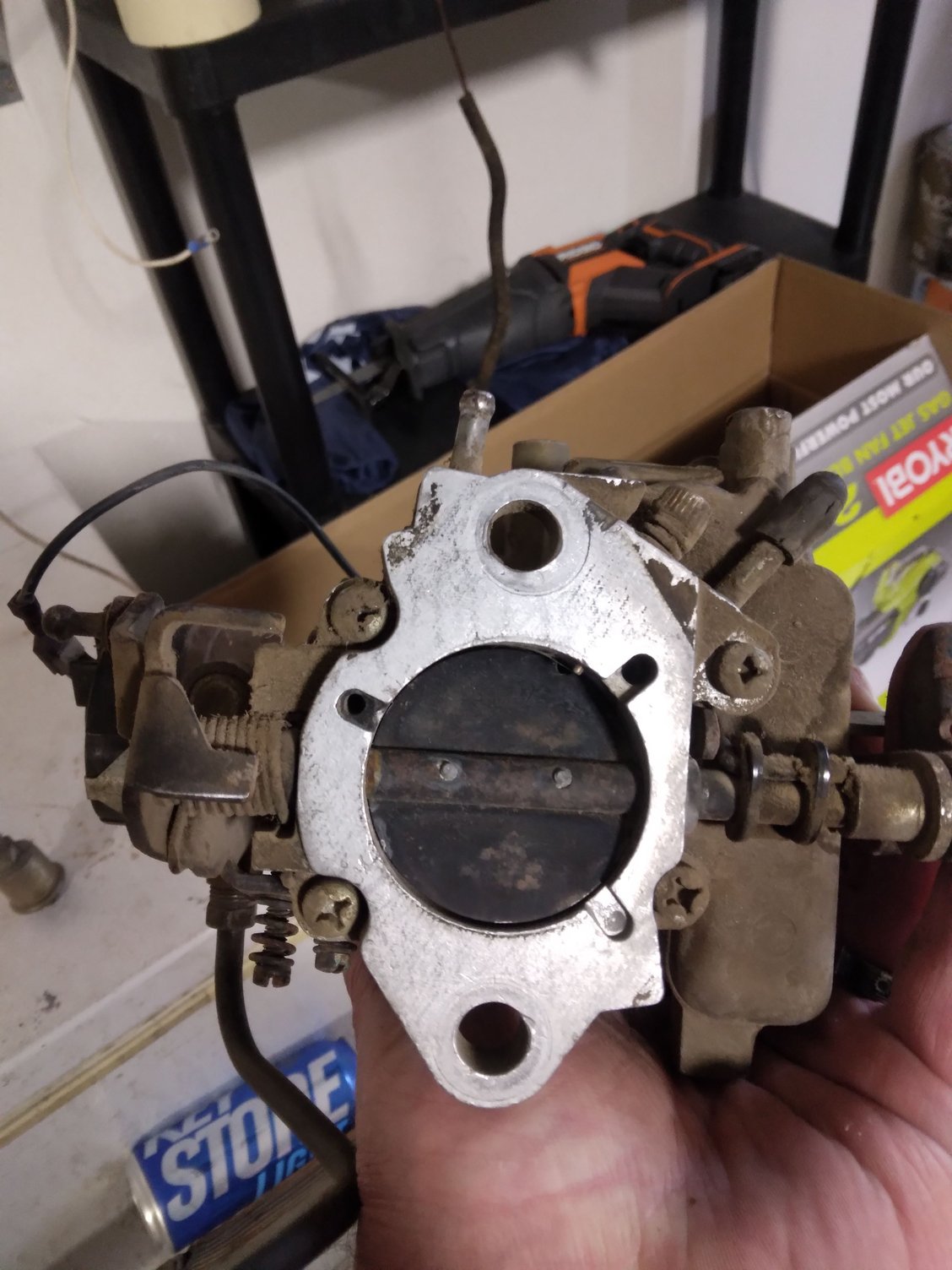

I was expecting confetti and balloons for being the millionth member asking a carburetor ID question...
no?
Okay.
I pulled this off of an 83 F150. Its a Carter, made in USA for Motorcraft. The stickers proclaim it was remanned by Holley and inspected by Larry L (thanks, Larry) in 2009. It's presumably a Carter YFA 1 bbl, but the rebuild kits (at NAPA) list part #s, mostly starting with an E or a D... l can't find anything on the carb to authenticate the part #s. Even if l get the right rebuild kit, there will no doubt be specific instructions to be followed for specific model #s which I'll need to follow (float level, throttle/choke adj., etc).
Any help here would be greatly appreciated. Here's a few pics...

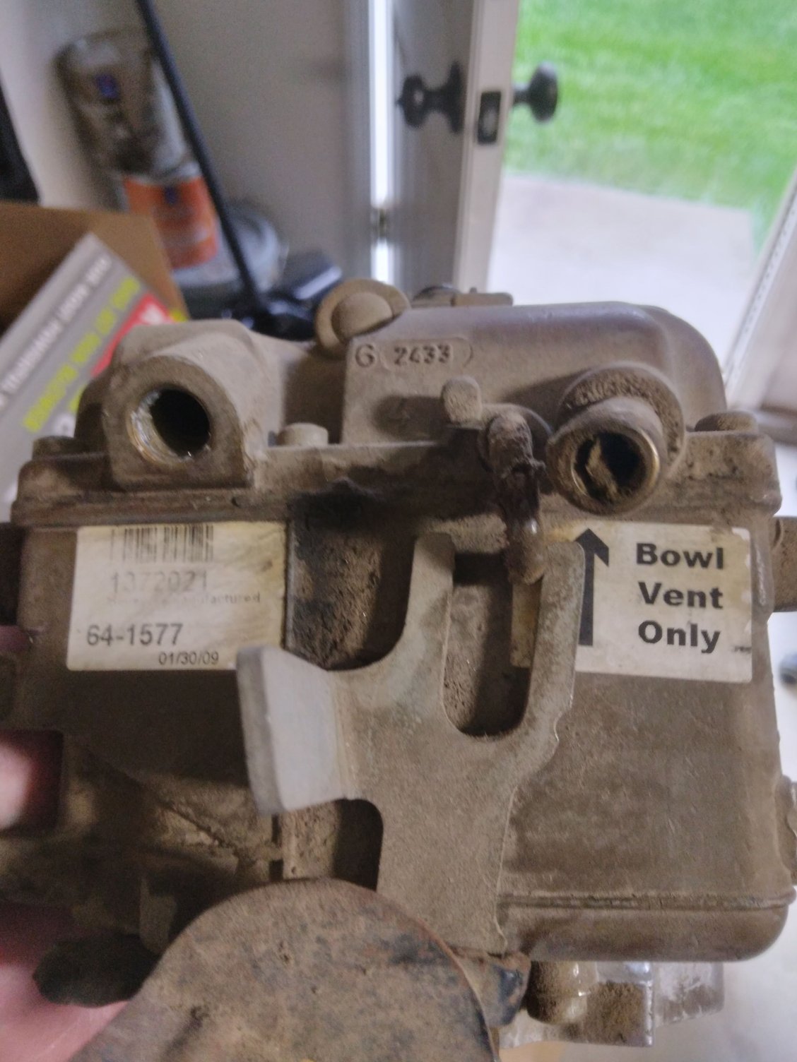

I smeared the "Remanufactured by Holley" printing on the left sticker... the numbers read: 1372021 and 64-1577... if that means anything to anyone. Larry L, are you here?

Carter YFA. model # 7394S.
https://www.carburetor-parts.com/yfa-k4317.html
