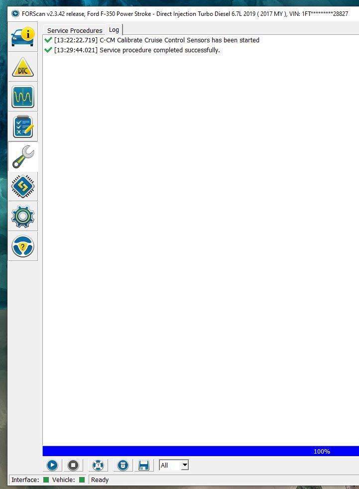

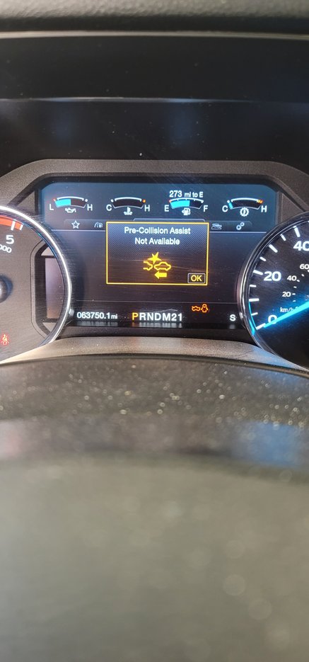

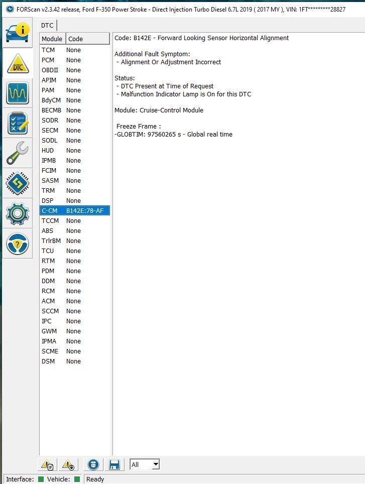

An Update and further information. I have had this issue a while. I am just getting back to it. and realized a couple things I should have mentioned...
  • I get an error when I turn Truck on. "Pre-Collision Alert" and on FordPass, 9on my phone it says "PRE-Collision assist not available"
  • Back story, New to me truck had a Ranch Hand bumper and ACC module relocated. ACC Worked FINE. Sold the Bumper and mounted the ACC Module back on an original bumper. ACC worked about a month. Quit working on a rainy day if that matters. to anyone.
  • I have been getting the error below since, and no Cruise
  • It has a new Harness that also plugs into the LED fog lights.
@B-ManFX4 when I unplug the module all together, the Cruise control "grays out" on the dash settings so I cant set it to normal or anything.
Plugged back in, Clearing the DTC's, when it rereads, the DTC is back. I ran the Calibration, and it said successful. (see pictures attached)
Any other suggestions, or do you think the module is bad?
OR, any suggestions on how to turn it completely off and use the normal cruise? assuming normal cruise is not in the ACC module???
Cleaning the module did not help...

Good job getting it turned off. Collision Avoidance is done through the RADAR unit so that it is not a surprise that the adaptive cruise didn't work. I was going to say that your FORSCAN error message regarding the alignment or adjustment is incorrect could be a clue. When you decide to work on it again park the truck on a level surface. Make sure the RADAR unit is level. Use a square held against the front of the module and a level on the square and adjust the mounting bolt in or out to get the module level. Run the calibration routine again.
