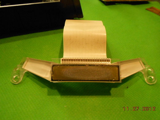

The display itself can be replaced without replacing the PSOM or speedometer head.
This will keep your mileage and setup.
Just take the display off of one from a salvage yard.
Attachment 279316
Photo courtesy of Eddiec1564.
Here is a link and you can go to the end of to view the photos in a PDF.
https://www.ford-trucks.com/forums/1...splay-fix.html

Odometer- Well, now I know what the hardest part of this job is, that's "Finding" a odo with a clear display. I've about worn out this old computer checking pull lots and every site I can think of, but no joy. I was hope'n someone out there could point me toward the best places to start to look for one. If yaw'll were looking for a psom/odo for a 1993 F150 xlt 5.0, what would your list look like ?
1-pull lots, 2-e-bay, 3-your best friends truck, etc: I thought maybe you guys with all the expertise have a special place you would look for one first. If not, that's no problem, I'll just keep on truck'n. Thanks, Adios , Trimtab.
This is what my display look like. just fyi

SubFord-- It took me a couple of weeks to find a PSOM with an ODO CLEAR display. I didn't remove the entire cluster. I went in from the front. Took off the shroud, Plastic and black shroud. Popped out the PSOM and removed the shifter controls from the PSOM, took out the burned up ODO. Inserted the clear ODO.
Pic's below. I ran for a couple of days before I buttoned it up. I unhooked the fuel selector switch so I could screw the switch onto the shroud, then I plugged the switch back in and installed the dash shroud. All done I thought...Try to start it and --- NO START. Now it had been starting and running great after I changed out the ODO. I did a lot of looking on the forums for tips, so I ck'ed the batt--OK, ck'ed fuel pump relay--OK, ck'ed selonoid--OK, Pulled the diode and put it back in, Put in a new fuel selector switch. and the dad-gum thing fired right up and has continued to fire and run great. I'm wondering if unplugging the fuel selector switch could have caused no start. Anyway, I want to thank you much for all your help along with the other responders. Adios, Trimtab
