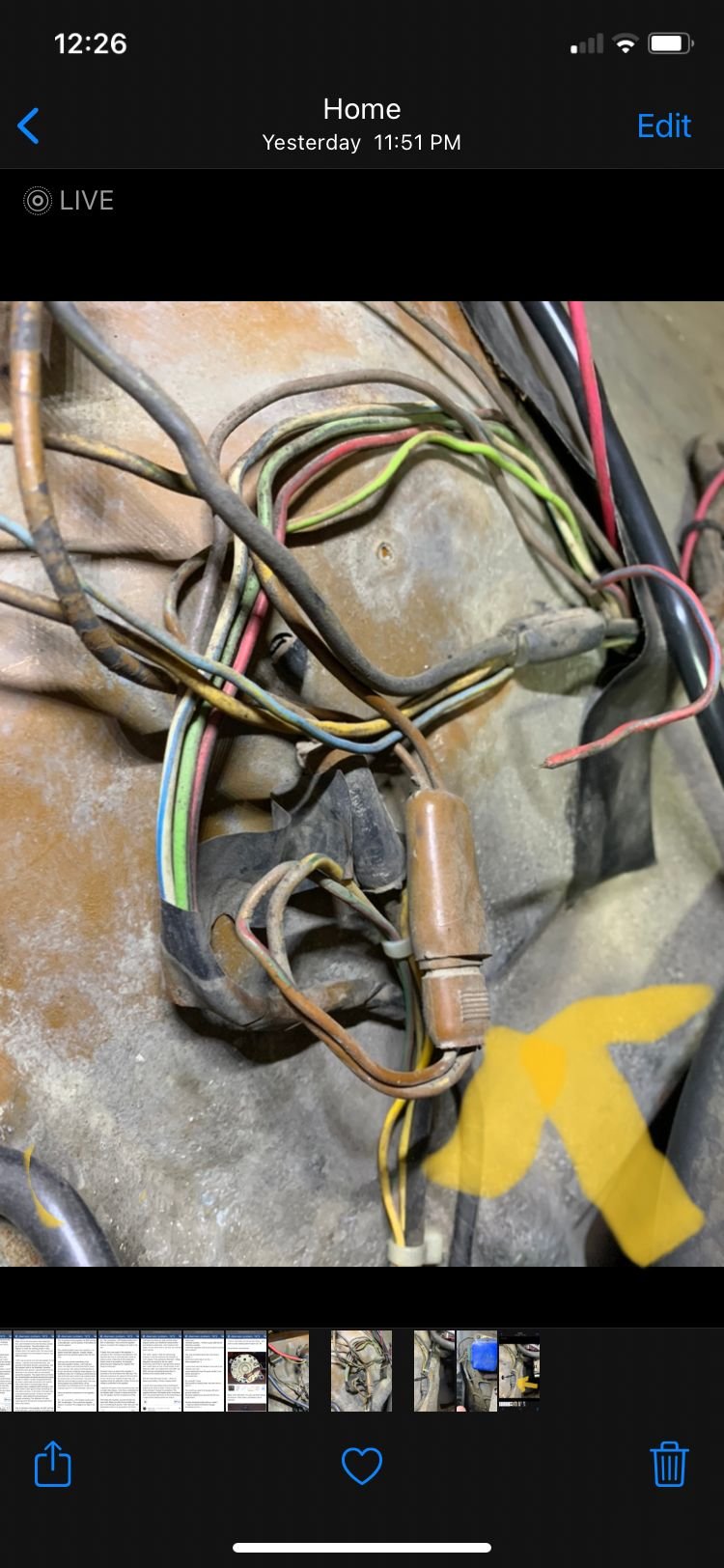

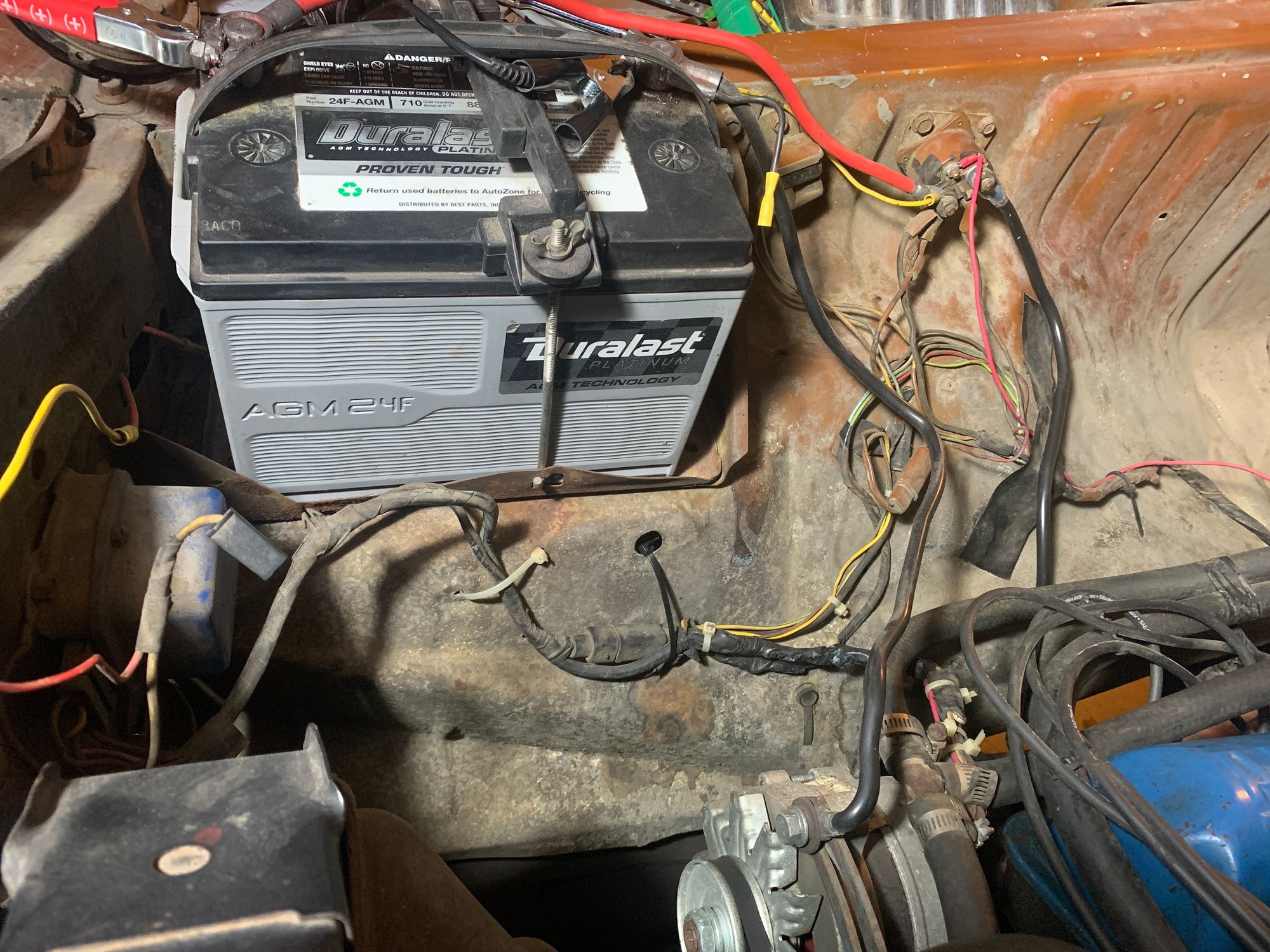

Beginning the process of proving that battery is not being charged, and finding and fixing the cause. Replaced alternator probably 5 years ago; do remember there were issues with using existing wiring harness with new alternator, like what wire went where and to what, why an alternator needed THAT many wires, etc. Have long suspected that alternator wasn’t charging battery, but because truck is project and hobby only and not a daily driver, haven’t gotten back around to deal with it til now. After doing a lot of work on different systems recently, I ran the truck 2 hours or so in a single day, and was lucky to get engine to start last 2-3 times (fits of slow turning over with pauses). Probably will start by replacing voltage regulator, but I’ve heard that the system often has a “fusible link” somewhere in the system; do these pictures show recognizable fuses or parts of the charging system that should be looked at? Appreciate it very much, thanks! Will get a picture of back of alternator in a day or two if that is helpful. Sorry for the tangle of wires…

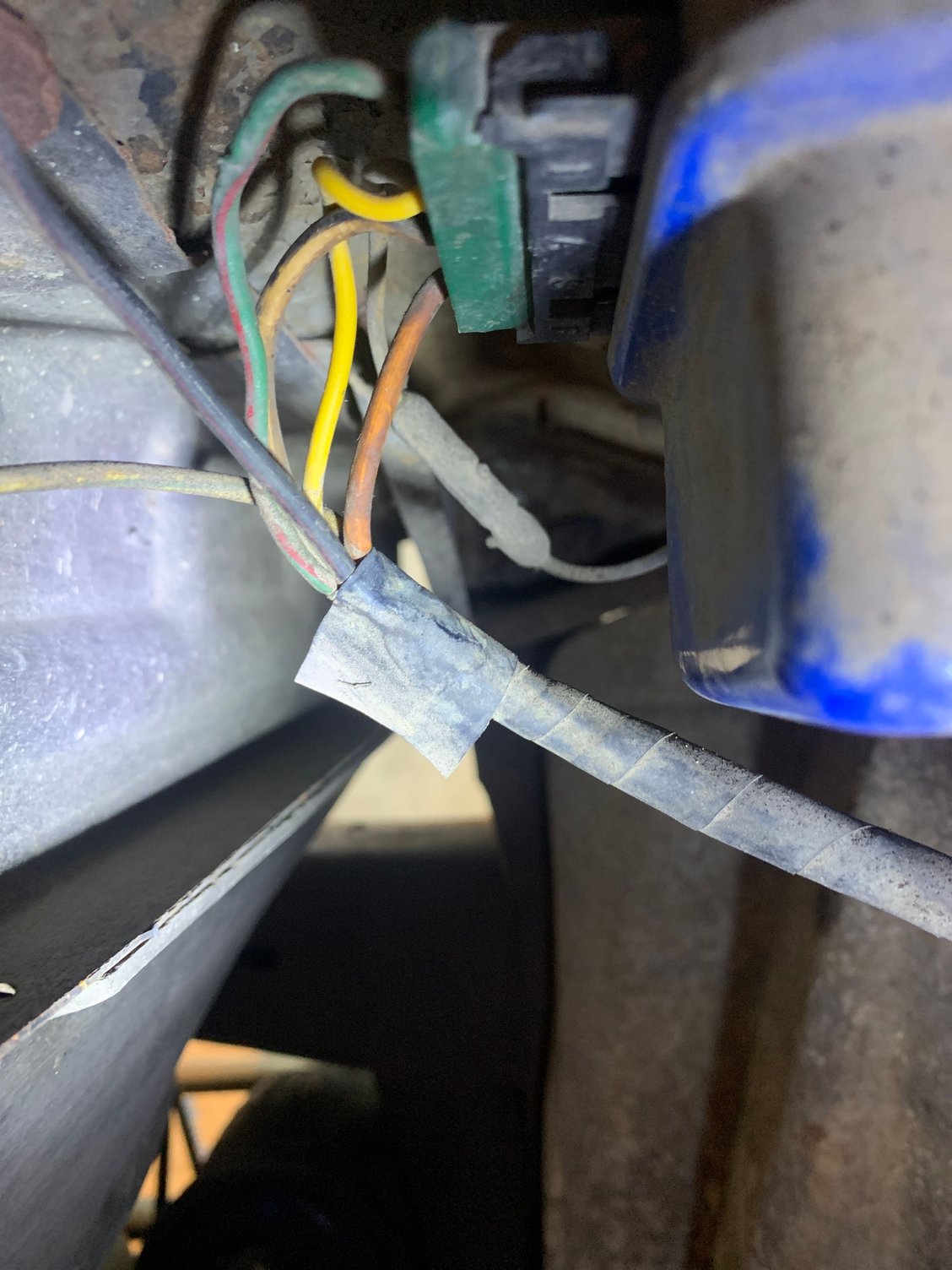

I went to one auto parts store that said you can’t test alternators while they’re on the vehicle, and another that said you could and that it was charging. The voltage regulator looks pretty modern, but the interference capacitor under it, and the wiring looks a thousand years old. Do you recognize any of the arrowed elements shown in the pictures?

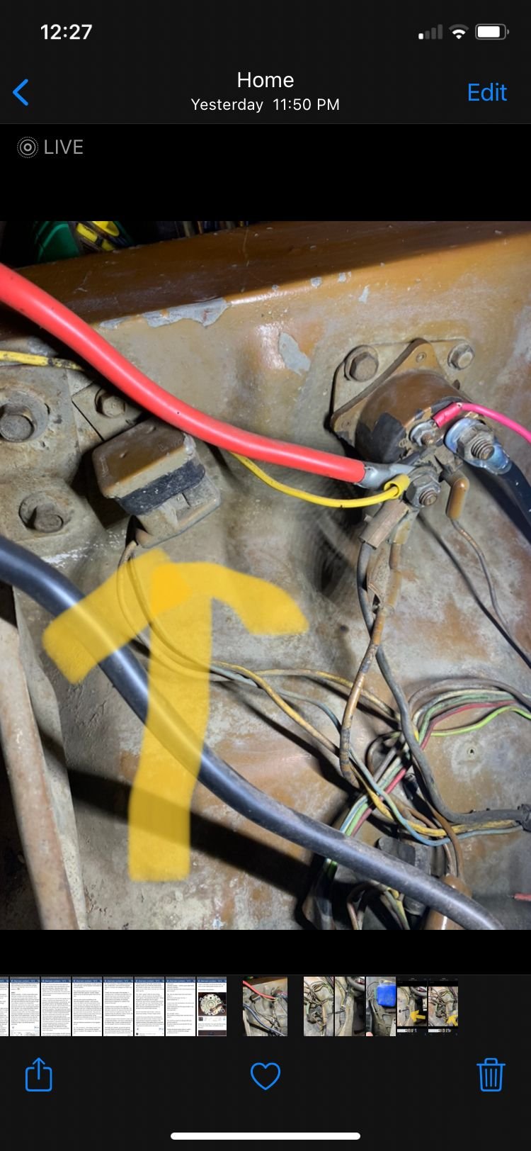

Particularly this. What is this thing?

That's the horn relay in post #6
