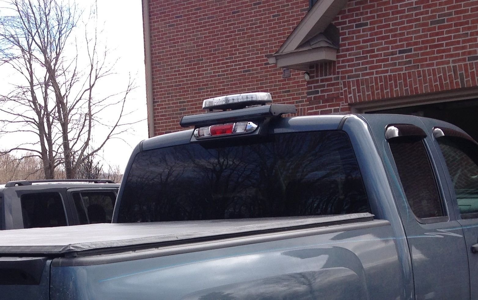

Acari makes an aluminum version that I've used on several trucks. It comes in raw, but can be painted to match.
Once everything is mounted, there is no chance of weakening magnets letting go at 80 mph and blowing the light off.
All wires are inside, and run through the interior of the roof.

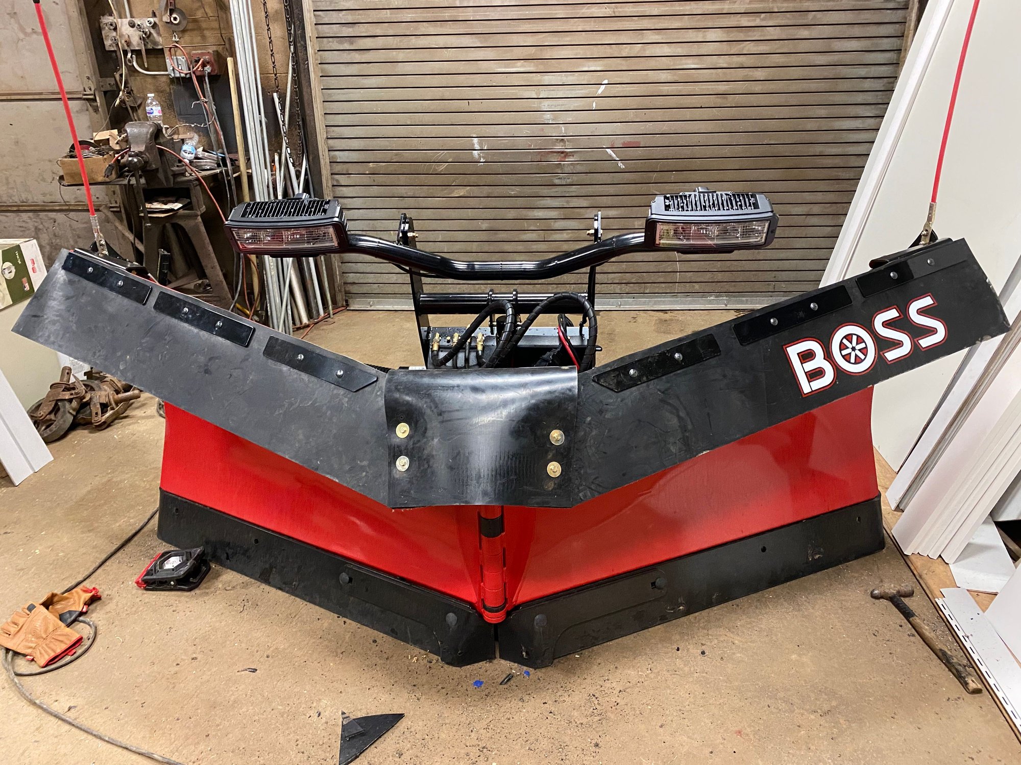

Looks great, I chose not to bolt down…. I take it off when not plowing. I have had magnet Whalen light up there for 6 years, never fell off except when I went thur car wash after a storm.
i have a 8’2” boss v plow with wings, been using boss for 6 years… just replaced truck with a 2022 F350, chose to stay with boss again. I put the snow deflector on this one, every time I would plow powder snow…. Snow coming up over the plow… I would say got to put a snow deflector on….

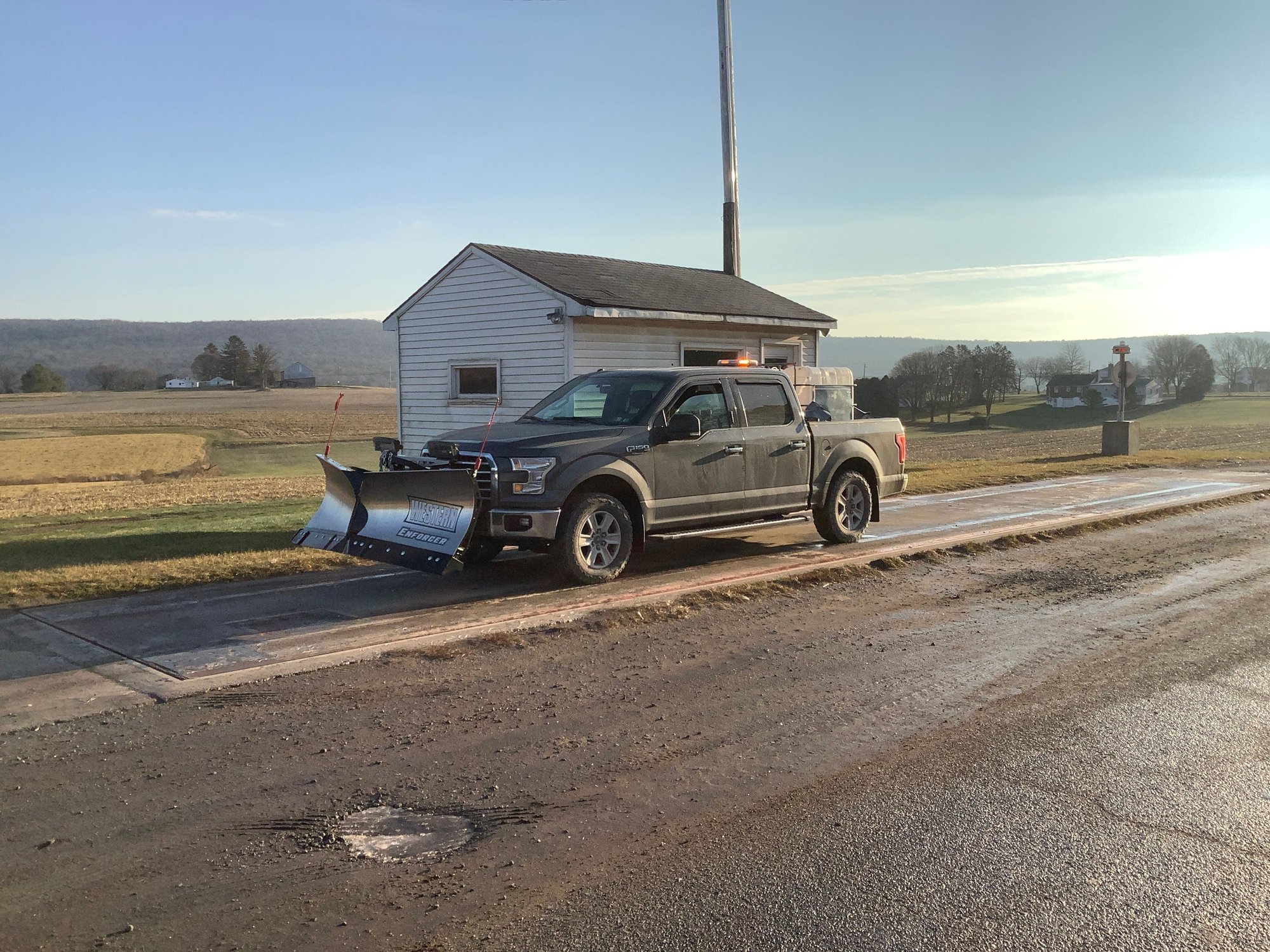

This is my plow rig, 2017 F150 XLT loaded, 6-speed with 5.0L Coyote, 1,910lbs ( off the top of my head ) payload with RoadMaster Active Suspension upgrade. 7.6' Western Enforcer stainless V-Plow with the LED light upgrade, curb guards and the "Fish-stick". Haven't had to use the plow yet, very mild winter so far in North-East Pennsylvania.
I'm using the Acari drill free mount to mount my STL ( Speed Tech Lights ) K-Force STL mini light bar. I like the Acari, I was skeptical at first, and still think they're a little over priced, but it's a fairly straightforward install and SUPER clean as far as looks go, it looks great, no wires showing etc. I was also worried about it leaking, but IF YOU'RE DILIGENT and make sure it's installed correctly, you're really shouldn't worry about it leaking, because the foam pieces provide a very tight seal once the mount is screwed down properly. We did have to alter the actually bracket pieces that go inside the cab and hold the mount to the cab, as they were too long and would not allow us to get the mount in all the way, thus leaving a gap in the foam pieces. Once we got that sorted out, the rest was a breeze and it turned out great.
Why I went with the Acari was due to the cost of a BackRack, it was going to be $500 to get the rack and the mounting hardware, then I'd still have the issue with wiring and getting it into the cab. I think anyone would be pleased with the Acari.
Fisher and Western are also the way to go in my opinion, though I'm a little biased since Fisher comes from Maine, my home state!
