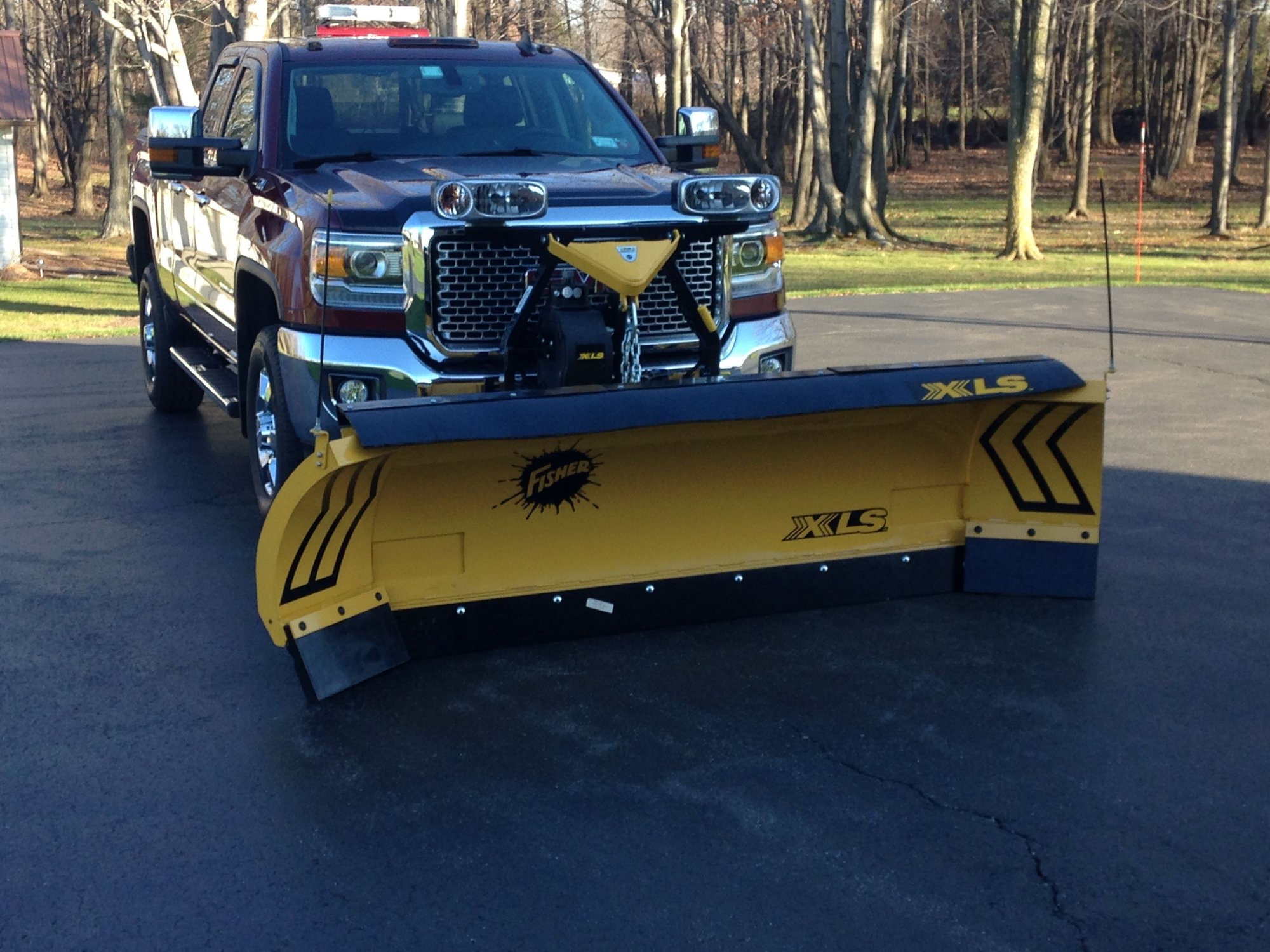

I run a Fisher 8-10 XLS.
Next one will be a Fisher Stainless 8 1/2-11 XLS.
