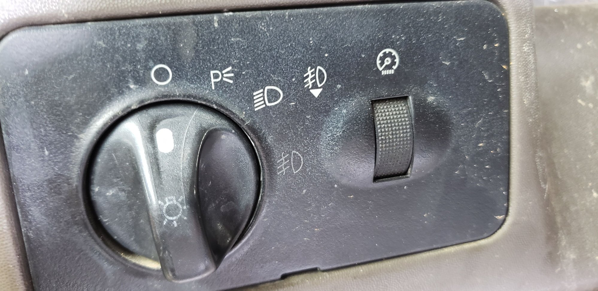

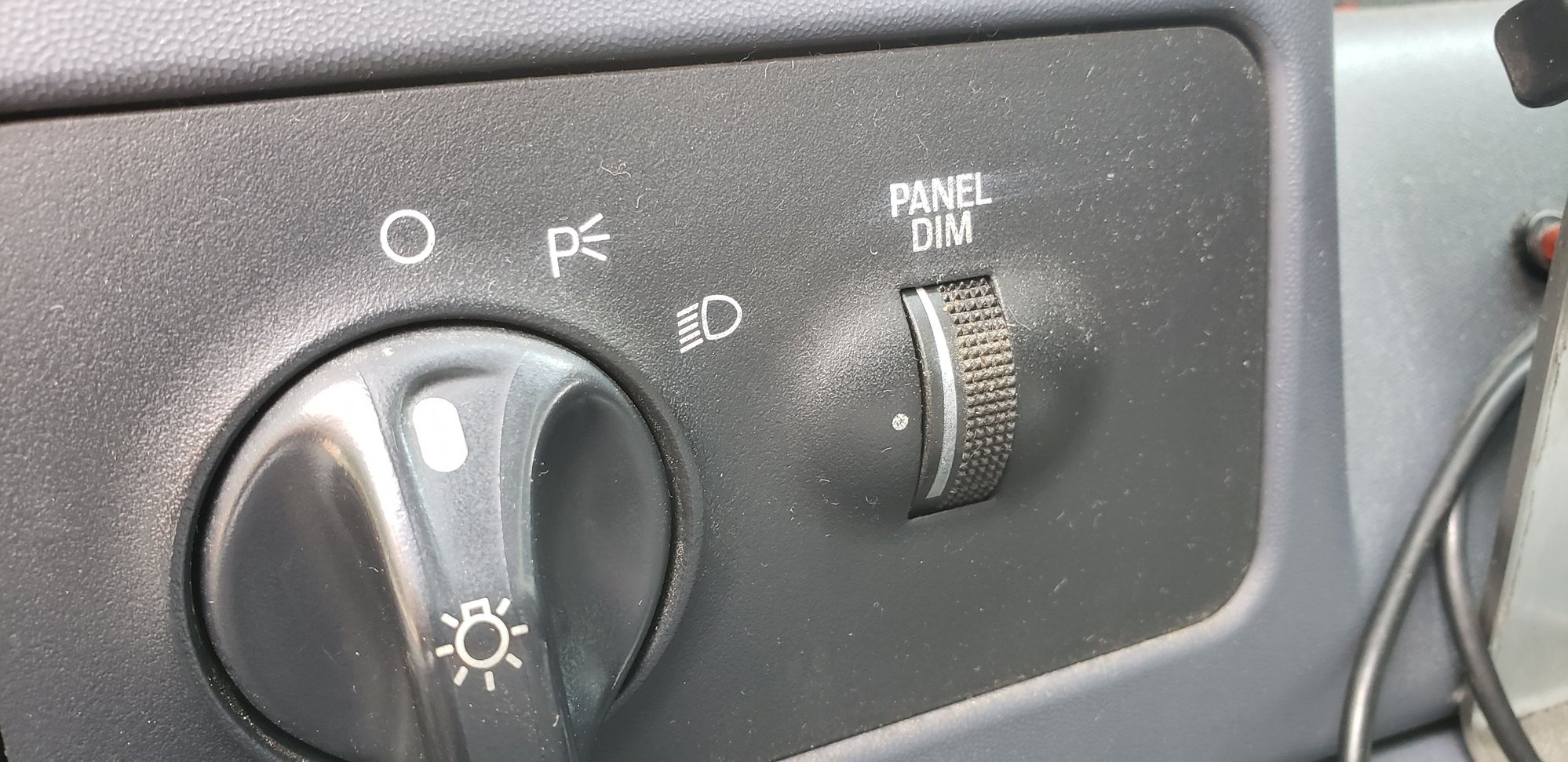

1. Should I swap the instrument cluster? I believe they must have used some or all of the 2001 dash. The 4WD switch is there, and the ash tray is deleted (Weird factory looking cover in it's place with a plastic hook type of thing). My truck has 262K on it and the wreck odometer shows 355K. The instrument cluster portion is identical to my E99. The light switch shows a darkened light symbol at the 3 O'clock position which is not on any of my 99's. The switch does NOT turn to that position.
2. When I removed the bumper, there were what appears to be a factory fog light harness wrapped around the fog light mounts that are built into the bumper. Any idea what powers them? There were no lights installed and I don't see an extra switch. I had factory fog lights on a 98 Mountaineer and there were pushbutton switches for the fog lights, rear wiper, defrost etc. No idea how it's done on the super duty's.

Can't help with too much except the fog lights which I have on my 2001. On my light switch, I have a spot that indicates another set of lights. When I turn the switch to the right and pull the switch OUT, it activates the fog lights. I assume you don't have this switch set up because it would be almost impossible to miss.
When I activate the left stalk mounted high beams, the fog lights turn off. When the high beams are deactivated, the fog lights turn back on. Personally, I would have preferred a separate upfitter switch to run the fog lights. That way I could use them at any time I wanted. As it is now, I can only use my fogs with the low beams.

The switch won't move to the 3 O-clock position, but you can pull the switch so maybe that's it. Need an Egyptian hieroglyphics manual to decipher the pictographs! Lol!
All my other F350's w/o fog lights
2001 Lariat w/fog light wiring

That's it in the bottom 2001 Lariat pic. The lower "light" at 3 o'clock with the squiggly line running through the beam is backlit and it comes on when the fogs are activated.
The switch doesn't rotate all the way to it. It stops at the icon above positioned at 2 o'clock and from there, you pull it out to activate the fogs/auxiliary lights.
I just checked my truck to confirm this as I can not and should not really on my ever failing memory!.
