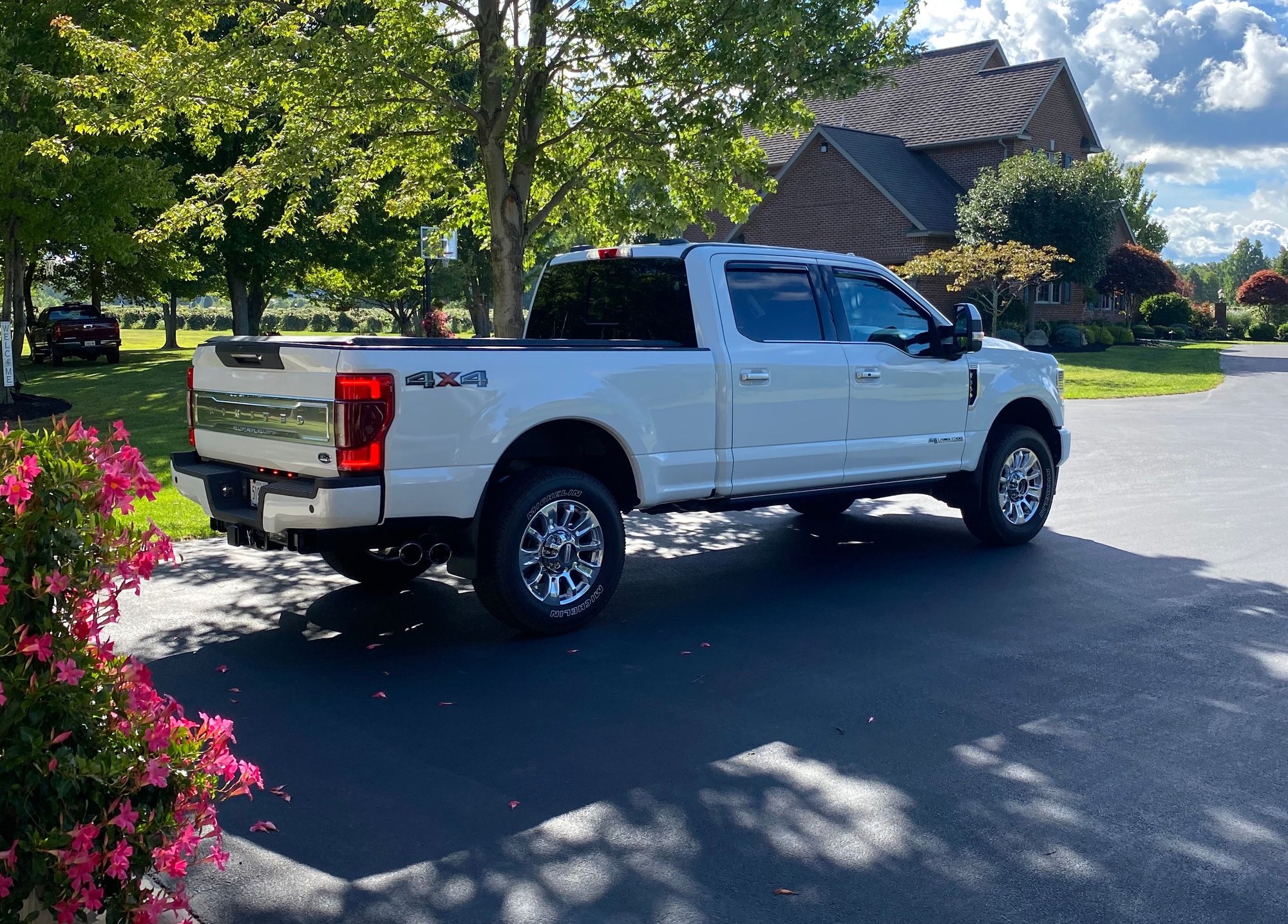

SP package ride is exceptional on my combo.
Diesel weight makes a big difference in ride with the 5,990 springs.
Level? Here’s a pic.
