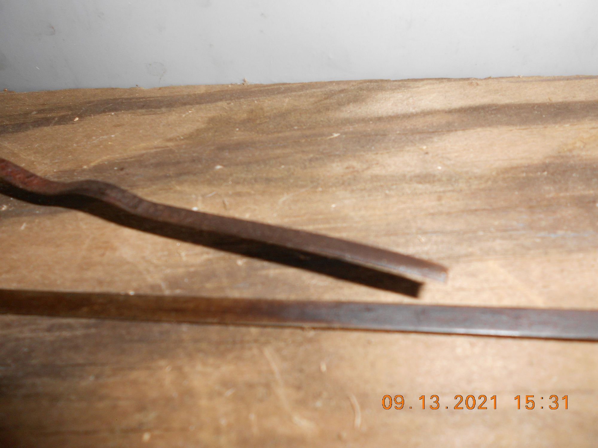

So is it the stick or the tube that broke?
Can you post a picture of what broke may have a fix for it.
Dave ----
Pics . . . dipstick to rusty to weld/braze

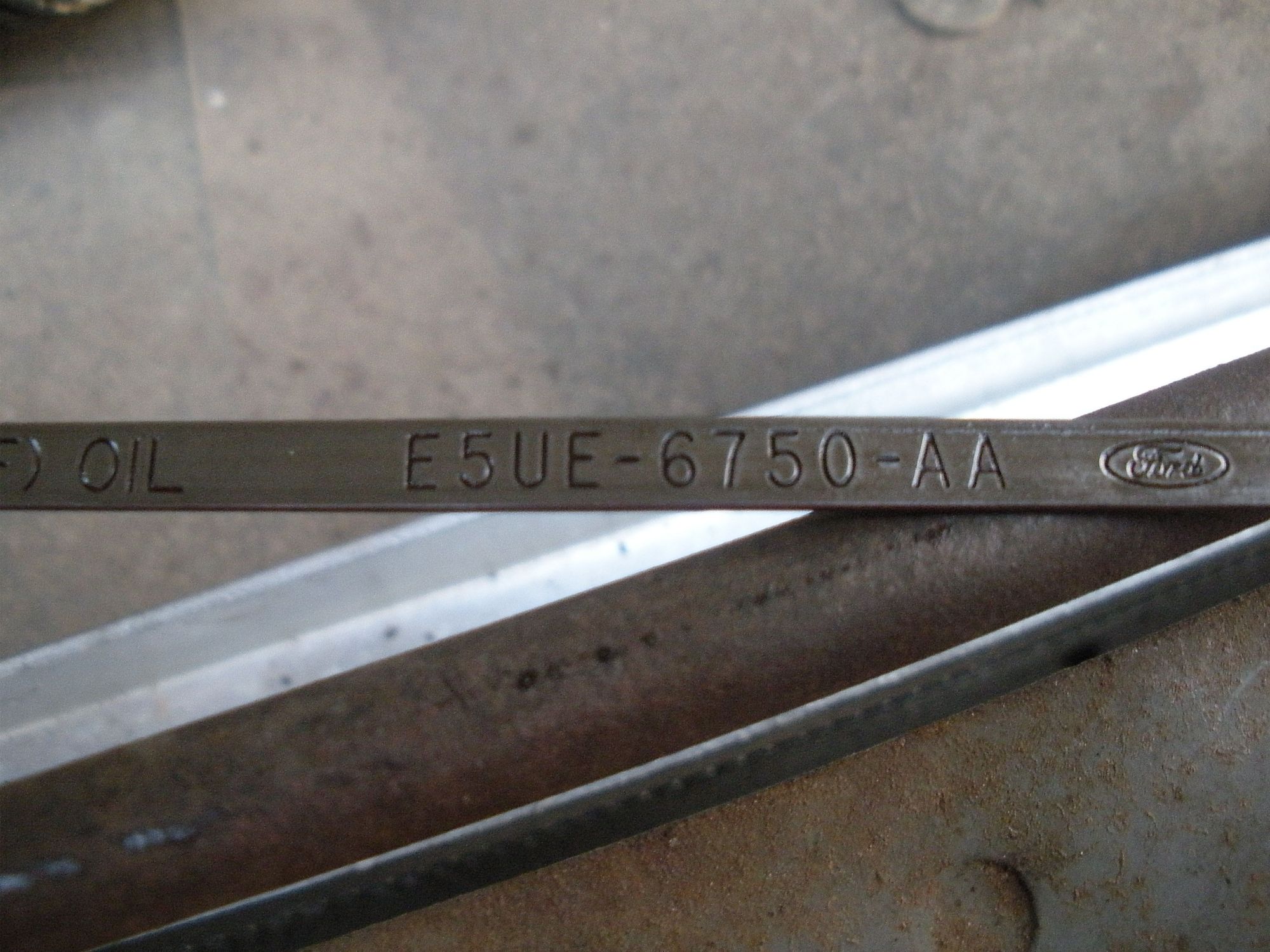

I'll add, I seem to recall from this site, it may be hard to find the correct dip stick. For reference, here's mine,

You can also google the part number. Looks like the OEM stick is $71 from 1A Auto on line, its for a 99-03 diesel...?
You can google my part number, https://www.google.com/search?q=E5UE...w=1280&bih=881
Good Luck.

You could also use a media blaster or wire wheel to clean the rust off of the dipstick. That should get it clean enough to weld together (if you have both pieces).

Worst case, you might lay it out with both pieces end to end, measure it, and rivet in a patch.
I would not trust a simple butt weld to repair the existing break. It might break again next to the weld. Here’s how I’d spend your time and money if you don’t want to buy a used or reproduction unit.
Go to a junkyard and find something close, with the same width and thickness. Don’t worry about the handle details or overall length being exact. Preferably you’d want something a little bit longer. You’re going to cut off the end, grind a tapered scarf joint, and braze it to your existing handle.
Lay out the donor next to the two broken pieces to determine the finished length, so the full marks match up. Make a tapered scarf joint about half an inch long. That will provide plenty of clean surface area for a strong brazed connection. The tapered scarf also prevents the concentration of stress you’d have with a straight butt weld.
Voila! A perfect fit.
