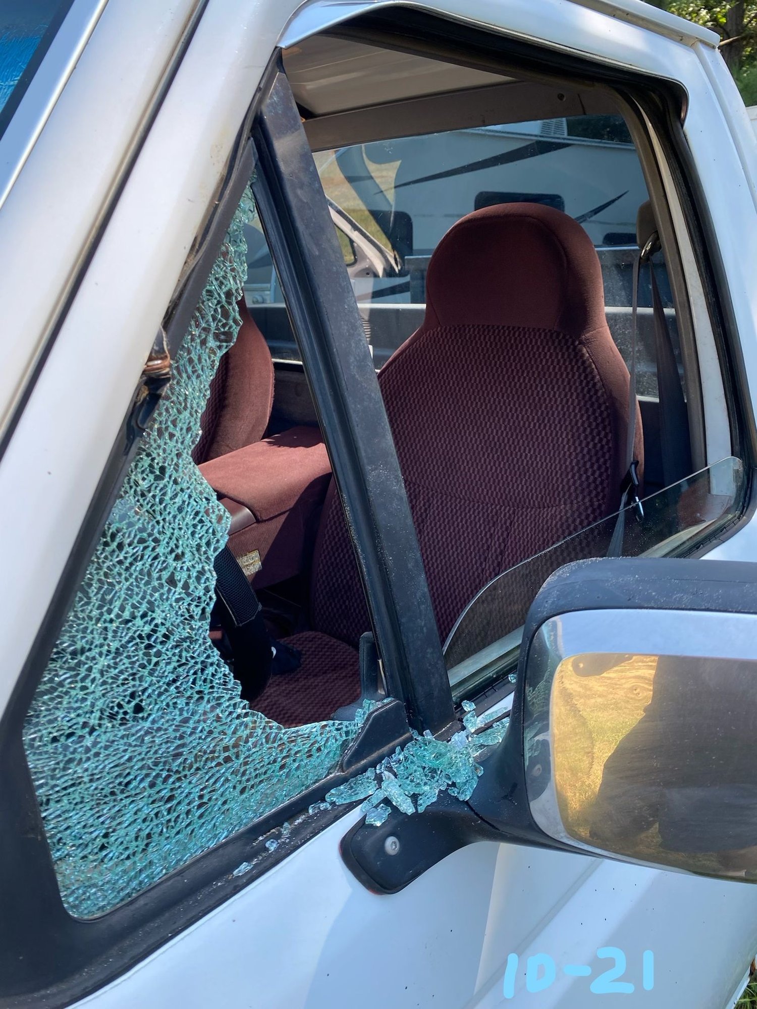

Weird timing. My truck was broken into again last week. I've had it in storage for a while and frequently get asked if I want to sell it - I guess someone decided to try another route.
The ******* broke the wing-window, rolled the main window down and opened the door, then smashed the ignition cylinder to try and crank the engine.
No-Go. I'd just installed a Hydra chip in the PCM - and fortunately had engaged the No-Start tune, and removed the selector switch (see the pigtail connector indicated in the photo) the night prior to the attempted robbery.
I got a replacement wing window assy from the junkyard, new ignition cylinder from O'Rielly's, and all is well again for about $50. I credit the Hydra for saving the truck. All the same, I'm now also keeping a logging chain through the wheel and locked to the frame until I find a better place for storage.
