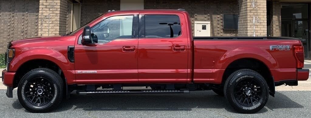

Originally Posted by Y2KW57
@sgthawkusmc
Please post the details of your truck, such as year, model, presence of high capacity tow package, etc, so that interested members can put the receiver hitch label you posted upthread, which has the highest ratings reported in this thread, into perspective with year, model, and option availability.
Please also post the wrench size to the bolts attaching your hitch, and your address, so I can come pick it up one of these nights.
It is nice that new Ford Super Duty owners no longer have to differentiate between "Weight Carrying" versus "Weight Distributing" hitch ratings.
No problem, but you can't have my hitch lol
She's a 2020 F350 Lariat Sport FX4. I'll go one better. Here is the door label.

Forget the hitch, now I wanna grab @sgthawkusmc 's entire truck.
Just look at the darn thing. I don't normally go for fancy lookin, but dang, you picked out an eye catching, head turning combo there...
Thanks @4wd6.7L for posting the 2021 Towing Guide identifying the different hitch receiver ratings and which models they apply to.
Thanks! I'm usually not about shiny and fancy either, but she spoke to me. She has the heart of a mean old beeatch too.
I'll send you my address to come pick her up, but I'll have to warn you... There's 360°, 400 yd fields of fire centered on my truck. One road in and maybe a road out...
