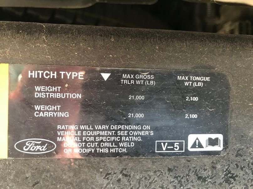

So I guess these numbers from my 2017 F250 will really shake things up. The numbers listed are what Ford certified the equipment at. The trucks will always have some ability above and beyond that.
2100# of tongue weight for a truck with 2355# of payload. Just hang it all on the rear bumper I guess.
