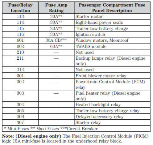

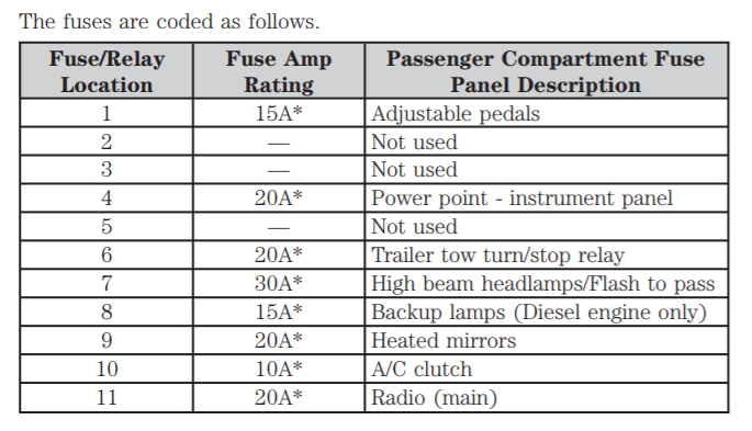

Try this link for the 2003 owner's manual, F350:
https://www.fordservicecontent.com/Ford_Content/catalog/owner_guides/03f23og5e.pdf
From the '03 owner's manual, starting at page #178:
Try Fuse #41. Note sure if it will kill other things you might need though. Got it from this thread:
https://www.ford-trucks.com/forums/8...domelight.html
