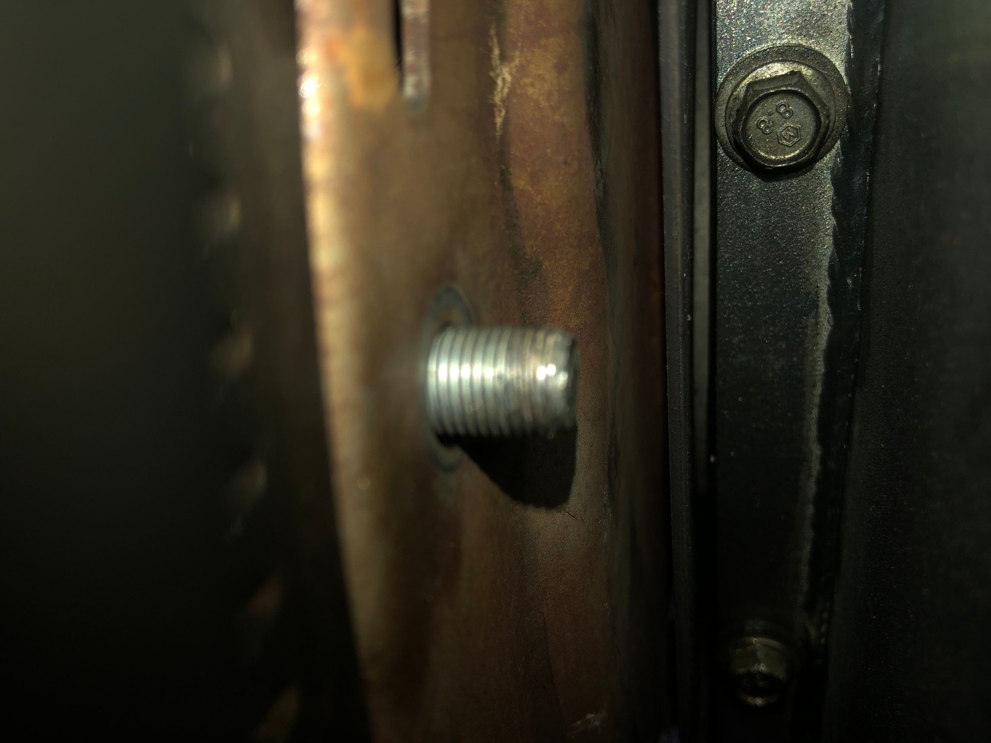

Does anyone know the thread pitch of a 2014 6r80 torque converter. The internet says 3/8 x 24 for most Ford’s but that currently is working on my converter nor does it sound right as most vehicles are metric today.
And yes I know I should have checked it before I stabbed the tranny back in.

Solved the problem. The 6r80 torque converter is M10x1 I hope that this gets tagged by google when others look for this cause everything else for fords is different.
