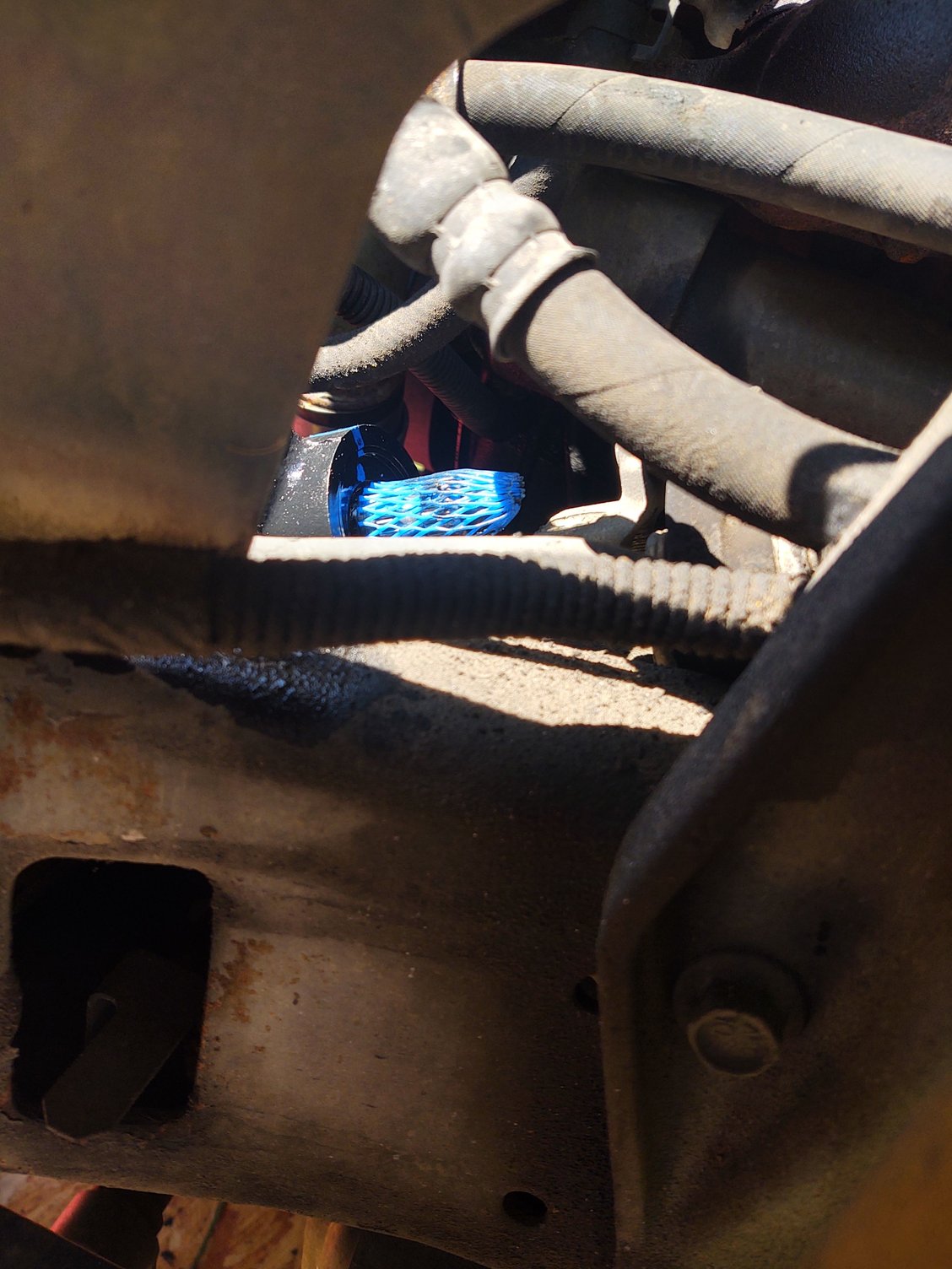

Well the Bluetop is installed. Swap went well with the Sous supervisor who got his hand dirty too.
Thanks alot for driving over to help Sous. Was great to meet ya in person. Fun to wrench with you on Brown Truck
We decided to remove 6637, Battery and tray. Intercooler tube to gain easy access.
Everything went together like should. One thing that delayed up a few mins was lining up the gear spline to the steering shaft. Bluetop had blue paint pen marks that should line up for the splines to match.
We where trying and wouldn't go together but where 90 degrees off.
​​off.Only did a test drive so far but noticed an improvem
ent just burping the air out with the wheels off the ground.
Glad to have help today. Especially while holding the box up and Sous started the bolts. Not sure I could of done that by myself.
Here is a few pics

@Jimmy's Pilot Service , Brad had it about right. I would say 1.5 quarts is what it took to bring the ATF level up to full and maintain it. My gear/system took more than that as I accidently let the ATF drain out of the gear before installing it.
As Brad said, start to finish, it took us ~3.5 hours, but we were not in a hurry by any means. Several breaks to chat about this or that and once to go inside to chat with the family for a few minutes. It does help to have two people for at least the gear installation portion. The gear is rather heavy and getting the bolts started solo can be a bit tricky.
If you are looking for more feedback or opinions on the BT steering gear, check out the recent thread by MiamiPSD here: https://www.ford-trucks.com/forums/1...-gear-box.html
Again, it was great to meet you and your family Brad and I hope the gear treats you well for a couple of decades.
A couple of pictures I took today are below.
Brad was nice enough to get things started prior to my arrival.
A quick shot of him using his "old man mat" to get the track bar loosened.
Here is Brad "givin the beans" to the pitman arm on the old steering gear. Good thing I brought my cordless impact gun. The pneumatic gun got it loose, then cordless popped it off while the pneumatic took a break.
