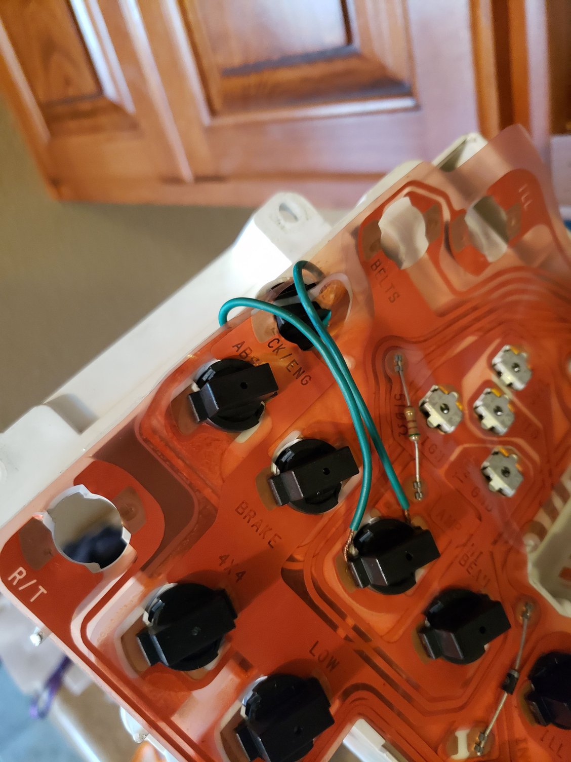

I bought a gauge cluster with a tachometer to swap into my 96 F250 and on the back it has 2 jumper wires from the voltage light to the check engine light (see pic), is that normal? I don't think it is but. 2nd question the voltage gauge doesn't work in the cluster I bought so I thought about swapping the working voltage gauge from my cluster and swap it into this new cluster. it's only held in by two screws on the back but the needle is keeping it from pulling out. How do I remove the needle so I can get this gauge out.

No the wiring is not normal.
The needle should pull/pry off.

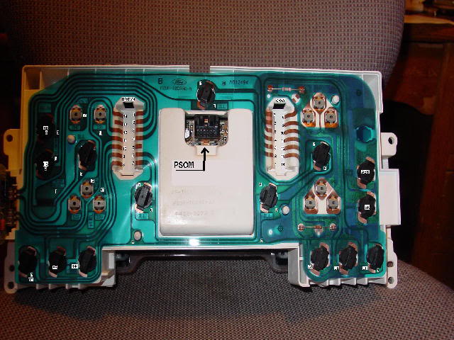

No need to swap the entire speedometer/odometer cluster. All you need to do is swap the PSOM on the back.
Attachment 272042
courtesy of Subford

By the way the PSOM has nothing to do with the gauges.
It is a stand alone unit. It just happens to be mounted in the cluster.
