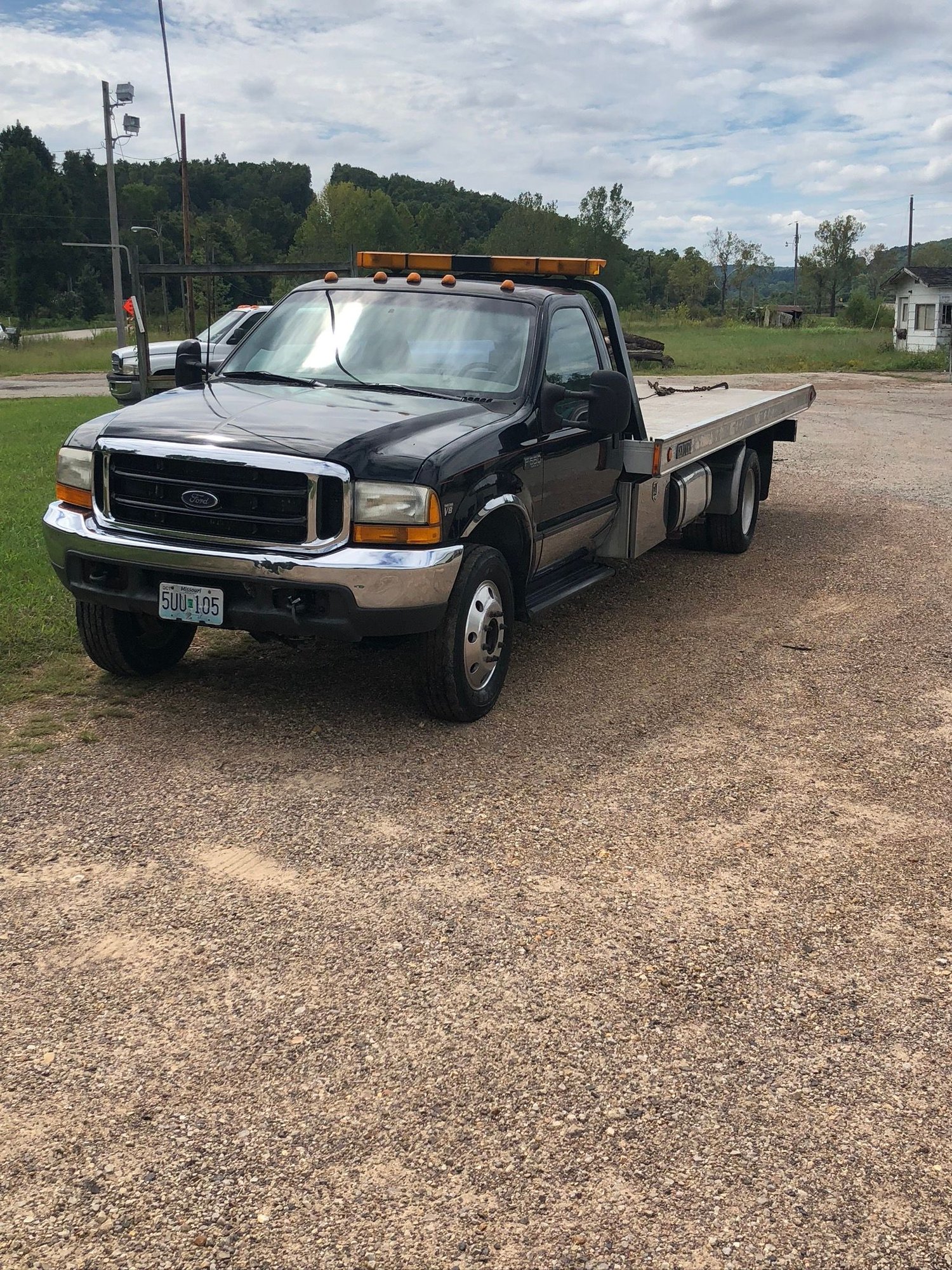

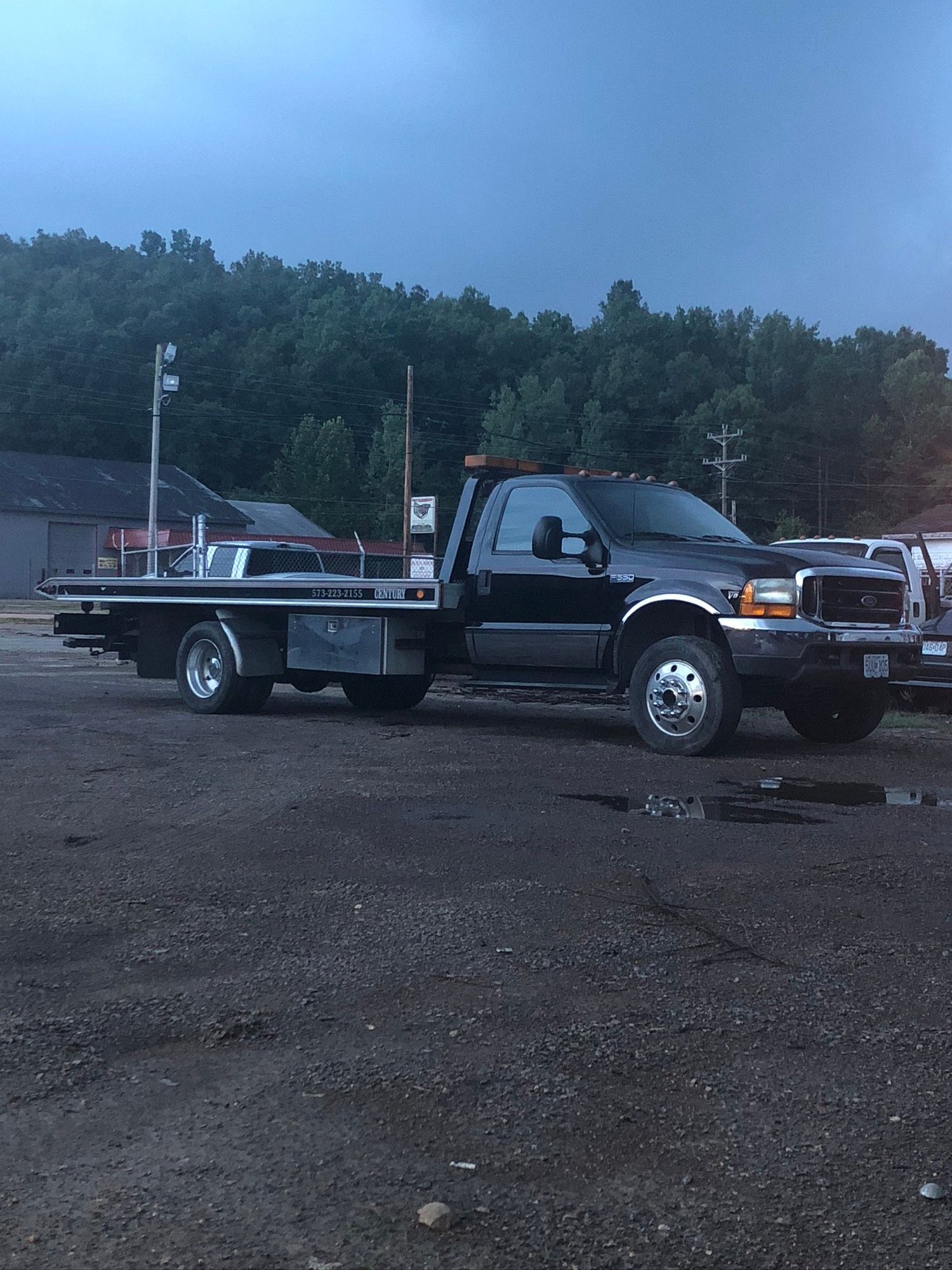

Well guys I’m in the process of getting my 99 superduty f550 rollback ready to go to work. And first on list was to drop the trans for a clutch. Truck has a resealed 2000 motor in it with intake 4in exhaust and rebuilt turbo along. With a dp tuner honestly will probably get a hydra as soon as funds allow. Tuner came with the truck the replacement engine came out of. The truck weights around 12,600 lbs and I’m finding all kinds of conflicting information on clutches.
Ive drove different trucks with big single disk clutches along with dual disk clutches the engagement was nice and similar to stock in my opinion. Anyway mainly looking for recommendations and advice and first hand experience. Thanks for replies in advance.
