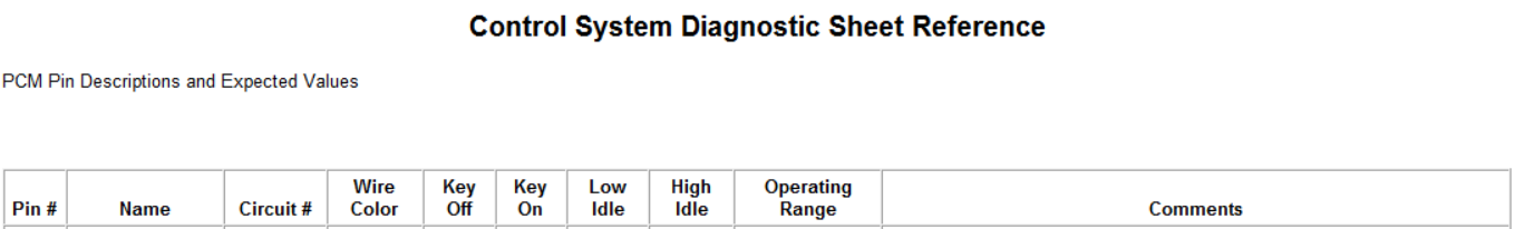

How are you testing the function of the sensor? If you are using TorquePro or another scantool, you should verify the reading with FORScan or FORScan Lite in my opinion.
I have attached the IAT pinpoint test from the Ford Service Manual PC/ED volume.

Most likely the sensor is shot and needs to be replaced. This sensor does not go out often, but it does happen. Stick to OEM/Motorcraft from a reputable source.
