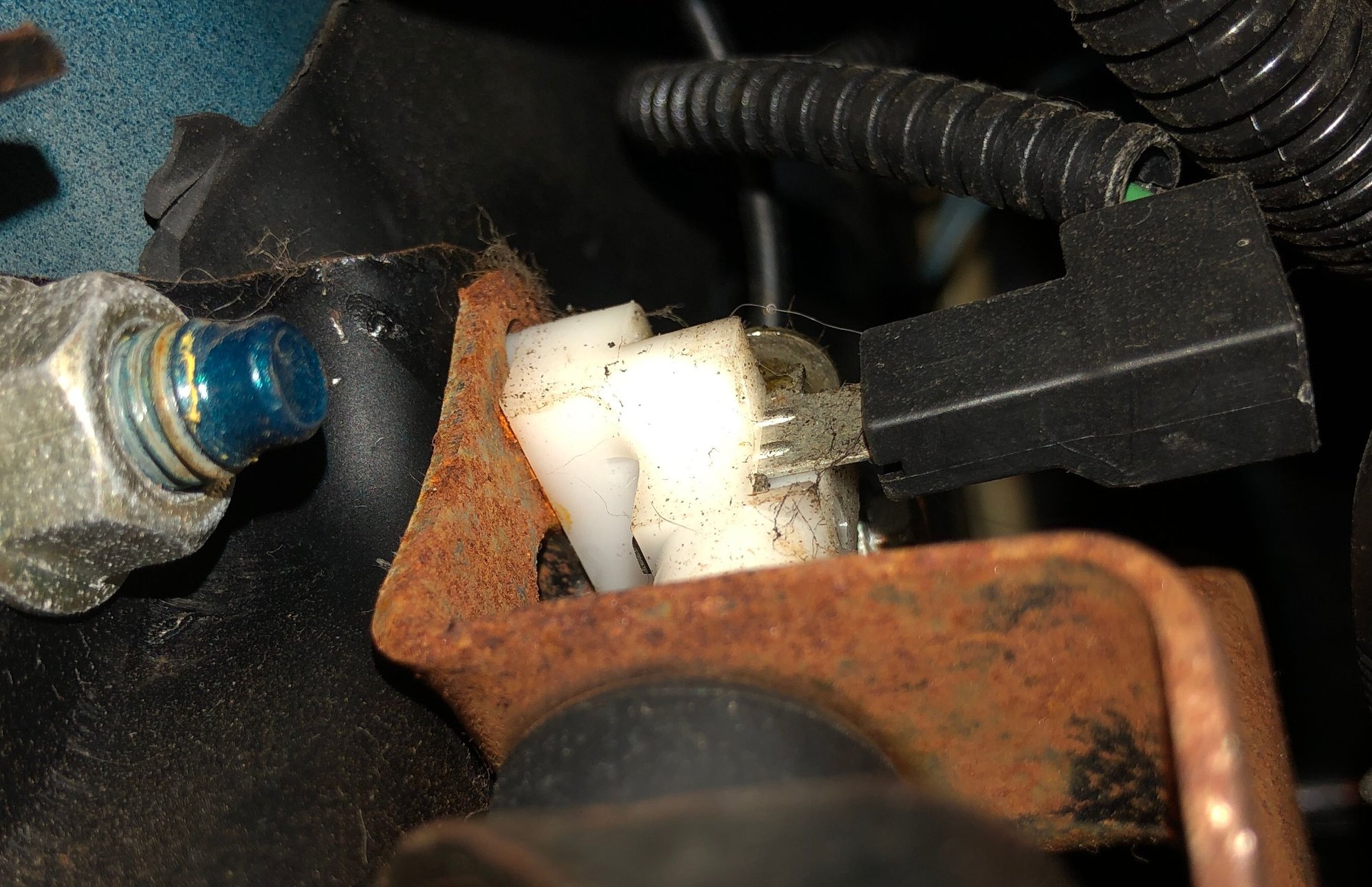

Plug
Does anyone know what this plug is for? It just seems to have a cap on it. 2003 f250 fx4 xlt auto.
E8TB-14A624-AB

My searches say
Clutch safety switch.. 🤷🏻‍♂️
was it ever converted from manual? Or possibly used the switch for something else?

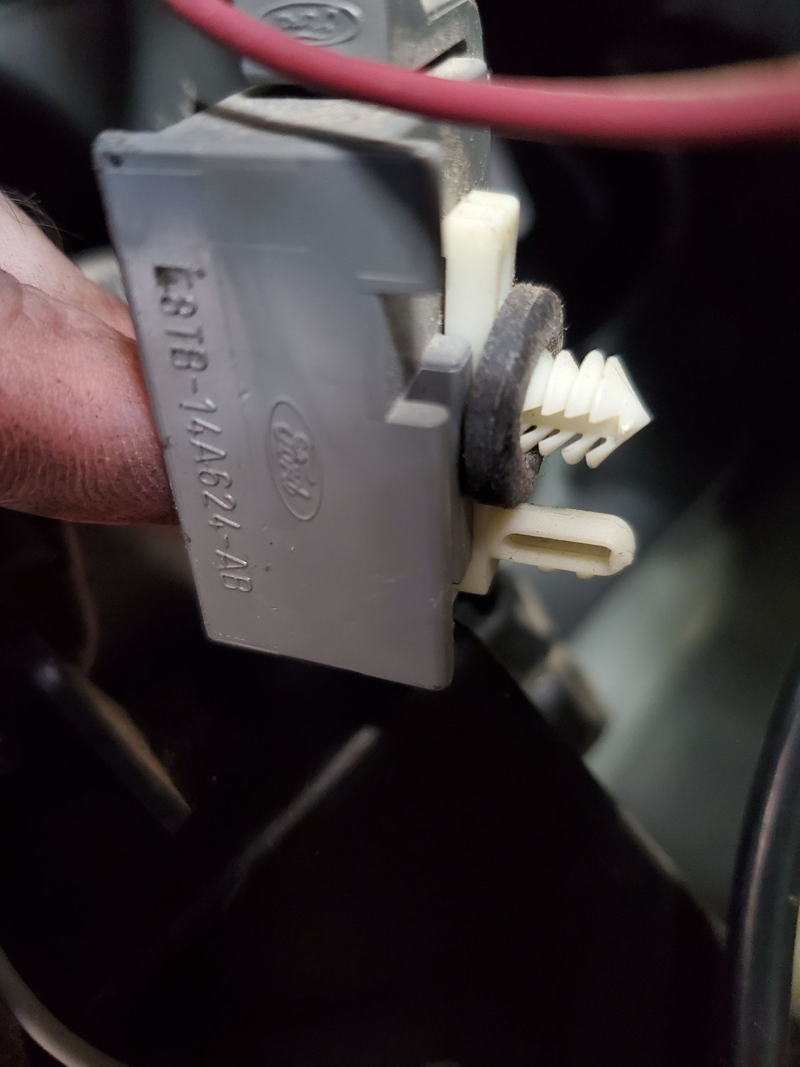

It is the plug for a clutch pedal switch, it has the the factory insert in it to bypass, since you have an auto. All the trucks have them, autos just have the bypass insert, since the pcm reads the gear selector position.

Got it, thanks. That's what my google search showed but didn't know if it could be something else for an auto.

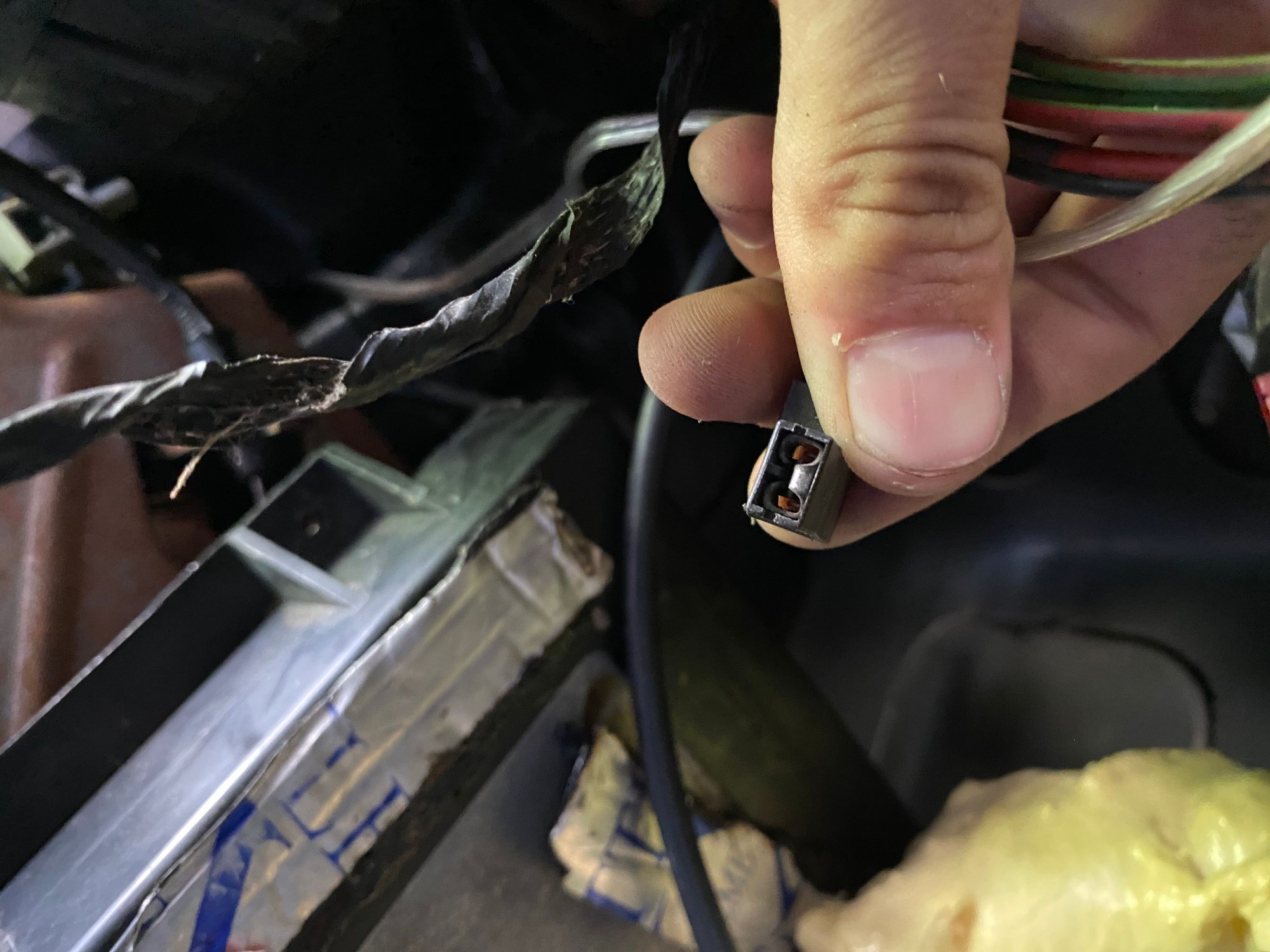

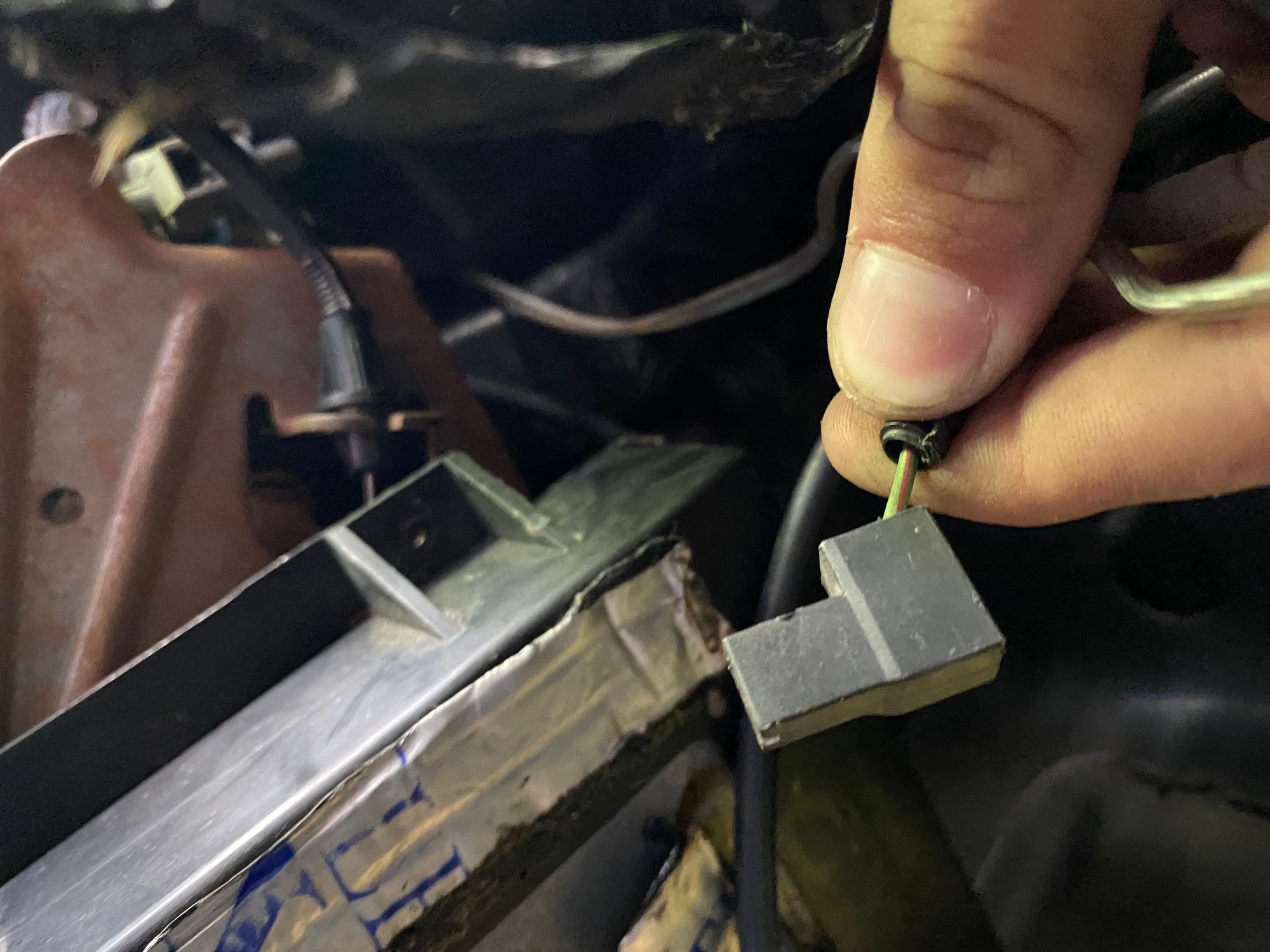

Plug behind fuse box under dash
I
found this plug under my dash behind the fuse box anyone know what it goes too or where it plugs in at? Single green/ red wire

That looks like the parking brake switch connector to me. I am going off memory though and I am not getting any younger.
The switch is located at the top of the parking brake lever action near the side wall just under the dash. They are typically white and have a plunger that is depressed by the brake lever.

Spot on Sous.
Just went and checked.
Green / red stripe.
