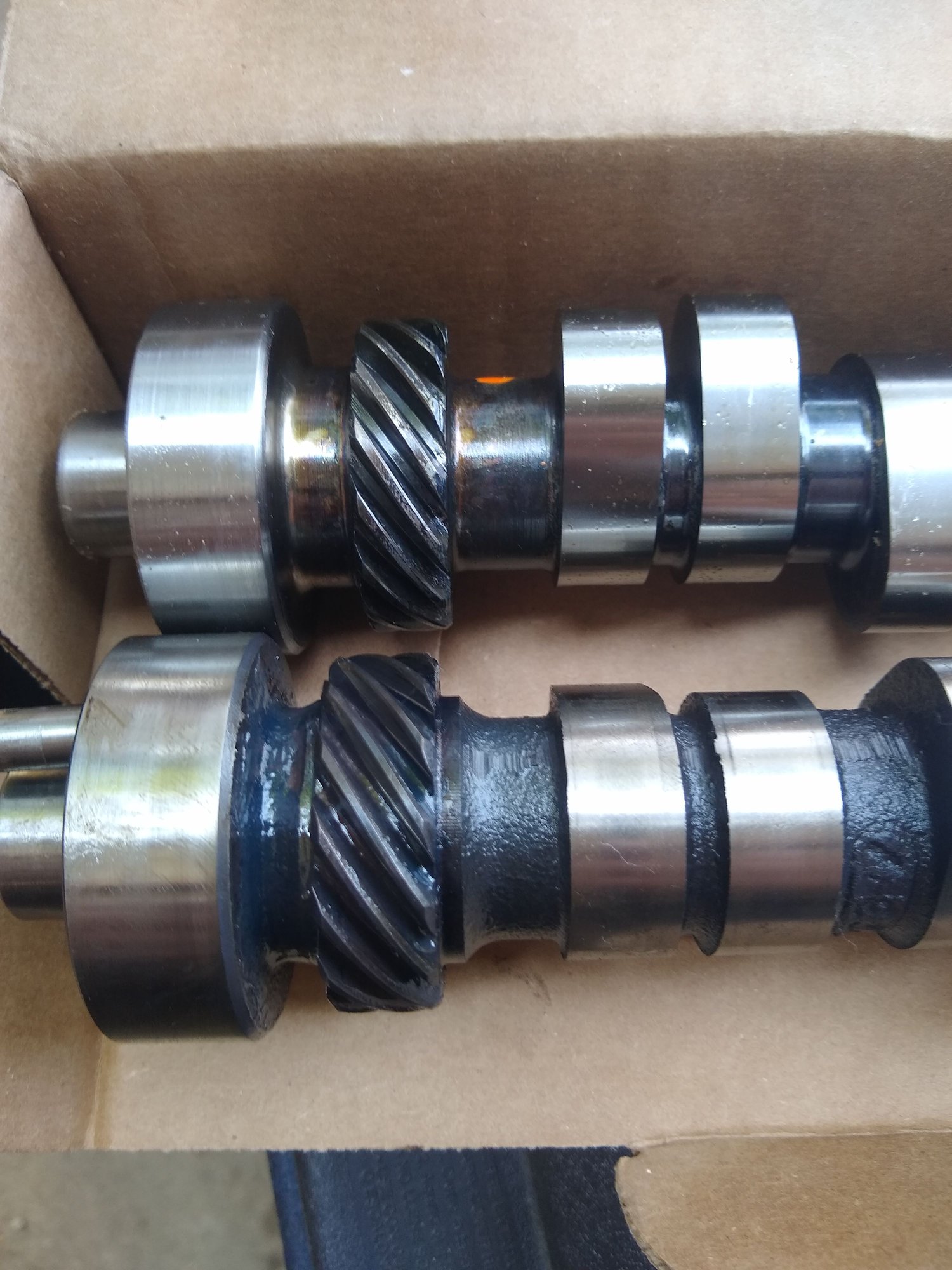

Here's the lineup:
Ford Racing Performance X303 on top.
Comp 35-349 bottom.
Looks clear to me the X303 is billet steel. I'm going to run the stock ford roller distributer with stock steel gear and keep an eye on it.

You're right that looks like a one piece steel core. It doesn't look like a core from a production 5.0 engine either. What number is on the end of the core?
