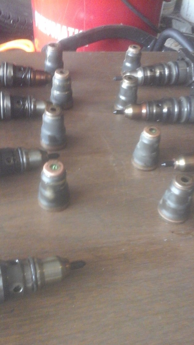

Long time listener, first time caller. Several months ago, I noticed what I thought was fuel in my coolant. Fast foward one 3000 mile family vacation,and now there is a sludge build up in the top of my degas bottle. Got the injectors out and pressurized the cooling system at 17 pounds for a hour. Never saw a leak like the u tube videos. Is this possible, or could there be a leak around the outside of the cup? I do already have the cups, and riff raffs cup tool kit. Also the 620 retaining compound. I was hoping to find the smoking gun, I would be more confident if I had. I have not removed the cups yet, not as quick as I used to be. Am I headed in the right direction, or could I be missing something?
I have most of the parts on hand to replace hoses, degass bottle,water pump, and oil cooler seals. I did get the dual alternator top hose that does not run thru the belt.
Another question if I could. 4 of the injectors have a brownish color up to the first seal. Were the injectors loose, or did the copper washer fail? Related to the contamination of the coolant? Did I find the smoking gun?

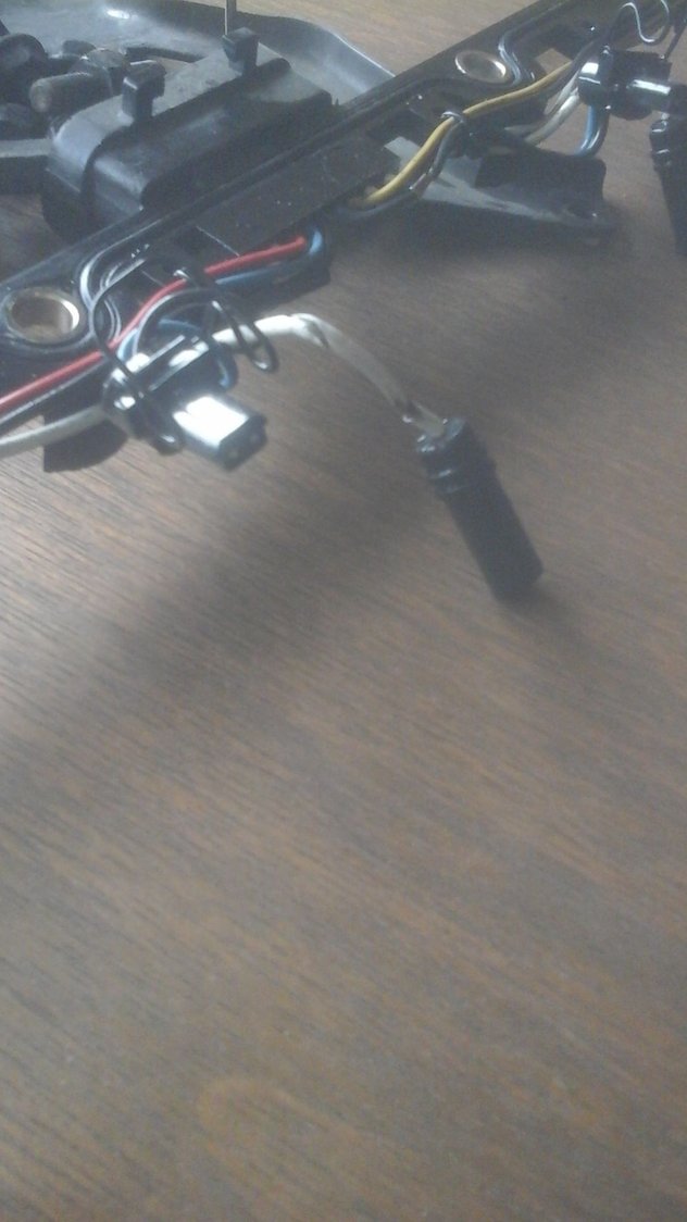

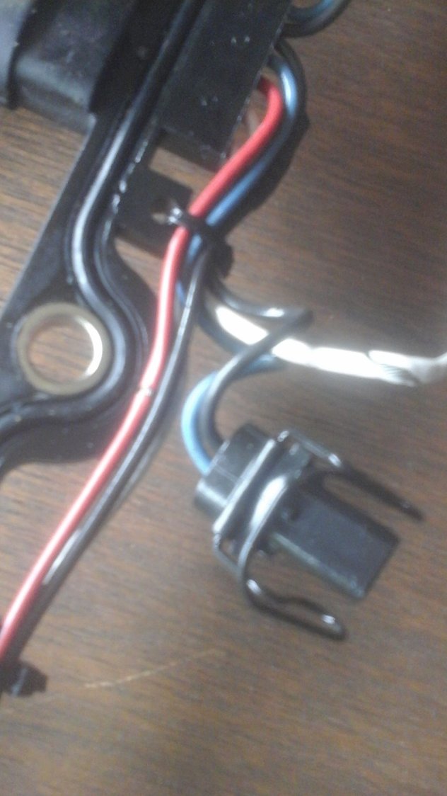

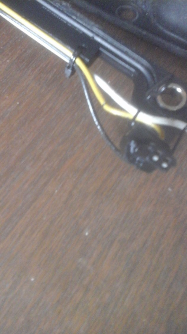

Sonce no good deed goes unpunished, I found the ccv oring spit out, and the doorman uvch have compromised wiring insulation at only 25 months old. The doorman parts were not my idea,but installed at a repair shop in Colorado while we had to find our way home for work and return 3 weeks later to pickup the truck and travel trailer.

Sounds like you may just need to re seal the oil cooler if the leak down test passed

Got the cups out, no smoking gun here. The riff raff tool was not as easy as expected, the fine threads kept pulling out brass. Was applying 100 ft pds with my 24" torque wrench, I colud feel the thread shaft of the tool flexing. 2 cups popped right out, 1 pulled 3 times
before coming out on the fourth try.
ordered stock reman injectors from Bitterroot today. 4 week lead time.
pics of 25 month old doorman uvch. Again these weren't my choice, motorcraft from riff raff to arrove tomorrow

The staining on lower injectors is not a smoking gun.

I had problems with the dorman UVHC as well. I could never get it to fully seal. I replaced with OEM and no problems. Some dorman stuff is okay. Some is not.
