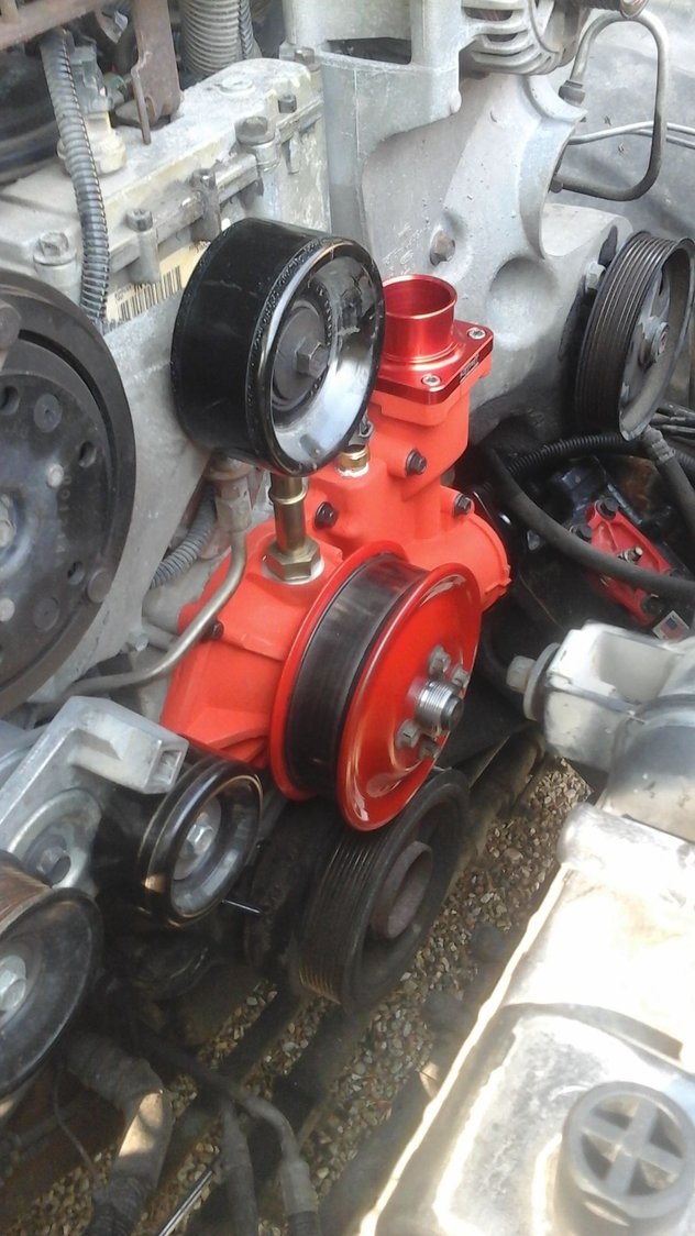

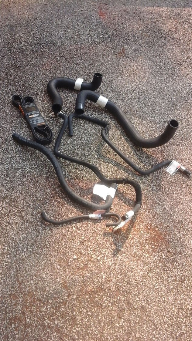

Cups are all in. Water pump replaced. Try to get all the hoses done today.
