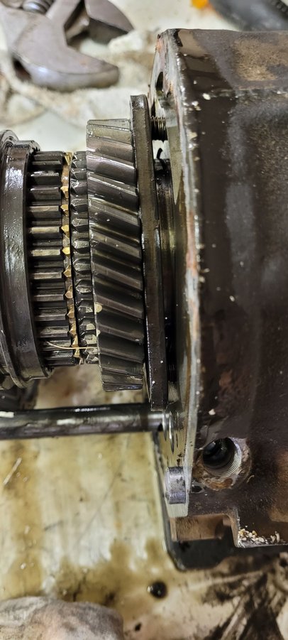

Pulled transmission and found the retainer bolts on the output shaft had backed out and one had been sheared off. ordered a rebuild kit . Waiting on all the parts to come in.
Areas of concern input and output shaft pilot bearing bearing surface. hope to have that resolved soon.

Got it all back together, Works great. New input shaft and a repaired output shaft.
