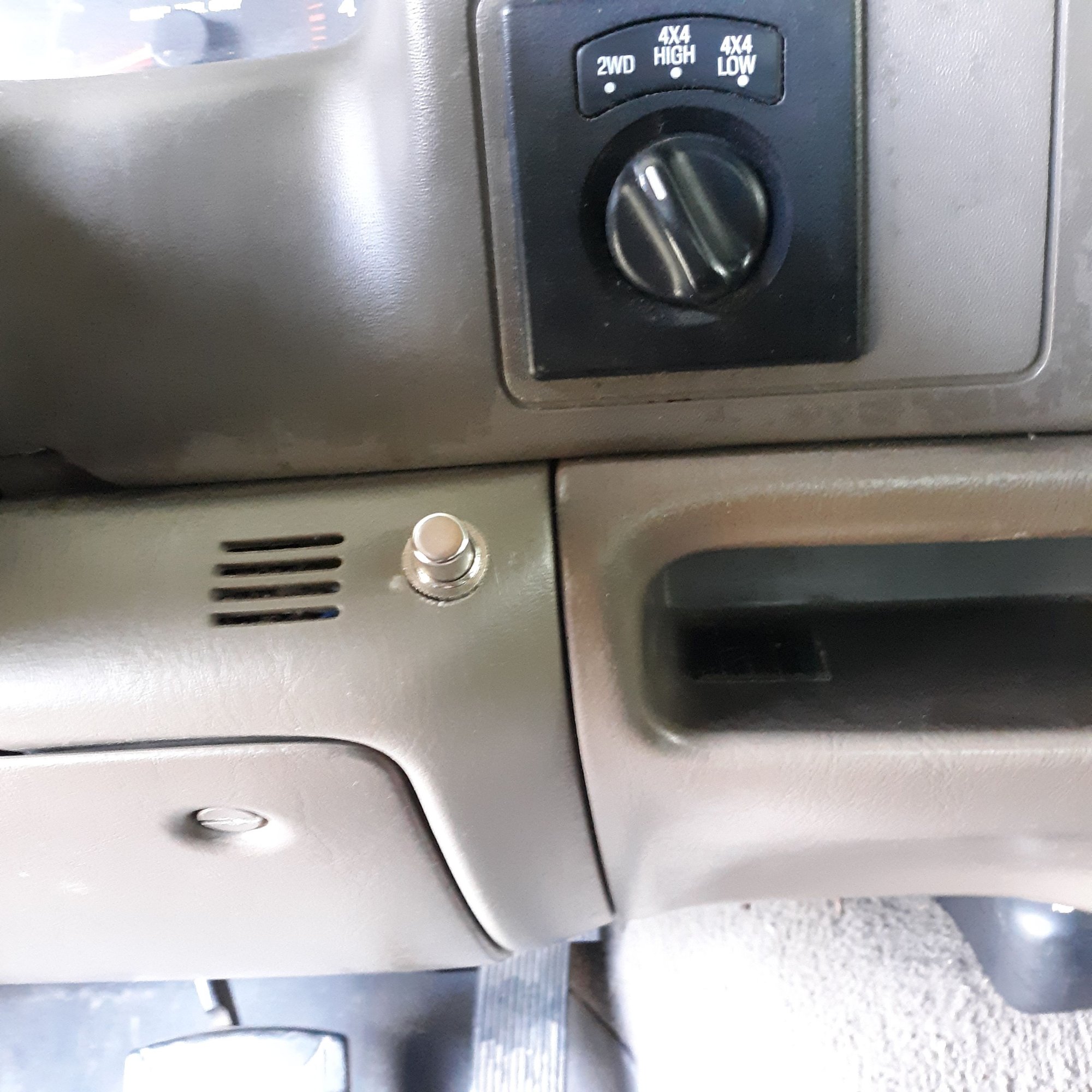

2001 F250 4WD 7.3 diesel. Recently, the start circuit fuse blew while trying to start. New fuse in, pop. Replaced the starter just because I felt like it was time. 210,000 miles. Life was good for a couple days, then pop goes the fuse. replaced the solenoid on the inner fender well, and guess what? Life was good for a few days, then pop goes the fuse again. Having some time to investigate today, I determined the issue is the wire going to the solenoid. Disclaimer: I am not an electrical engineer, but I did stay at a Holiday Inn Express last night. The starter will crank by jumping the posts on the solenoid, so I am calling everything good from there to the starter. I have installed a push button start to keep it running while I figure this bugger out. My question is, is/was there an issue within the start circuit that I can look for? The wiring from the solenoid appears to be in good condition, but I have not unraveled the tape enclosing it. As a side note, the wiring harness was resting on top of the turbo. I assume it may have gotten hot, but I see no signs of melting. I am developing a love/hate relationship with this POS......errrrr I mean this awesome truck. Any help would be appreciated!
