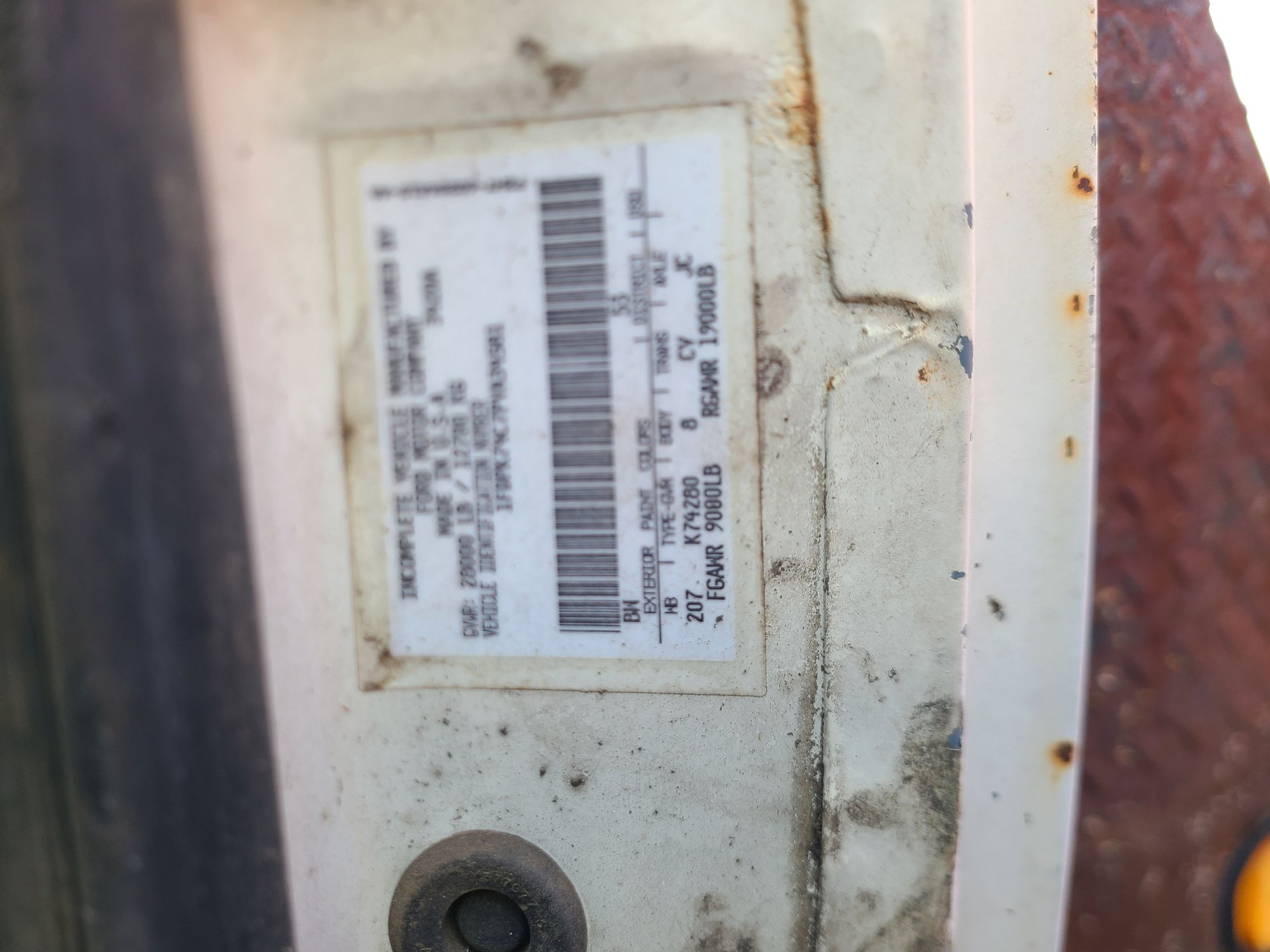

F700 5.9 cummins auto trans
I'm trying to find the axle ratio, can't fine anything online
Can anyone help

I can read the code, JC, but I can't find that in the Tech folder above, which has some 1980s info.
I can't read the rest of it.
What year is the truck? Can you post a clear picture of the sticker?

It's a 1993
that's the only picture I have at the moment

Is the drivetrain original? According to my source of information, the transmission code CV is listed as a Eaton FS-5005B five speed manual. The axle code JC comes back to what I surmise to be a two speed axle RS-19-220 with ratios 4.30/5.00. Although I don't claim to be any kind of expert on medium duty trucks, I don't think I've ever heard of any automatic trucks equipped with two speed axles. Hope this helps.

As far as I know. The truck is selling at auction next weekend. I'm trying to find a better a axle ratio than my current setup, 6.14

6.14's are gas burner gears although I have seen them in a few trucks with the high reving 3208 Cat diesel, but they weren't very fast.
m-chan68's numbers are spot on for a 5.9 equipped truck

M chan68 it may have had a cab swap possibly or switched to auto

My new book came in today and to my surprise it list all of the codes
M-chan68 had it right except mine say the axle ratio is 4.30/6.00
The Vin number is to blurry to read
