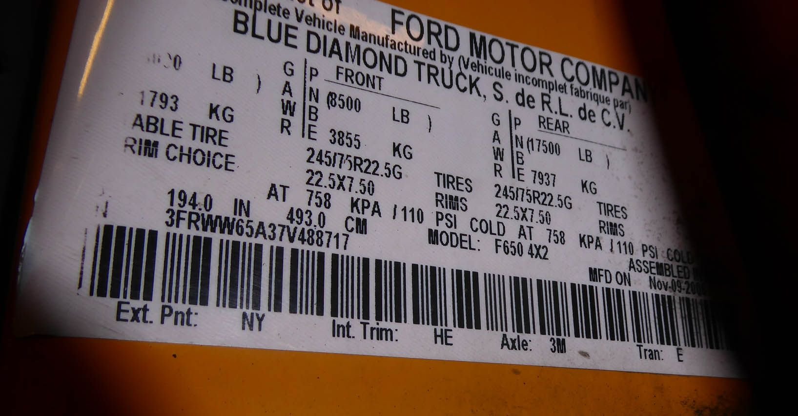

I've got a few of these trucks, and so far I've been able to figure out it's the Cummins 5.9, 200 hp. with the Fuller FS-5205A transmission, but I haven't been able to find anything on the axle code "3M". The vin is 3FRWW65A37V488717, I've attached a picture of the door tag. Particularly in need of the ratio. Any help is much appreciated.

Click on your VIN above. It goes to the VIN decoder here and comes up with:
17500lb Spicer 17060S single reduction single-speed rear axle w/190 wheel ends
as well as all the rest of the info.
Let us know if it matches or if it's off in some way.

I did see that on there, however it didn't list the ratio, it just gave basically all of them 😅
The ratio is ultimately what I'm after.

Scroll down to page 5 where they show the locations of the tags on the axle, and where the ratio info is stamped.
http://media.spicerparts.com/cfs/fil...aLD9EpM7Qu/AXS
The other way is if you have a tach and speedo that work, and have a 1:1 gear (just makes it easier) and the loaded radius of your tire.
Drive it to an even number RPM, note the speed and apply to a calculator.

For anyone who comes across this in the future, it's 3.90

Thanks for the follow up message. Did you find it somewhere we can use as a source? Or the hard way under the truck?

The hard way unfortunately.
