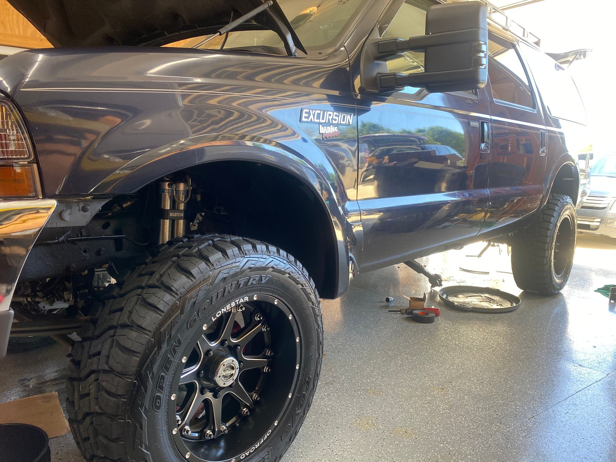

Picked up this 2001 7.3 with 40k miles on it. No that’s not a typo, and yes it’s real miles, 1 owner. It had been sitting for years in a metal building. Just finished going through it and modernizing it a bit and am having some issues. Any help is appreciated.

the truck was lifted 22inches on 44s and had not been registered since 06. It’s legit.
