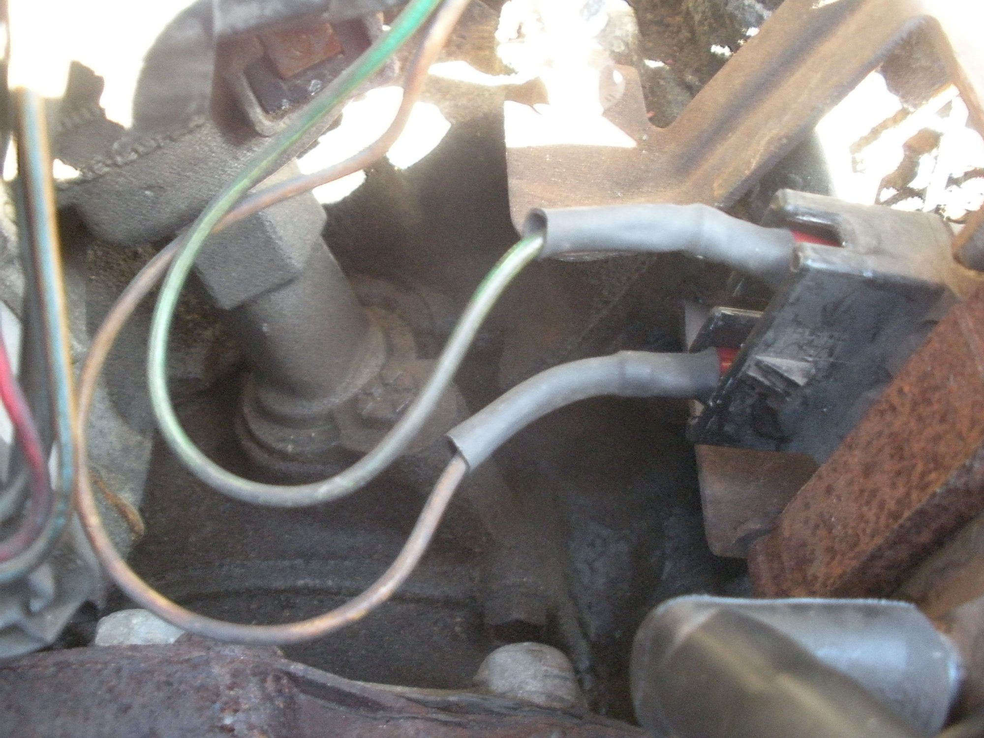

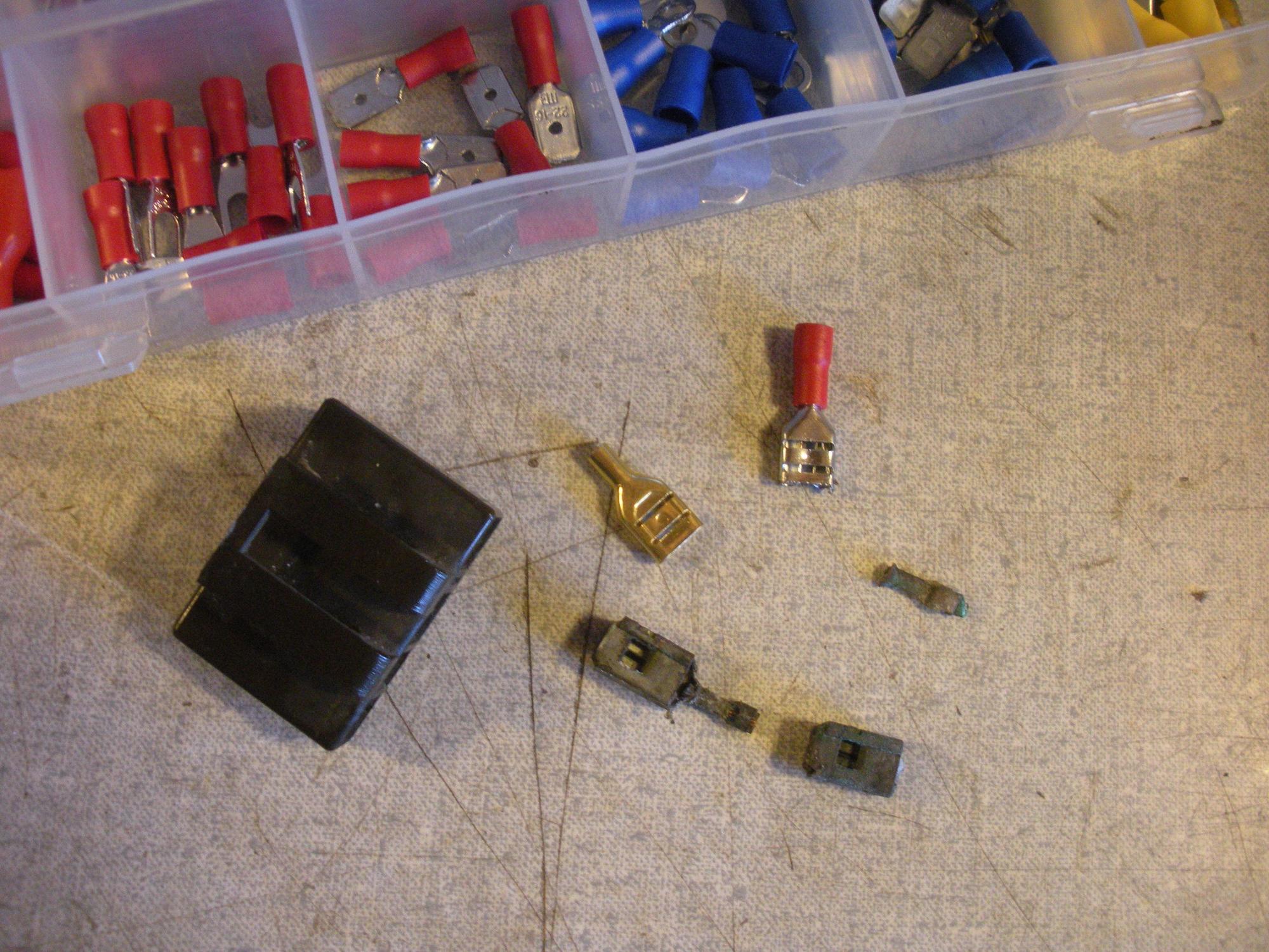

Have you checked the wires at the coil connector. Last Fall after chasing intermittent starting issues, I found the wire crimp on one of the coil wires in the connector was corroded.
