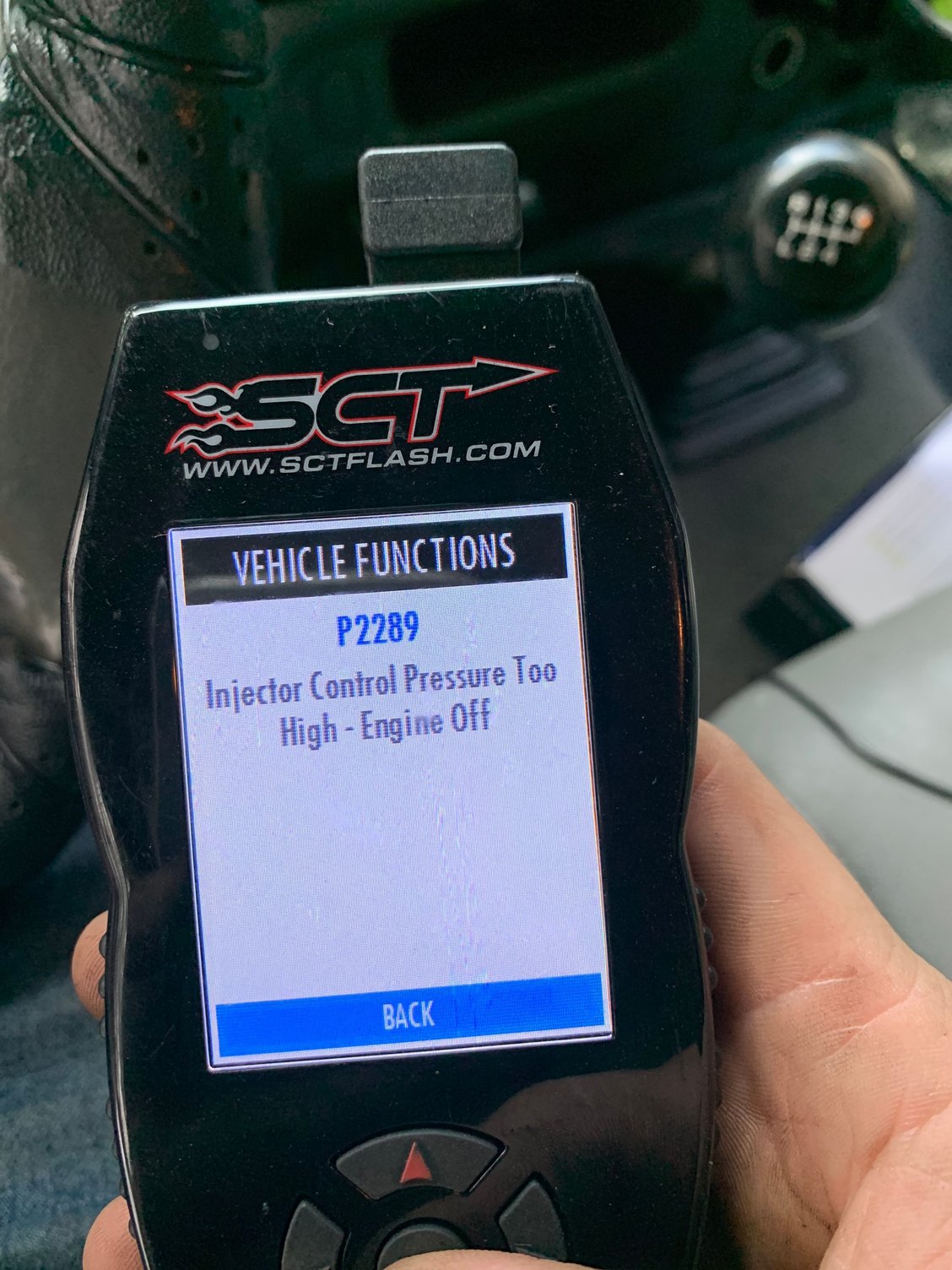

well. Got the new sensor and got it in. And getting the exact same voltage. This time I tried to start it and it wouldn’t start and three and icp pressure to high code. Reset my scanner and ignition and then it started. Still .30 volts at idle and .14 koeo. Reading like 870 pounds at cold idle.
870 lbs at idle cold

With a new OEM sensor, that code means a wiring issue.

it won’t start unless it’s unplugged and also noticed that the clicking kinda noise when your heating your plugs to start isn’t there when the icp is plugged in. When it’s unplugged the noise is there and it starts. I assume that noise is glow plugs heating up? Idk could be wrong but I’m stumped. Just replaced the icp and pigtail again. Soldered connections. Along with the ipr and pigtail with soldered connections as well. Using nothing but Ford parts

Both p2285 and p2289 are still on
