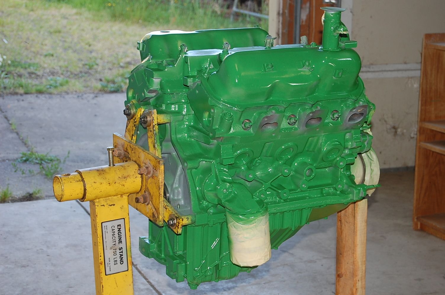

Attached is the same engine 1 year ago before re-install. John Deere Green goes back to other stories.
I will follow through with your suggestions and feedback all the wonderful discoveries. *>
