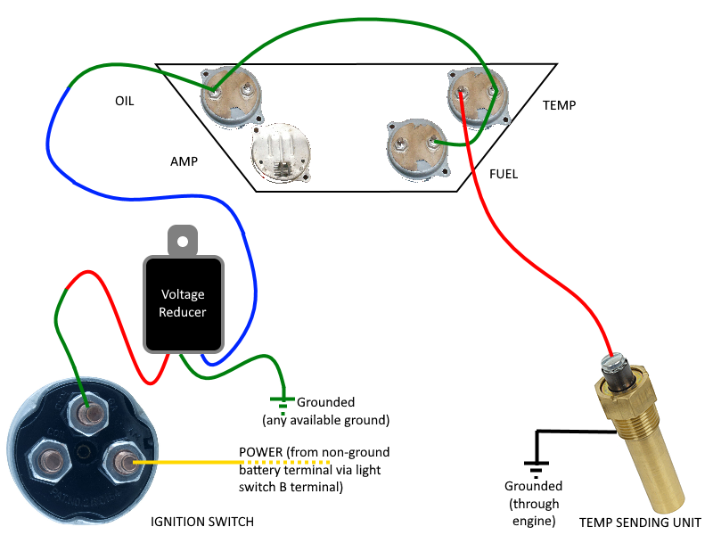

You should have something like this:

Good Illustration
Good Illustration B4. I did same with 49 F1 with 302. Had to get a flat head temp sensor that would work with stock gauge from suppliers. Before I installed it I put grouded sensor in metal can and heated water with small torch and watched temp gauge to know actual temp at 1/2 & 3/4 gauge. R ead temp with infered temp gun at sensor . Lucked out when installed in intake as thread and depth worked. Hope this helps. Good Luck.
