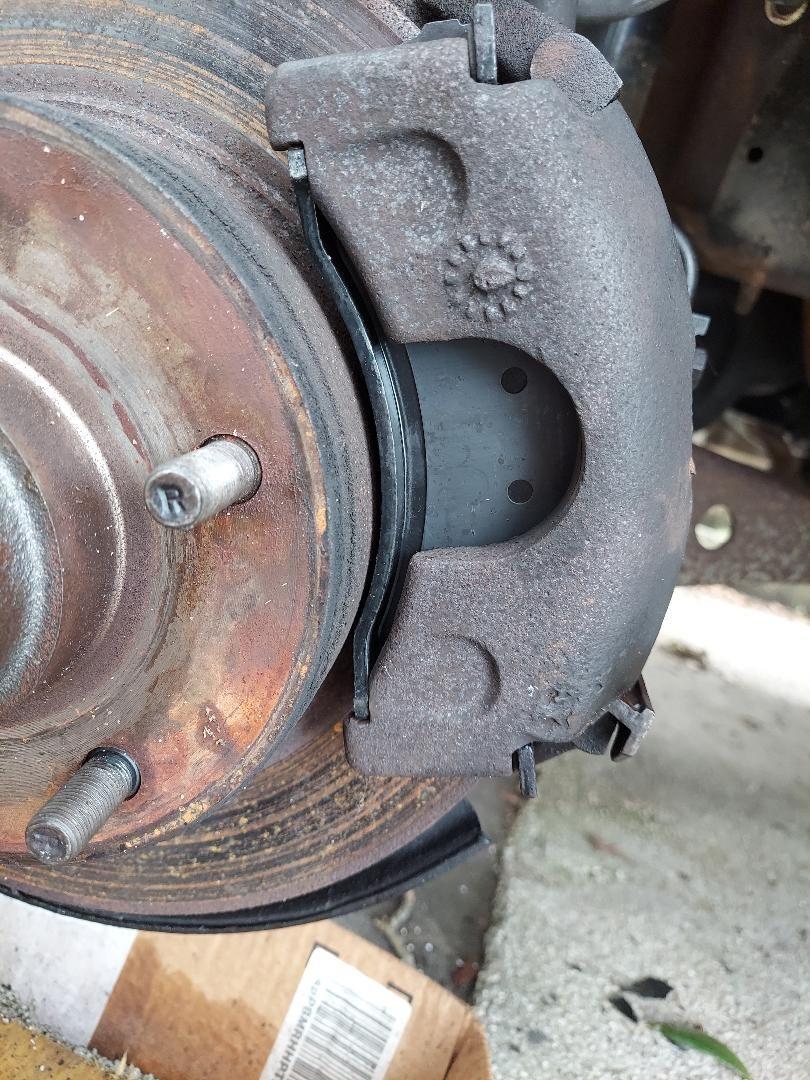

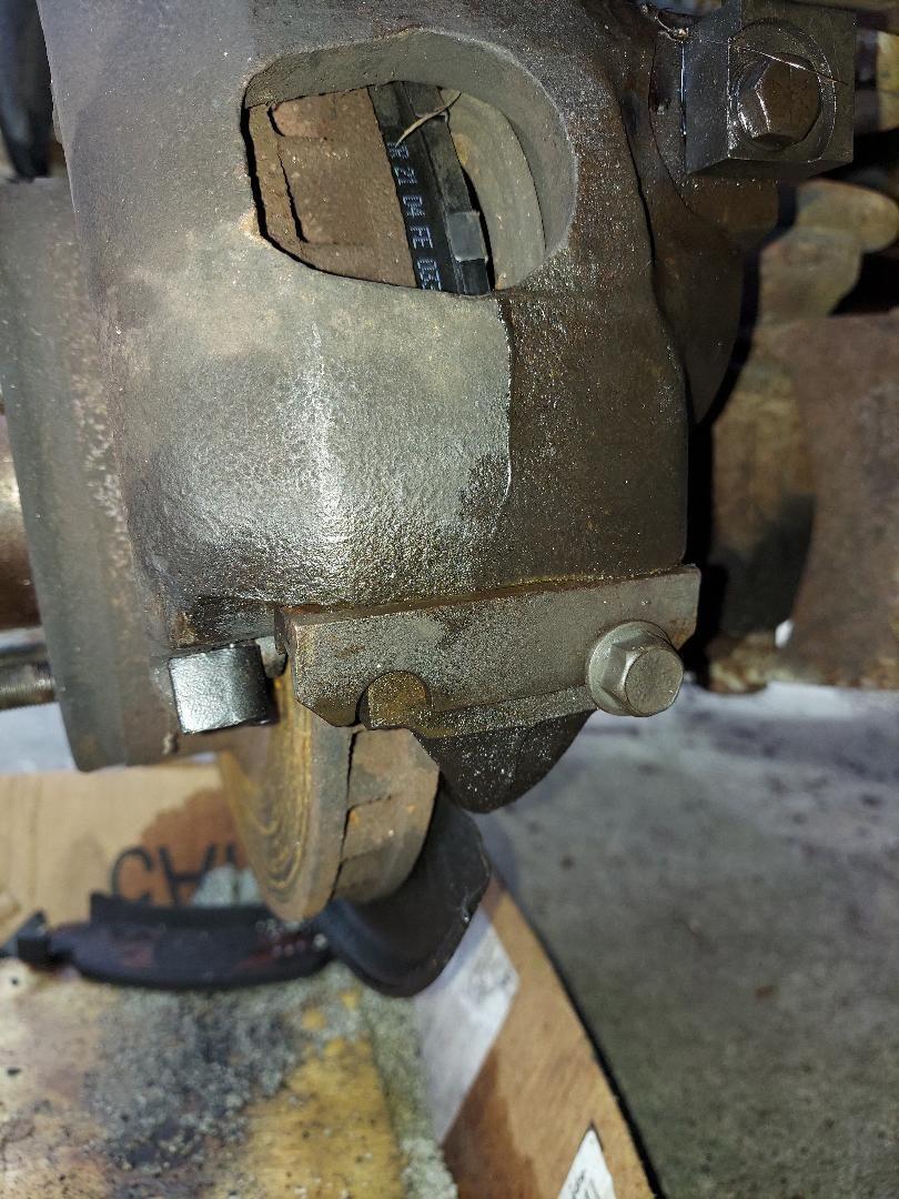

Can you get us pictures of that left front caliper ?

Pics Driver Side

That locking bolt is different from the diamond shaped ones I have on my 86' but it looks like they are doing the job.
I'm sure others will chime in soon.
May be that caliper is from a different year...? Have you asked the guy at the auto parts store ?

That arched piece is a spring to take up the slop between the bracket and the caliper. If you get a clunking noise while driving, that is probably from the side that is missing and would be the caliper clunking in the bracket.
