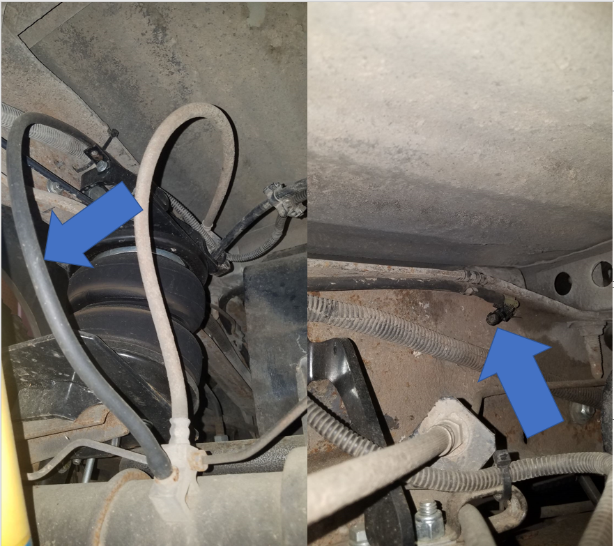

As WIlliamg4x4 mentioned, check the vent hose and vent port. You can remove the vent pot and clean/clear it if it is blocked. I put metal window screen around the end of my hoses tied on with zip ties. I also installed new, fresh and fiber reinforced hoses on the front and rear different vents. See the screen and hoses in the image below pointed out by blue arrows.
As for the differential, the additive you "might" need is Motorcraft XL-3. Although, some synthetic fluids have additive in them.
As for finding out your differential type other than the method above, you can check the door sticker or see if there is a tag on one of the differential bolts.
If you are doing the rebuild or reseal yourself, there are documents in the 7.3L PSD Tech Folder pertaining to a rebuild of the differential. Many of us have the Ford Service Manual on tap as well in case you just wanted to replace the seal, if you need to after the vent hose is checked. I replaced my seal about 6 years ago as it was leaking slightly.
Let us know how you would like to proceed sir and we will get you the documentation, advice or links you need to be successful.
I have already ordered the seal , and 75/140 waiting for me at napa, being as i am not making it home till 8 pm or so have not really had time to look at things , just watching atm
hoping to be able to deal with it over the weekend
