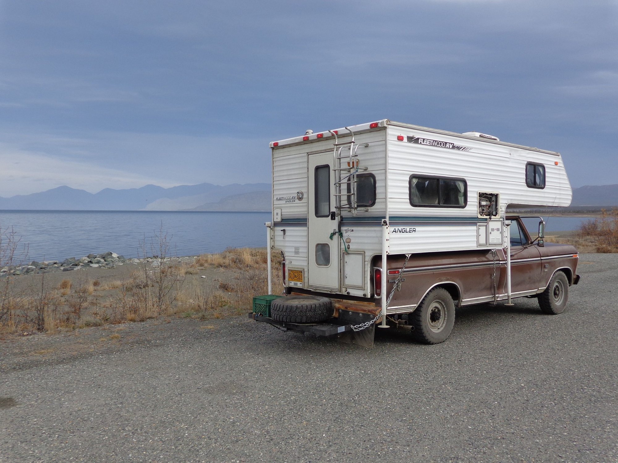

I eliminated my under bed hardware as I purchased one of those custom rack carriers that mounts to the tow hitch and custom mounted the tire while fabricating it for much easier access to the spare tire, as you all can see my dilemma when venturing with the camper -
Last thing I wanna do is wrestle with some 50 lb tire underneath the bed of my truck with a heavy loaded camper dealing with potential wet or saturated ground, fighting loose dirt, very low clearance, rusty hardware despite anti seize or lithium greasing it, etc.
Plus, I have immediate access to the diff plug when I need to check oil level or condition without some tire in the way while potentially barely rubbing against the sway bar or diff housing......This is the only way to go for my camper rig upon carrying a spare tire !

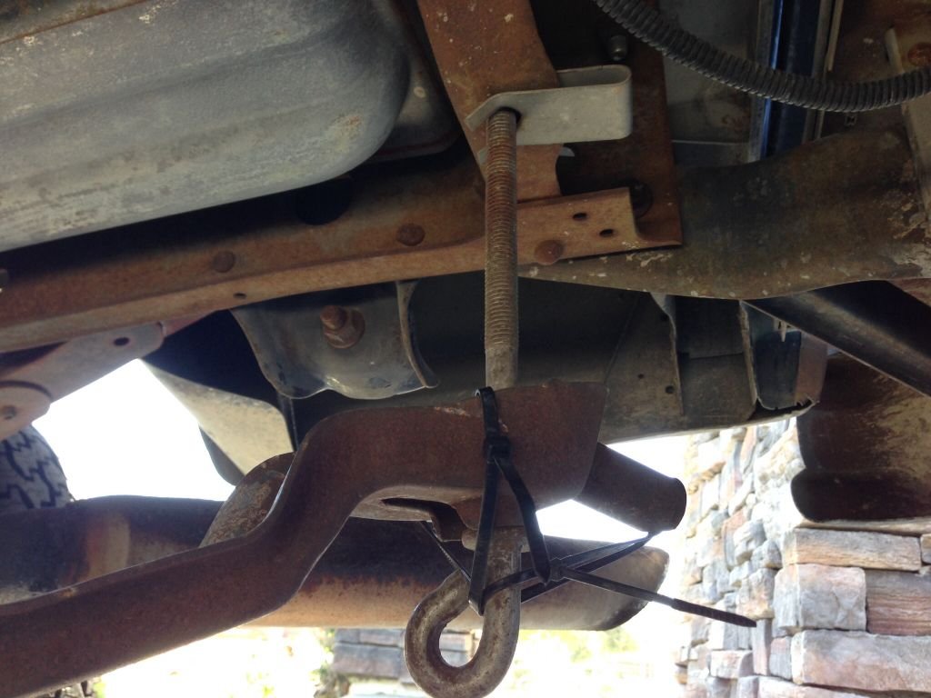

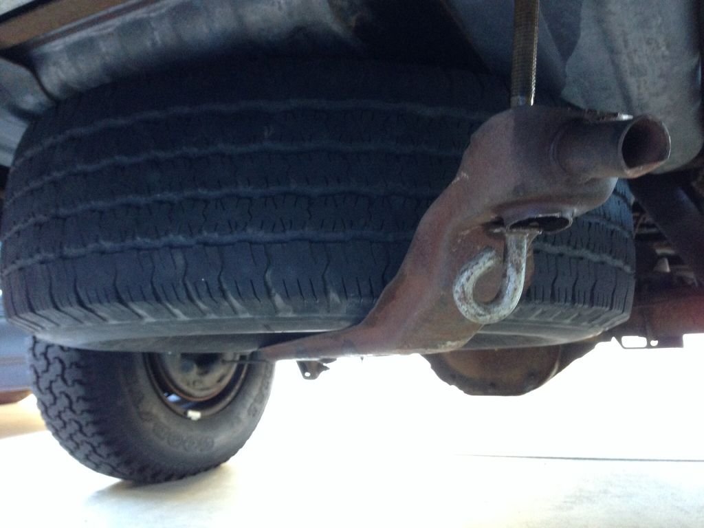

Like talked about use the OEM (straight +45*) tire iron and loosen the J bolt eye loop looking bolt up a bit. It should be on the very back part and on the bottom of the support bracket. Do not to loosen it all the way until it comes undone. In fact if you do, it can drop the tire and bracket and smash ya good. So loosen it up like 5 complete turns. Then some brackets have a end place (piece of pipe like tubbing) to put the lug wrench in and give you more lifting power. It might NOT have a place...so keep reading.
Once it is loose, lift the lower bracket AND tire together (='s HEAVEY, so be ready) then see the key like slot and large washer on the end of the J bolt eye loop? While holding the weight up (you can use the jack here to help a bit). Then turn the loop and slide it over to the large hole (for the washer) to go thru the key like slot in the lower bracket. Then lower it all and again do NOT smash yourself.
The eyelet bolt that goes thru the "key" slot of the bracket.

Found some more and one with the place to put the lug wrench to get more lifting leverage. But I think that was a late 80's mid 90's idea. And some even have a slide out handle. Does this make sense with the J bolt and the key slot description?

Yes, It's coming back to me now. Good pics there. I think I gave mine away. I recalled a lock on one, but I don't see provision there for one, maybe it was the one on the boy's truck I was remembering? I think I done good just recalling what I did.

First design I've seen that still allows you full use of your p/U bed.
