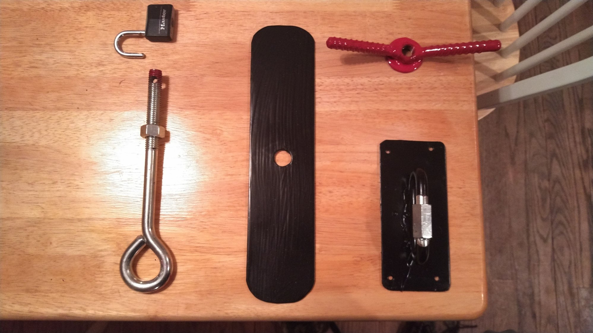

Originally Posted by hail destroyer
I like this setup. Does anyone sell this kit, or did you just make it?
Make me one if you will !

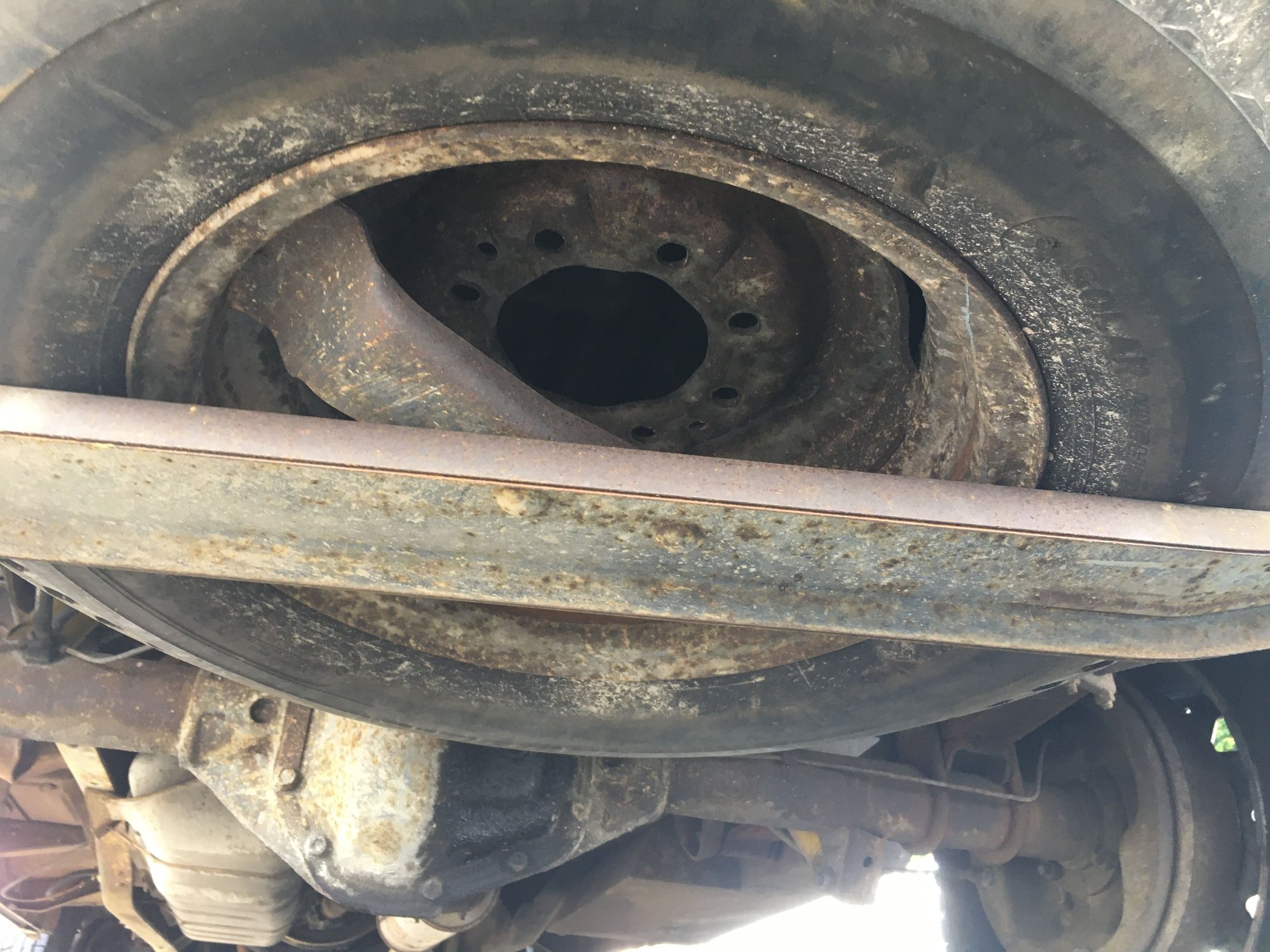

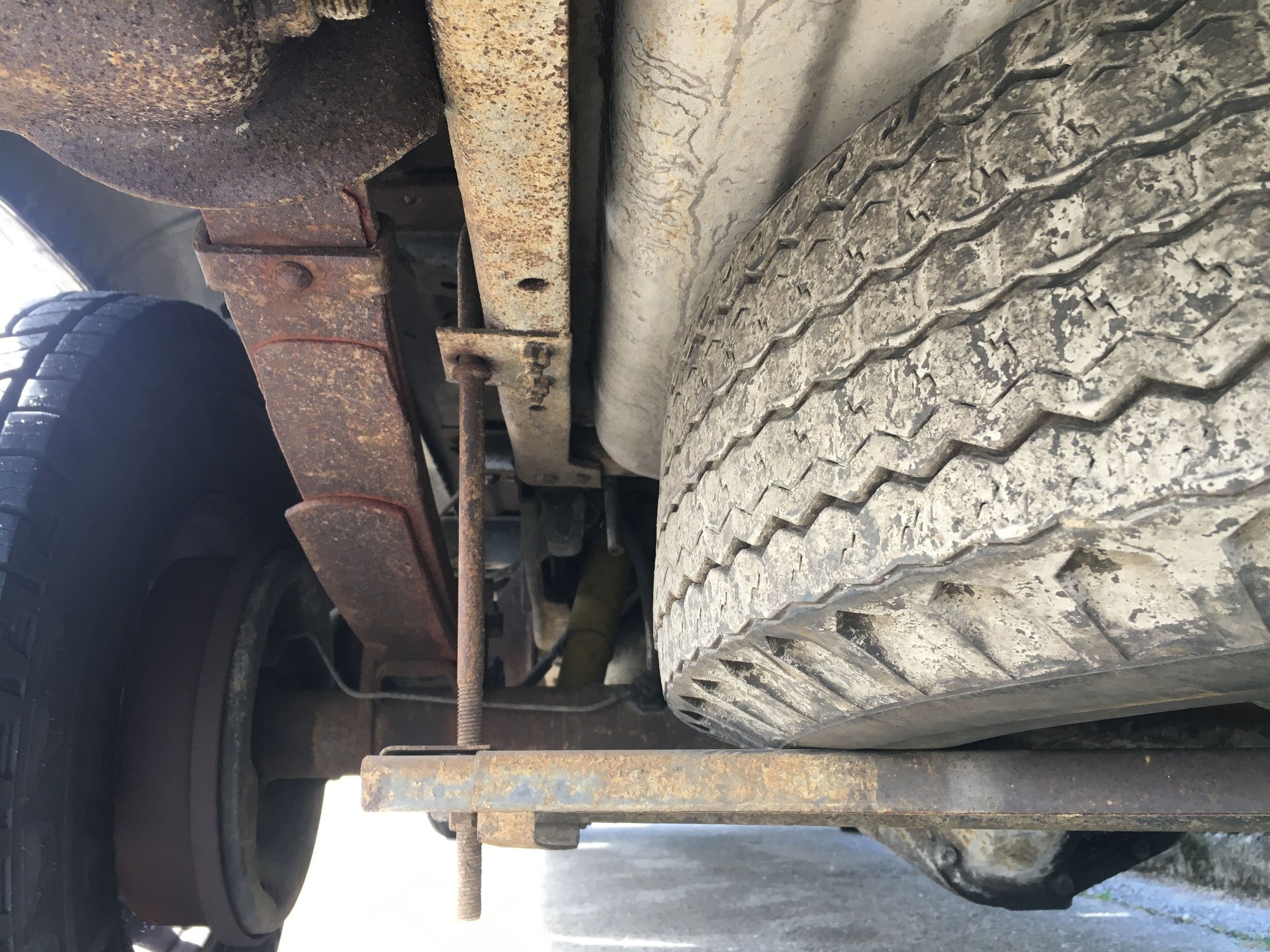

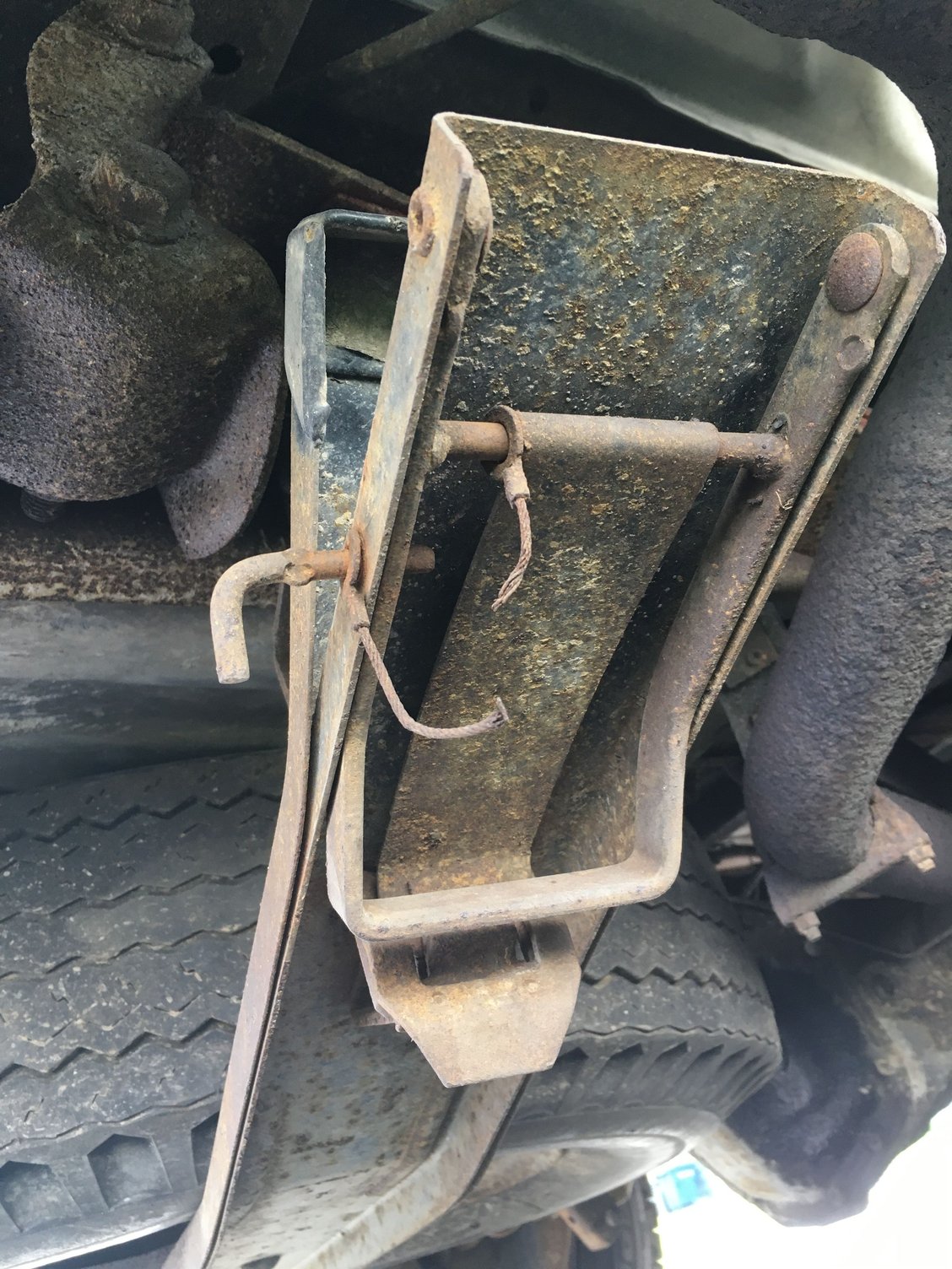

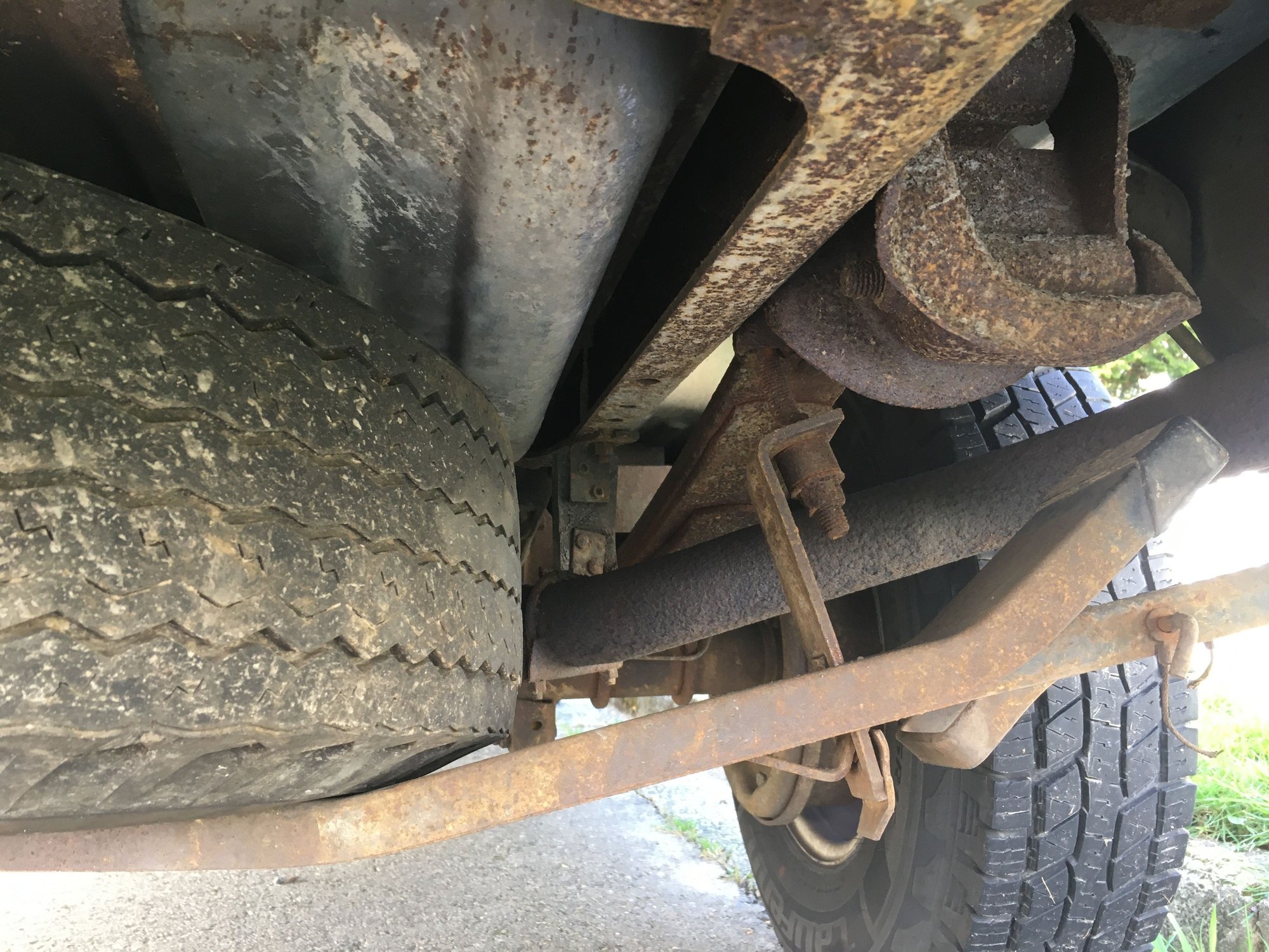

Some pics of the slide out carrier in the wild. As far as I know, everything you see is original, including the 16.5" split rim and what may be an original tire.
Michael
