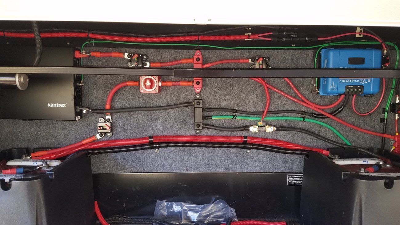

Just so we are clear, I used a 16 ton hydraulic crimper and appropriate sized lugs and dies when I created my additional battery cables. This was roughly the same time I installed a complete solar power system on my 5th wheel where I used hundreds of feet of cable and dozens of lugs of various sizes.

Sous, you mentioning your RV solar set up reminds me I've been meaning to ask if you did a write up on that and if you have a link to it, or a title I might find it under?
I'm sorry sir, I do not have a link or write up. I can share some of the details with you via email if you want to PM me your email address. If you have some questions or would like to speak about them or my methods of installing the solar equipment, I wouldn't mind talking to you on the phone about them. Sometimes it is easier to have a 2 way conversation regarding questions and methods than shooting emails back and forth.
When working on the charging/12v system of the truck or an RV or any other large power consumption system, there are certain considerations that should be taken.
A charging or 12v solar power system is only as good as the weakest link. If that link is a shoddy connection, the circuit and possible the entire electrical system will not be as efficient as it could be. I used a simple tool called a "multimeter" set on ohms/resistance to ensure each cable was up to the task of being as efficient as possible. Just as I did with my positive and negative cables I installed on the truck. On the truck, I was lucky... I was able to use my existing OEM cables after testing them (ohm/resistance) from connector to connector. I simply doubled up the links with high quality parts and now the batteries work as one big battery. The alternator and both batteries exactly the same voltage down to the hundredths, as it was designed by Ford engineers.

Having an inefficient charging/12v system in the truck is a bad idea. It only creates heat and leads to failures at a very inopportune time.
Just like an efficient solar system on an RV. Why spend $$$ on equipment and cabling and then truncate the efficiency with poor connections at the panels, charge controller or bus bars. It doesn't make any sense...
@JSPEX , I look forward to discussing your options going forward offline and perhaps you can teach me a thing or two. I was recently discussing a very specific MPPT all in one charge controller with another FTE'r and he taught me something I was unaware of.
