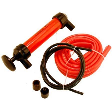

Sounds like the DEF tank has some contaminates in it. I would drain the tank, fill it with a gallon, take it for a drive on rough road, drain the tank again. I would repeat this a couple times and then fill the tank with some fresh DEF.
Th code is reset if the next drive cycle does not indicate a problem. It is tested once per drive cycle.
You can get a pump from Harbor Freight or wal mart or you part stores to drain the tank.
This would be a lot cheaper than having a shop to repair it. If the problem persits, then maybe consider taking it some place to repair it.
